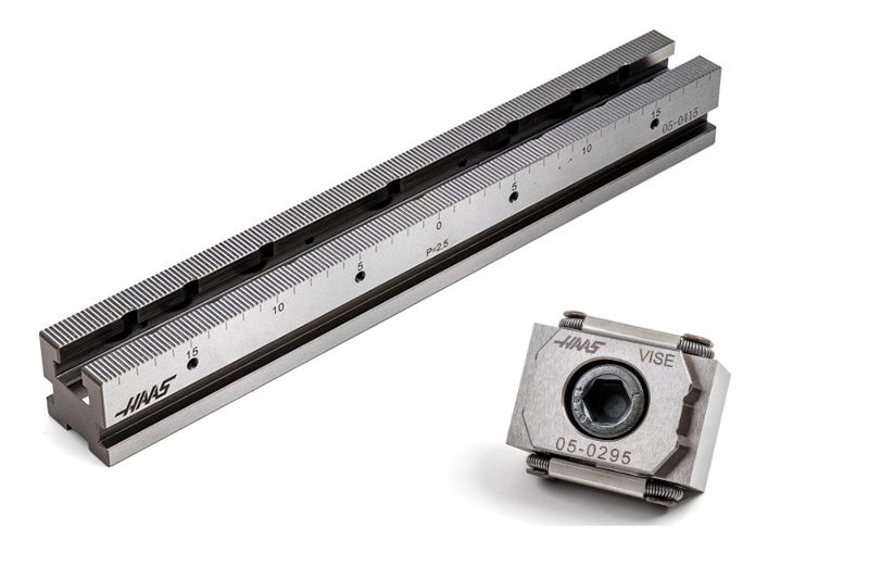

Rail Fixtures & Kits
____________________________
Rail Fixtures are a very versatile way to clamp your workpieces for machining. These fixtures can be quickly reconfigured for multiple applications and workpieces to best suit your shop’s needs!
Features
  • Suitable for multiple workpieces
  • High clamp force
  • Quick and easy set up
  • Available in 400, 500, and 600mm lengths
Using Rail Fixtures with Low-Profile Spring Clamps and Stops
1. Cap Screw | 2. Low-Profile Spring Clamp | 3. Base Plate | 4. T-Nut | 5. Rail Fixture
Workpiece Rail Stop
1. Cap Screw | 2. Rail Stop | 3. Rail Stop T-nut | 4. Rail Fixture
What Type of Parts Can I Hold Using Rail Fixtures?
Square/Rectangular Parts
Using the flat, serrated, or hole low-profile spring clamps, square stock can be held by having the clamp act as a wedge, clamping the workpiece against the rail stop.
Round/Custom Parts
Using the hole low-profile spring clamp and the rail soft Jaws, round and custom parts can be clamped, when soft jaws are machined to match your workpiece.
