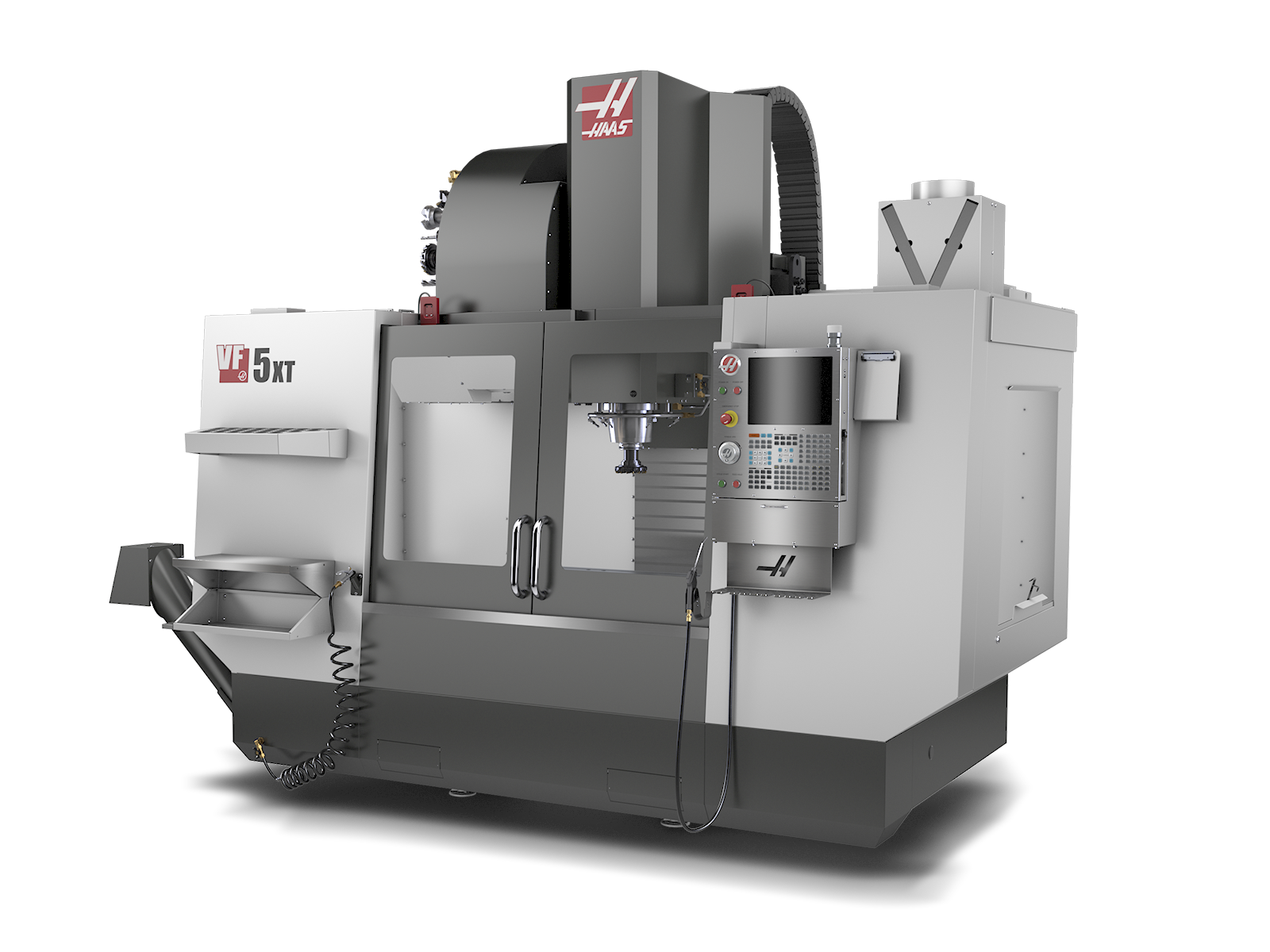

VF-5/50XT
Your browser doesn't support HTML5 video. Your browser doesn't support HTML5 video.
VF-5/50XT
    CNY ONLY
Вертикальный фрезерный станок с ЧПУ и ходом 1524 х 660 х 635 мм
  • 50 Taper
  • 3 Axis
  • 7.5k RPM

Travels S.A.E METRIC
X Axis 60.0 in 1524 mm
Y Axis 26.0 in 660 mm
Z Axis 25.0 in 635 mm
Spindle Nose to Table (~ max) 32.9 in 836 mm
Spindle Nose to Table (~ min) 7.9 in 201 mm
Spindle S.A.E METRIC
Max Rating 30.0 hp 22.4 kW
Max Speed 7500 rpm 7500 rpm
Max Torque 340.0 ft-lbf @ 700 rpm 460.0 Nm @ 700 rpm
Drive System 2-Speed Gearbox 2-Speed Gearbox
Taper CT or BT 50 CT or BT 50
Table S.A.E METRIC
Length 62.0 in 1575 mm
Width 23.0 in 584 mm
T-Slot Width 0.626 in to 0.630 in 15.90 mm to 16.00 mm
T-Slot Center Distance 3.15 in 80 mm
Number of Std T-Slots 7 7
Max Weight on Table (evenly distributed) 4000 lb 1814 kg
Feedrates S.A.E METRIC
Max Cutting 500 ipm 12.7 m/min
Rapids on X 710 ipm 18.0 m/min
Rapids on Y 710 ipm 18.0 m/min
Rapids on Z 710 ipm 18.0 m/min
Axis Motors S.A.E METRIC
Max Thrust X 3400 lbf 15124 N
Max Thrust Y 4100 lbf 18238 N
Max Thrust Z 5600 lbf 24910 N
Tool Changer S.A.E METRIC
Type SMTC SMTC
Capacity 30+1 30+1
Max Tool Diameter (full) 4.0 in 102 mm
Max Tool Diameter (adjacent empty) 7.0 in 178 mm
Max Tool Length (from gage line) 16 in 406 mm
Max Tool Weight 30 lb 13.6 kg
Tool-to-Tool (avg) 4.2 s 4.2 s
Chip-to-Chip (avg) 6.3 s 6.3 s
General S.A.E METRIC
Coolant Capacity 95 gal 360 L
Air Requirements S.A.E METRIC
Air Required 4 scfm @ 100 psi 113 L/min @ 6.9 bar
Inline Air Hose 3/8 in 3/8 in
Coupler (Air) 3/8 in 3/8 in
Domestic Pallet 168 in x 102 in x 125 in 427 cm x 260 cm x 318 cm
Export Crate 168 in x 102 in x 130 in 427 cm x 260 cm x 331 cm
Weight 16250 lb 7371.0 kg
Spindle Speed 7500 rpm 7500 rpm
Spindle Power 30.0 hp 22.4 kW
Full Load Amps (3 Phase) - Low 70 A 70 A
