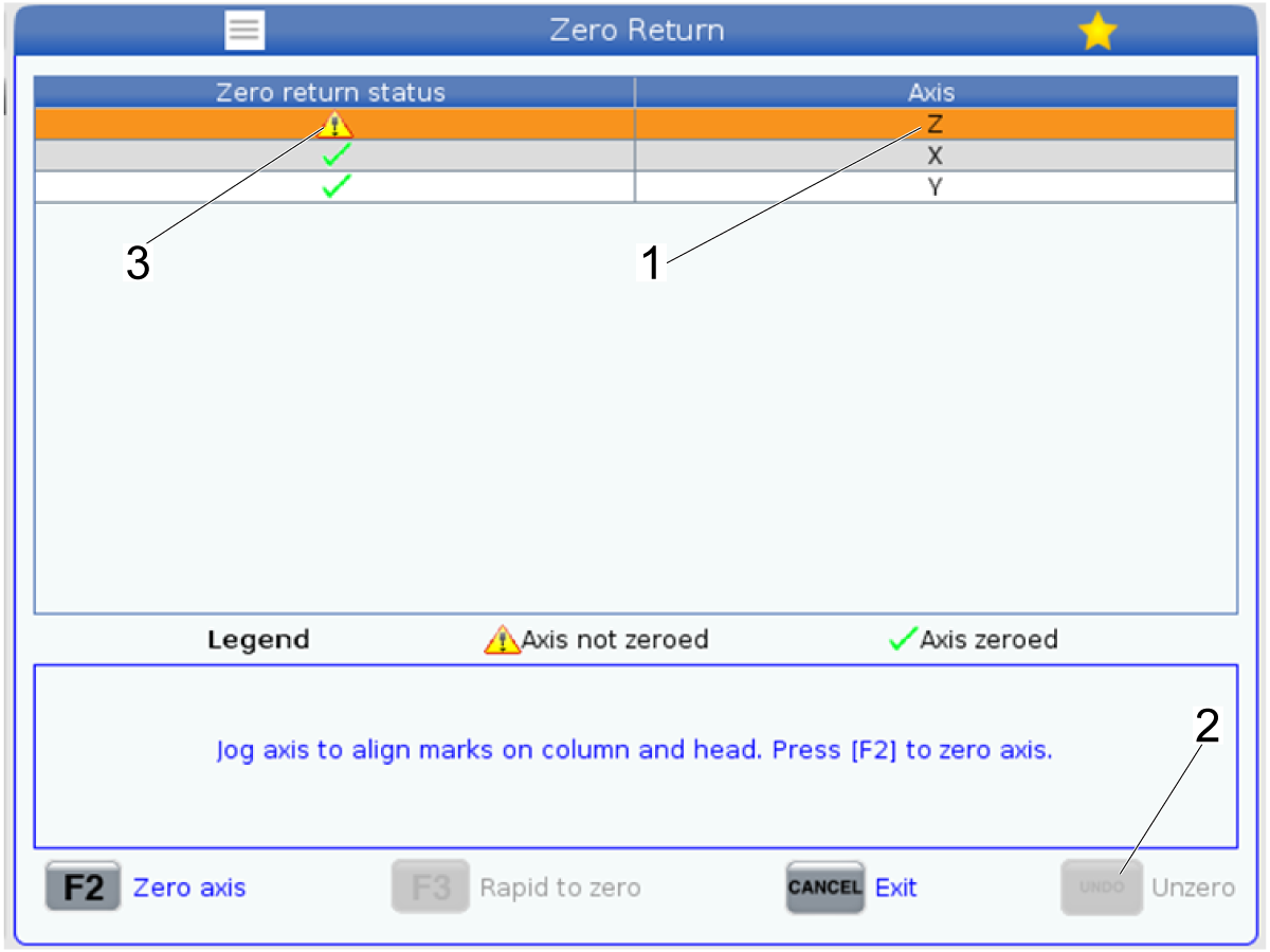

The DC series machines do not need to be zero returned like other Haas machines. These machines are aware of their positioning even when the machine is just being powered on because the motors have absolute encoders.
The zero position for the Z-axis and the Tool Turret (TT) axis can be set by the operator. That process can be done through tool changer recovery. Refer to section 5.3 DC-Series Tool Changer Recovery for instructions on going through recovery.
When the machine gets alarm 2066 (Tool Changer Home Position Fault) you will need to set the zero position for the machine. See section 5.3 DC-Series - Tool Changer Recovery for help on how to recover the tool changer on a DC series machines.
If all the axes have a zero position set, you can move the X, Y, and Z axes to their home position. On the Haas control pendent, use the following command to bring of the zero return page shown in the image:
[Z]+[zero return]+[single].
Inside the window you can set the zero for each axis independently by highlighting the axis and pressing [F2] [1].
Warning: Pressing [F2] with the Z-axis highlighted will set the zero position at the current position.
To move an axis to the current zero position, press [F3] [5] to send the axis home at the selected rapid.
You can also unzero an axis by highlighting the axis and pressing [UNDO] [2].
Note: The [UNDO] option is only visible with a service key.
The green check mark [3] in the Zero Return Status window indicates that the axis has been zeroed. A yellow caution icon [4] indicates that the axis is not zeroed.

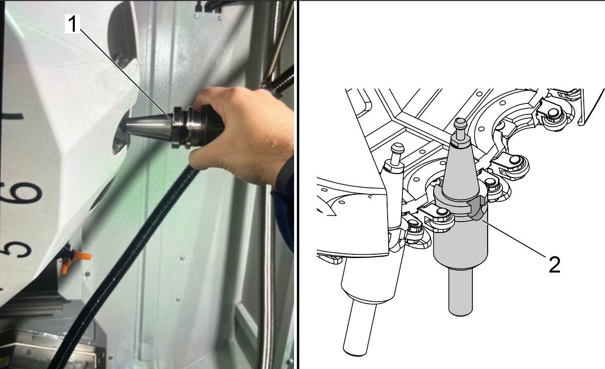

To load tools, Press P{pocket_number}  to select what tool pocket you want to load the tool into. Then press [ATC FWD] on the control pendant to have the tool carousel change pocket positions.
Tools can only be loaded into the side pocket as shown in the image [1]. Calling the P command in a program will bring the specified pocket to the side.
Example: Calling P6, then ATC FWD will bring pocket 6 to the side as shown in the image.
When loading tools into the side pocket, make sure the tools are oriented with the cutout [1] facing the front of the tool carousel. This orientation allows the tool to be loaded correctly into the spindle
NOTE: The correct tool orientation is shown in image [2]
Tools can only be loaded into the right side pocket [1]. This pocket has room to slide tools into position. Once you orient the tool, lock it into the pocket by pulling it towards the front door

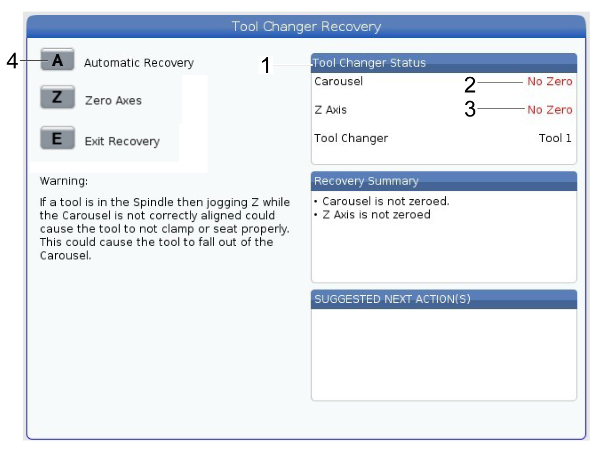

  • Both the Z-axis and the Tool Carousel are not zeroed.
Important: There is also information detailing how and when to use the Zero Axes option in the Tool Changer Recovery page. Refer to the Zero Axes section below.
This document walks through each of these scenarios. Skip to the section that applies to your case.

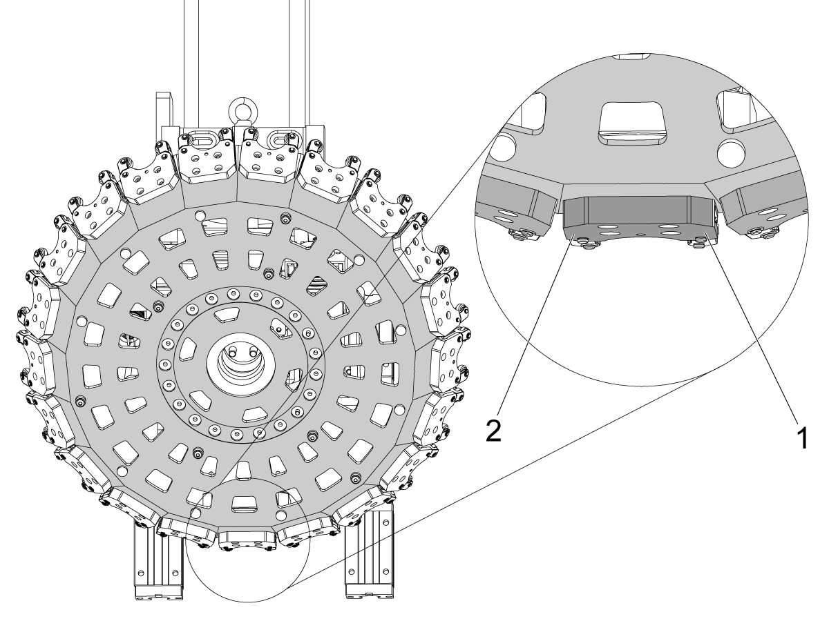

  1. Do not rotate the carousel with the Z-axis at it's zero position (where the arrow decals align). Instead make sure the Z-axis is 6.5" (165 mm) below the zero position, or at the top of the Z-axis travel where there is room for tool holders to fit under the spindle.
  2. After doing Tool Changer Recovery, make sure that the tool pocket aligned with the spindle is the same that is listed on the control. For instance if the Tool Changer Status window in the recovery page shows Tool Changer - Tool 5 instead of Tool 1, follow the instructions below but substitute Pocket 5 anywhere Pocket 1 is mentioned.
  3. The spindle might not orient to it' s tool change position when you enter recovery. It is recommended to orient the spindle before and after doing Tool Change Recovery.
  4. During recovery, whenever an axis needs to be zeroed, you must press [Zero Return] before pressing [F3]. Similarly, when jogging an axis you must press [Handle Jog] before selecting the axis.
Warning: If you need to jog the carousel (TT-axis) while tools are in the carousel, move the Z-axis down at least 6.5" (165mm) below the Z-axis zero position. This will ensure that tool holders do not hit the spindle head when rotating the TT-axis. If there is a tool in the spindle, place something under the spindle to catch a tool in case it is dropped in the process of jogging the Z-axis.

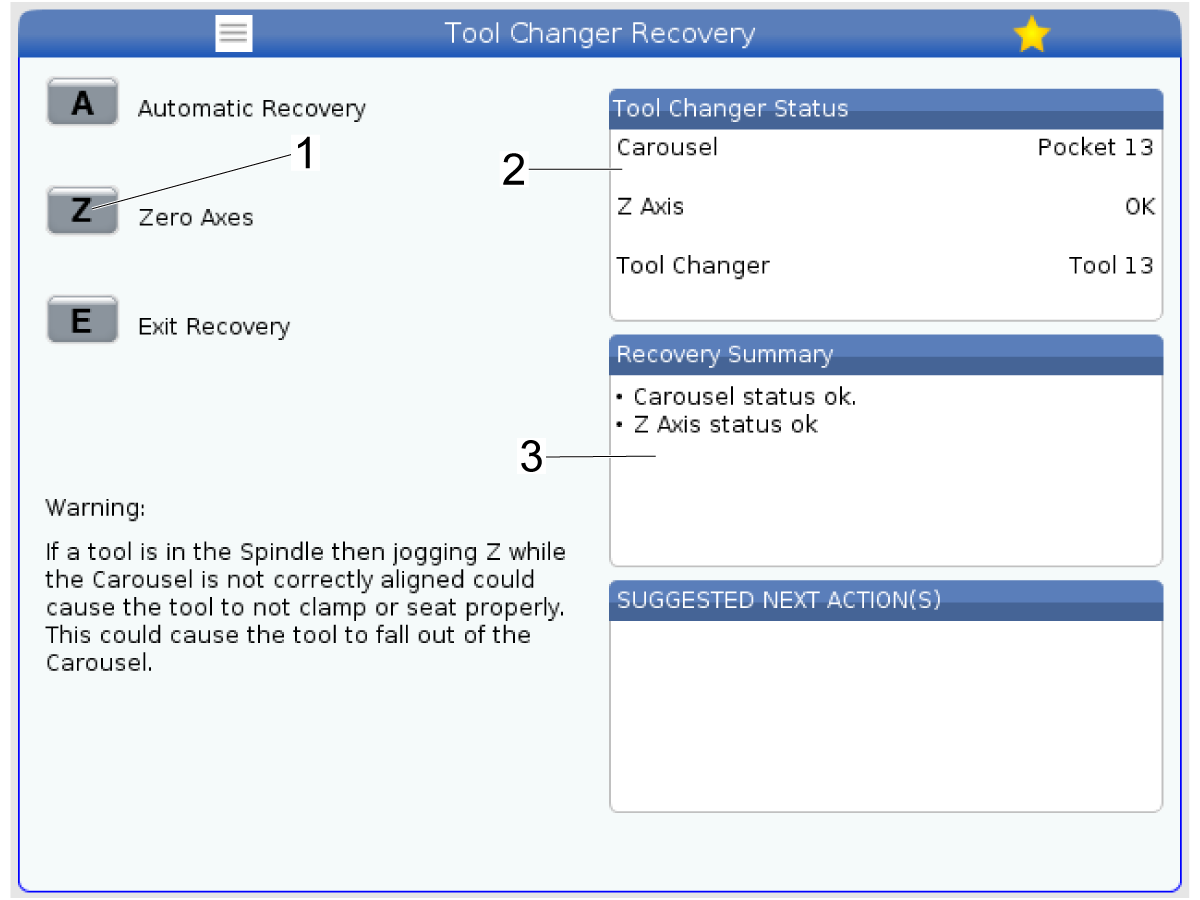

Zero Axes
The Zero Axes page should be used if the zero position was incidentally set in the wrong position when the machine was going through recovery.
This allows you to change the zero position even though the "Tool Changer Status" window [2] and the "Recovery Summary" [3] are in a good state as shown in the image below.
Note: The Zero Axes option also allows for the zero position of an axis to be changed without a service key. That way customers can recover a machine even if they set the zero position for an axis incorrectly the first time.

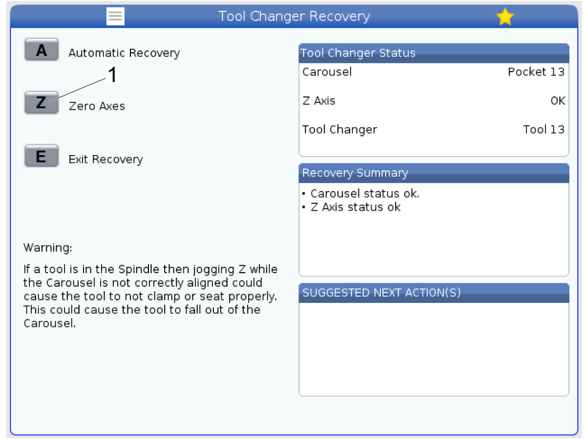

When you first press [Recovery] you can choose [A] for automatic recovery, or [Z] for zero axes [1]. This section will show navigating the zero axes option.
The zero axes option allows to you to change the the zero position for the TT-axis and the Z-axis.
Note: You don't change any offset values in this process, it allows to select a new zero position using the existing offset values.
After pressing [Z] to change the zero position for either the TT-axis or Z-axis, you will see the screen shown in the image.
Note: When you press [Z] there will be no motion from any of the axes, this button does not move either of the axes to their current zero position.

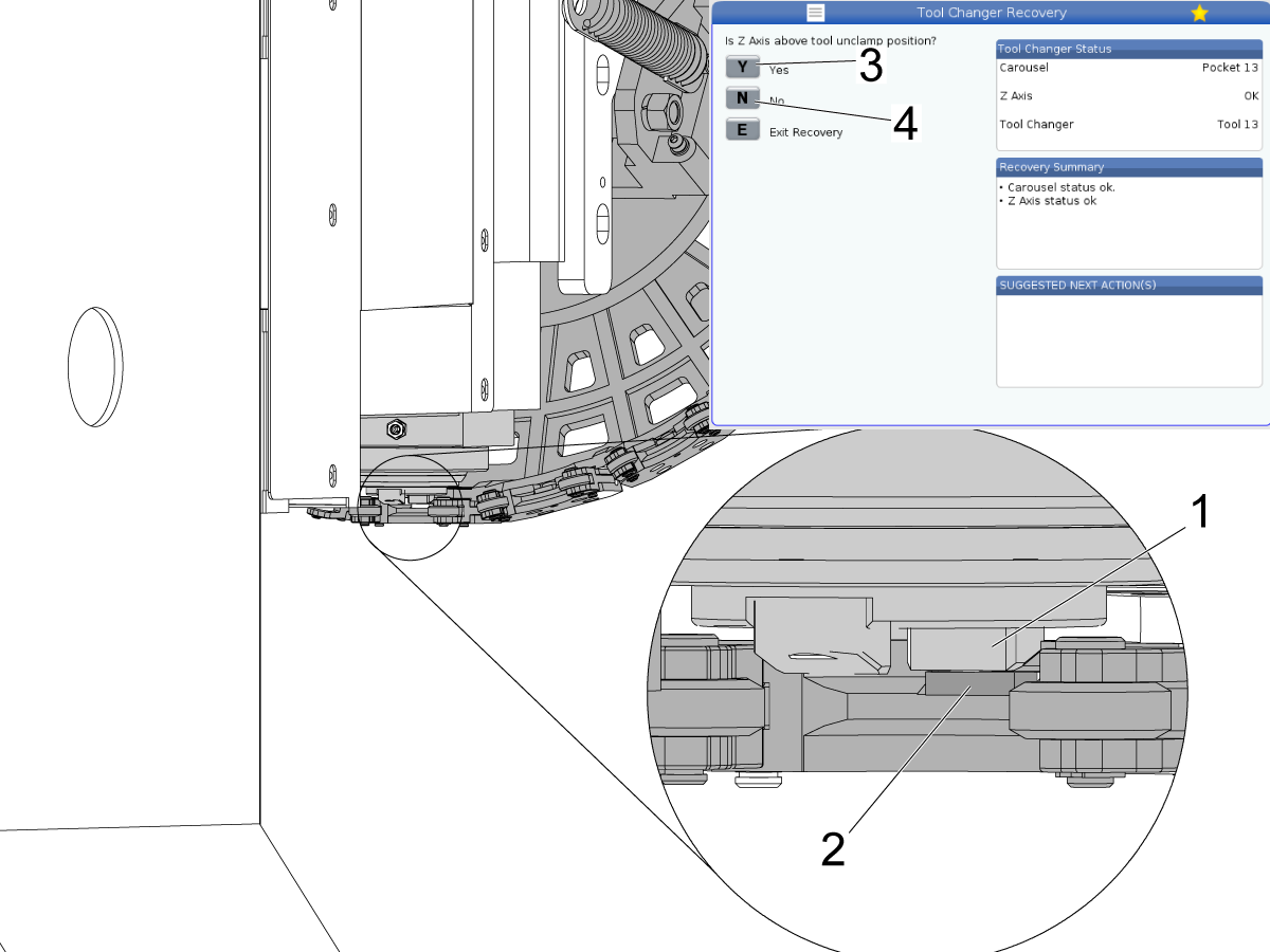

Answer the question [Y] [1] or [N] [2] depending on if there are any tools present in the carousel or the spindle.
Note: You can also exit the Zero Axes section by pressing [E] [3] if you think it isn't needed to change the zero, or if you want to change back to Automatic Recovery.

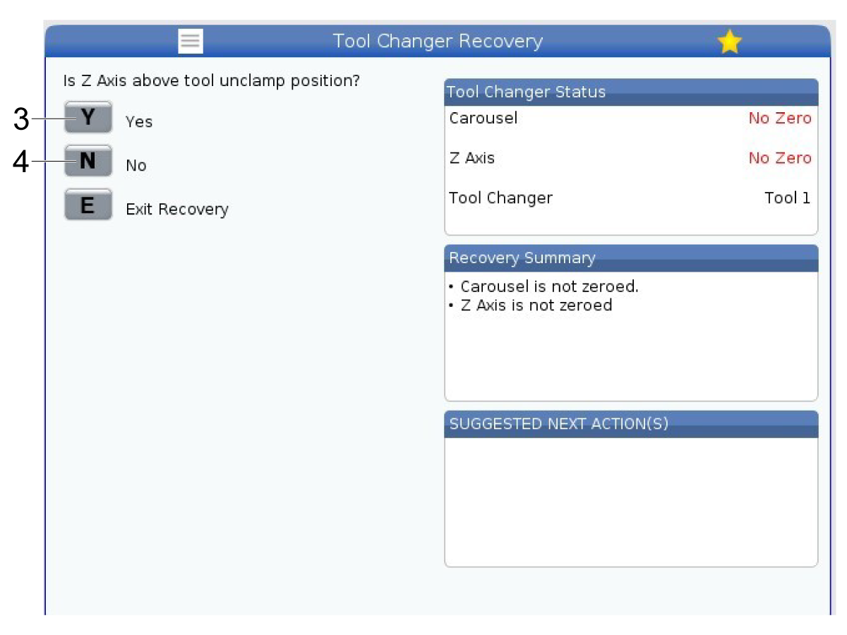

If you answered [Y] to there being tools in the carousel or spindle, then you will be asked whether the Z-axis is above the tool unclamp position.
The tool unclamp position is above the Z-axis zero position and is essentially where the spindle dogs [1] are about to make contact the slot in the tool pocket [2].
Note: If there is a tool clamped in the spindle then your Z-axis is below the tool unclamp position. You cannot have a tool in the spindle and be above the tool unclamp.
Answer the question [Y] [3] or [N] [4] depending on your Z-axis position.
Only if Z-axis is at or above unclamp position:
If you were above the unclamp position and answered [Y] then you will have to jog the Z-axis up high enough so that the spindle clears the pullstuds [1] of the tools in other pockets.
Once the Z-axis is high enough press [C] to continue to the next step of setting the zero positions.
Only if Z-axis is below unclamp position:
If you were below the unclamp position and answered [N] then you will have to jog the Z-axis down from the zero position at least 6.5" so that the spindle head clears the pull studs of the tools in other pockets.
Note: The zero position is roughly above where the arrow on the left [1] is aligned with the arrow on the right [2].
Once the Z-axis is low enough press [C] to continue to the next step of setting the zero positions.

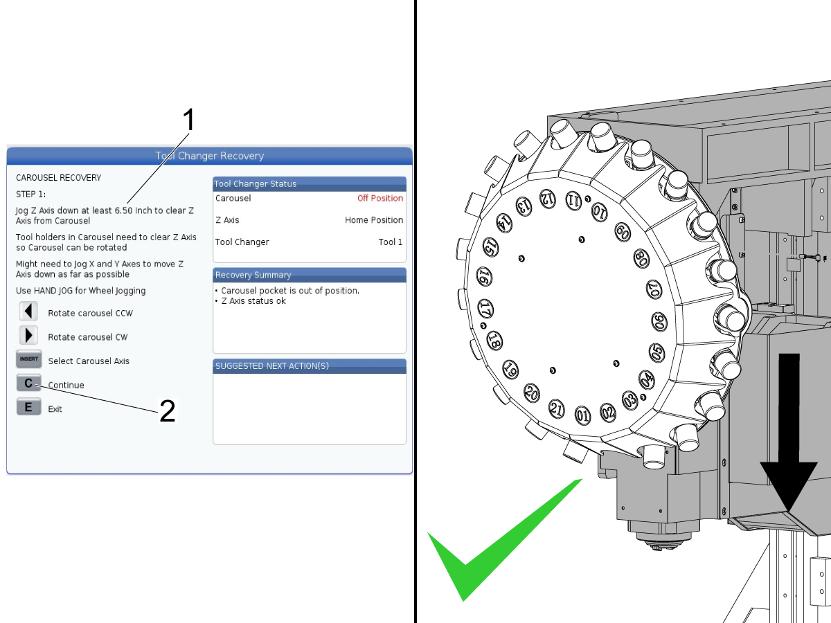

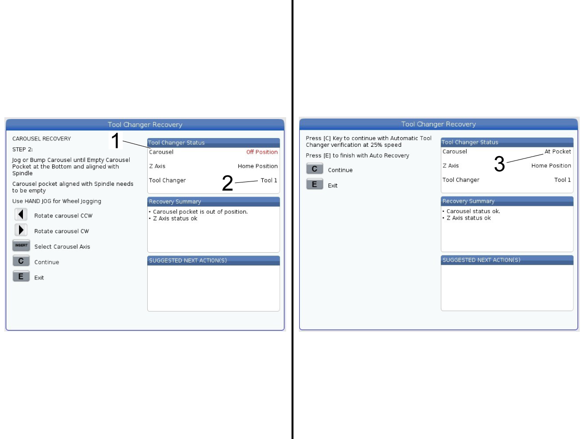

Press the [Recover] button on the Haas Control to enter Tool Changer Recovery.
The Tool Changer Status window [1] shows the current condition of the Z-axis and Tool Carousel.
In this scenario, the status window has:
  • Carousel - Off Position [2]
  • Z-axis -  Home Position [3]
  • Tool Changer - Tool 1 [4]
Press [A] [5] for Automatic Recovery.
The next window will ask if you have any tool in the spindle or in the carousel.
Important: Selecting No [N] [2] at this point will result in the machine doing an automatic tool change to recover. This may result in a dropped tool or a crash if there are tools in the spindle or carousel. Only select [N] if you want the machine to automatically do a tool change.
Answer the question either pressing Yes [Y] [1] or No [N] [2].
Follow the instructions on the screen.

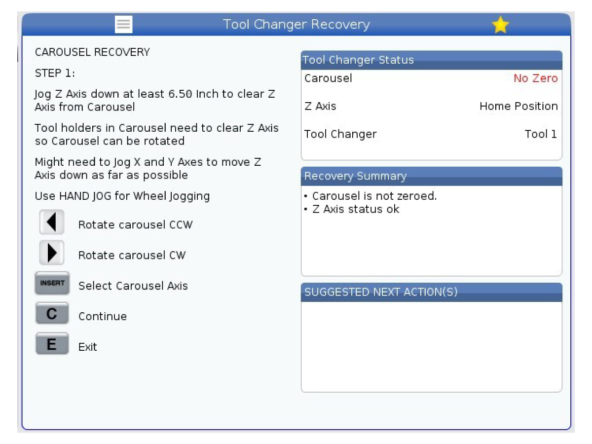

The Z-axis needs to be at least 6.5" (165mm) [1] below the Z-axis zero position which is where the arrows on the right side of the spindle head and enclosure are aligned.
Note: If the Z-axis isn't moved down, then tool holders will hit the spindle head when the carousel is rotated. This could damage the pocket fingers holding the tools.
To jog the Z-axis make sure to press [Handle Jog] and then select the Z-axis. Jog it down so that the carousel can be rotated without risk of collision.
The image shows a safe position for the Z-axis to start jogging the TT-axis.
Press [C] [2] to Continue to the next step once the Z-axis is jogged down.
Next the tool carousel (TT-axis) needs to be jogged so that the pocket that shows in the Tool changer Status window [1] for the Tool Changer - {Tool}.
In the image shown, the Tool Changer is showing Tool 1 [2] so that means that pocket 1 needs to be used to align with the spindle. If it showed Tool 7, then you would use pocket 7 to align with the spindle.
To jog the carousel you can press [TT]+[Handle Jog] or use the arrow keys to rotate the carousel.

Jog the TT-axis until the Tool Changer Status [1] reads:
  • Carousel - At Pocket [3]
Press [C] to continue only when it reads "At Pocket". If it reads "Pocket #" or "Moving" then the carousel needs to still be jogged.
After you press Continue [C] the Tool Changer Recovery window will ask if you want to verify with a tool change at 25%.

Tool Carousel is Not Zeroed and Z-axis is Zeroed
In this scenario the Tool Changer Recovery Page will look like the image. The Tool Changer Status window [1] will show:
  • Carousel - No Zero [2]
Press [A] [3] to enter Automatic Recovery and then follow the remaining steps in this section.
Note: Make sure to read the warnings on the Recovery pages. Take precautions to protect against dropping tools if you aren't familiar with the process.

Tool in Spindle/Carousel and Z-axis is below Tool Unclamp Position [1]
  • Jog the Z-axis down 6.5" (165mm) below the Z-axis zero position [2]. The zero position is roughly where the decals on the spindle head and the back enclosure are aligned.
  • To get a tool out of the spindle, align an empty pocket with the spindle and slowly jog the Z-axis up. You have to jog the Z-axis above the zero position until the tool pocket fingers grab the tool from the spindle and the drawbar is released.
  • Remove the tool from the pocket once it is out of the spindle.
  • Align pocket 1 with the spindle and press Continue [C] and follow the next steps.

Both Z-axis and Tool Carousel Are Not Zeroed
In this scenario the Tool Changer Status window [1] will look like what's shown in the image:
  • Z-axis -  No Zero [3]
Press [A] [4] to enter Automatic Recovery and then follow the remaining steps in this section.
The next page in recovery will ask if there are any tools present in the spindle or the carousel.
If there are any tools press [Y] [1] for yes. Then continue to Step 3 in these instructions.
If there are no tools in the carousel or spindle, press [N] [2] for no. If you answer no skip to step 6 in these instructions.
Note: It is easier to go through recovery with no tools in the carousel. If there is no tool in the spindle then you can remove the back cover from the tool changer and manually pull all the tools out of the carousel. If there is a tool in the spindle then you must answer Yes.
Only if there is tools in the spindle/carousel
The recovery page will then ask "Is the Z-axis above the tool unclamp position?"
The left image shows what is meant as the tool unclamp position. The Z-axis is above the tool unclamp position when the spindle dog [1] is sitting in the tool pocket slot [2]. Answer [Y] [3] if you are at or above this position, and answer [N] [4] if you are not.
Note: The purpose of this question is to determine if you need to jog the Z-axis up or down to be at a safe location. You need the Z-axis to be at a safe location before you can jog the carousel (TT-axis).
Anything below the position shown is considered below the tool unclamp position.
Answer [Y] [3] if the z-axis is at or above the position shown in the left image. Answer [N] [4] if the Z-axis is at or below the position shown in the right image.
If you answered Yes, continue to step 4. If you answered No, then skip to step 5 in these instructions.

Only if Z-axis is Below Tool Unclamp Postion
Warning: Before jogging the the Z-axis down, make sure the pocket in line with the spindle is empty and that the pocket is roughly aligned. This will prevent the spindle dogs from colliding with the edges of a tool pocket. you can enter [TT]+[Handle Jog] to jog the carousel.
If you answered No to "Is the Z-axis above the tool unclamp position" the Z-axis needs to be jogged down 6.5" (165mm) from the zero position (where the arrow decals are aligned).
Note: 6.5" below the home position is is the safe position where the tool holders cannot hit the spindle head. If the Z-axis is not jogged down far enough there is a risk of collision when the carousel (TT-axis) is jogged.
The image shows the approximate safe position for the Z-axis. Jog down as far as needed to feel confident that the tool holders will not hit the spindle head.
Once the Z-axis is jogged low enough so that the carousel can be jogged without risk of collision, press [C] [2] to continue to the next step.

You can reset the zero position for the Z-axis and TT-axis directly through the recovery page.
When you first enter the recovery page you see a screen as shown in the image.
Press [Z] [1] to start the Zero Axes option. This will allow you to start the process of changing the zero position for either axis. Follow the Zero Axes section in the Tool Changer Recovery - 5.3 section in the manual.

You can force recovery on the DC-Series machines with a service key by doing the following:
  1. Press [Z]+[Zero Return]+[Single] and that will bring up the window shown in the image.
  2. Highlight the Z-axis [1] and press [Undo] [2] to unzero the Z-axis.
  3. Press [Recover] and try to reset the zero position again.
Note: The yellow caution icon [3] indicates that the axis does not have a zero position set. A green check mark indicates that the axis has a zero position.
When resetting the zero position this time, make sure to jog the Z-axis up so that the arrow on the spindle head is about 1/8-1/4" above the arrow on the enclosure as shown in the image.
Follow the steps in recovery for setting the Z-axis zero position.
Note: You can use either the Zero Axes option or Automatic recovery option. If you use Automatic recovery you do not need to change any alignment using [F4].

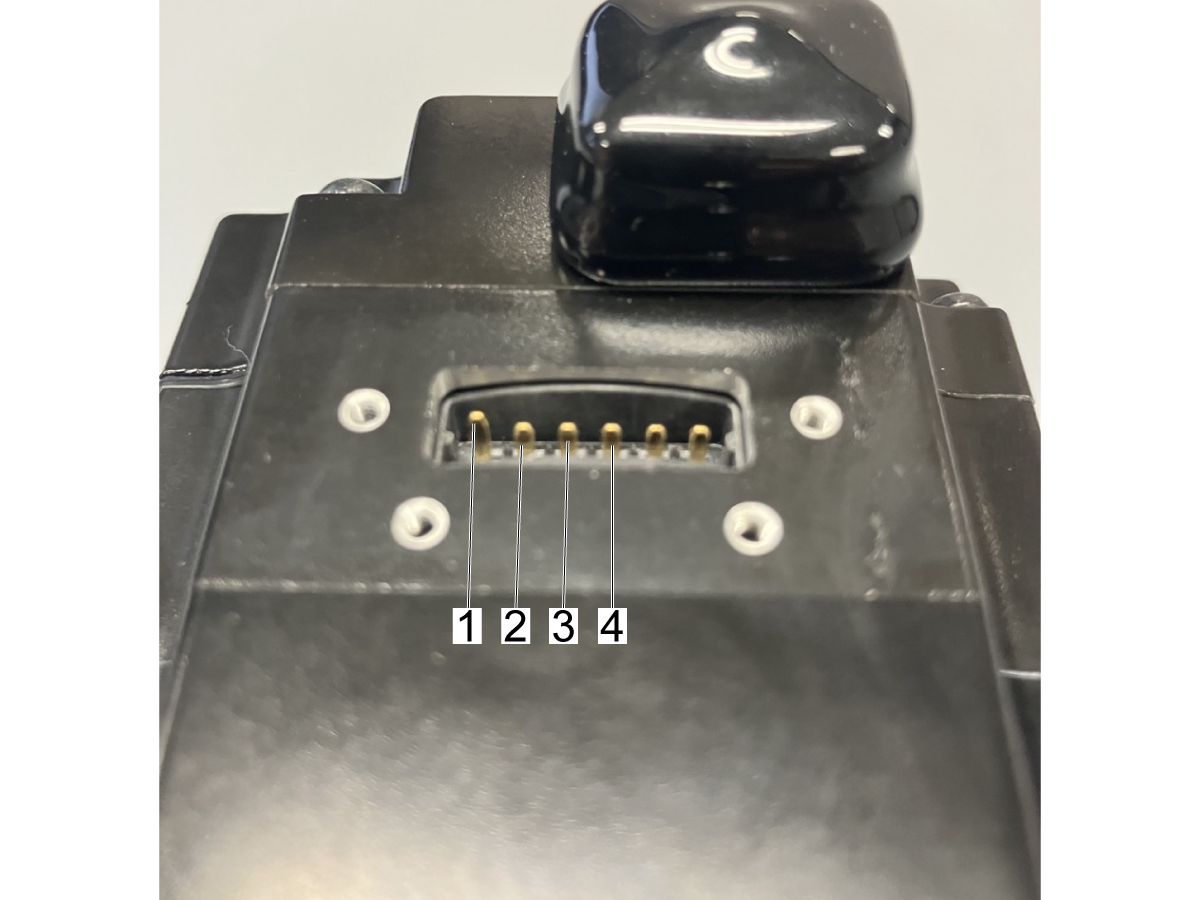

Tool Carousel Motor
DC-1/2 30 Taper Machines:
The DC-1 tool carousel motor is a sigma7 size 04 motor. The pinout for he phases looks different than other axis motors.
This image shows the pins on the motor connector:
  1. Gnd
  2. Phase A
  3. Phase B
  4. Phase C
NOTE: The Gnd pin [1] should be longer than the other pins as shown in the image.
Check the resistance between the phases. Resistance should be 4.2 Ohms between each phase.

Remove the front [1] and rear [2] covers of the tool carousel.
The front cover [1] is held in position by metric SHCS accessible from the front of the machine.
Note: When you remove the front cover make sure there is a mark on tool pocket 1 of the carousel. If there is not, mark the carousel [3] so you know how to orient the cover when it is reinstalled.
The rear cover is mounted by metric SHCS and the side windows of the machine may have to be removed to gain access to the screws.

Press [Current Commands] and navigate to the Mechanisms [1] page inside of the Devices window.
Search for Main Spindle [2] and then press [F1] to search for it.
Press [F2] [3] to move the spindle to it's orientation offset based on it's spindle orientation offset parameter (30.085). Refer to the Set Spindle Orientation Offset section for how to set this parameter.
Once all tools are removed from the spindle and carousel start by pressing the [Recover] button on the Haas control to enter into Tool Changer Recovery.
Press [A] [1] for Automatic Recovery.
When asked "Are there any tools present" answer [N] [2] since all tools were removed in the previous step.
Press [Handle Jog] and jog the Z-axis up high enough so that the spindle [1] is above the carousel [2].
At this point the carousel will be pulled fully underneath the spindle as shown in the image. The Z-axis is high enough when the carousel no longer moves as you jog the Z-axis up.
The bottom of the pocket will be flat [3] once the spindle is high enough.
Jog the TT-axis so that pocket 1 is under the spindle is sitting flat parallel to the X-axis of the machine [1].
Put the mag base on the table and bring the indicator up to the pocket under the spindle.
Jog the X-axis so that the indicator moves across the bottom of the pocket from the left side [2] to the right side [3].
If the indicator shows more than 0.0005" difference from the left side of the pocket to the right, then jog the carousel so that the pocket is sitting flat.
Once there is less than 0.0005" difference between the edges of the pocket you can move to the next step.
Jog the table away from the tool carousel so the indicator is clear of the tool carousel press the [Zero Return] button.
Press [F3] [1] to set the initial zero position for the TT-axis.
When you press [F3] the carousel should rotate clockwise a few degrees. The tool pocket will no longer be sitting parallel with the X-axis. This is expected.
Press [E] [2] twice to exit recovery.

Press [Z] [1] to go into the Zero Axes page.
Note: Use the Zero Axes option since we are just going to be jogging the Z-axis up and down. If you are not in recovery you cannot jog the Z-axis above it's zero position.
Answer the questions until you get to the Zero Carousel page that is shown in the image.

To start aligning the Z-axis, press the [Recover] button to enter recovery.
Press [A] for Automatic Recovery.
Answer the questions about tools in the carousel. Continue until you get to the window shown in the image.
Press [F2] [1] to switch to jog mode.
Jog the Z-axis so that the arrow decal on the spindle head [2] is aligned with the arrow decal on the back enclosure panel [3].
Once the arrows are aligned, press [F2] [1] to switch out of jog mode. Then press [F3] [4] to set the zero position.
Note: The Z-axis will drop down until it finds the Z-channel signal of the motor. That is expected behavior at this point in the alignment process..
Press [E] [5] twice to exit recovery.

When on the main Recovery menu, press [Z] [1] to start the Zero Axes process.
Note: This is so that you can jog the Z-axis in the positive direction passed the zero position that was just set in the previous step.
Answer the questions about tools in the carousel until you reach the screen for setting the Z-axis Zero position as shown in the image [2].
Press [F2] when on the page to switch to jog mode. Select the Z-axis for jogging.
Note: Look at the Machine Position for the Z-axis before you start jogging it. The position should be 0.000.
Jog the Z-axis up passed where the arrows align.
Continue jogging until the bottom of the carousel no longer moves backwards to get in line with the spindle [1].
Once the Z-axis is high enough and the carousel no longer moves in or out when jogging, position the indicator so that it is zeroed on the front face [2] of the pocket in line with the spindle.
Note: The indicator will be used to detect when the carousel starts to push forward as the Z-axis is jogged down. The carousel pushing forward is the same point where the draw bar releases the tool in spindle.
