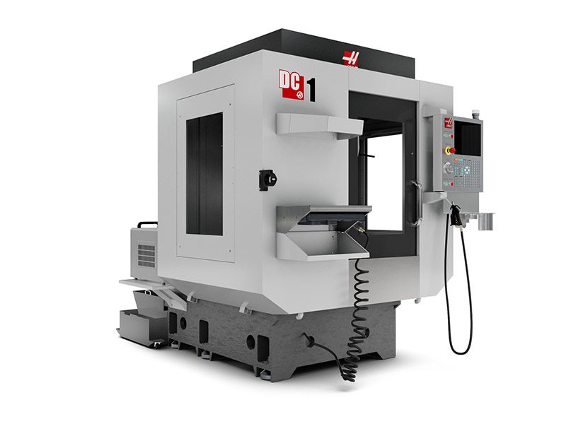

High-Speed Drill Center with 23.6" x 17.7" x 11.8" travels, 40 taper

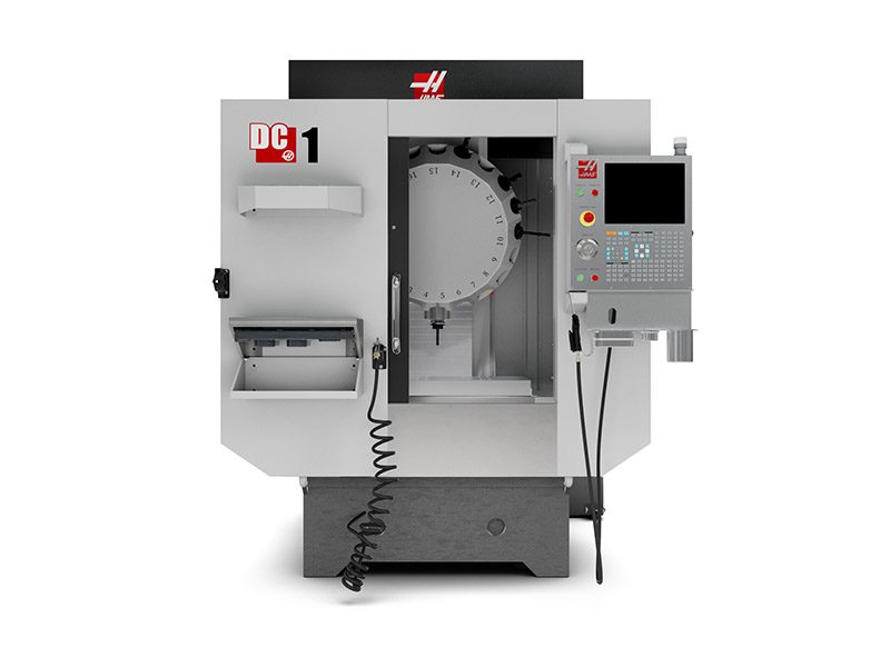

The DC-1/40 is a traditional-style drill/tap machine with a 10,000-rpm 40-taper spindle and high-speed turret-style tool changer to minimize cut-to-cut times and shorten cycle times. Choose the optional 12,000-rpm or 15,000-rpm spindle to cut production times even further.

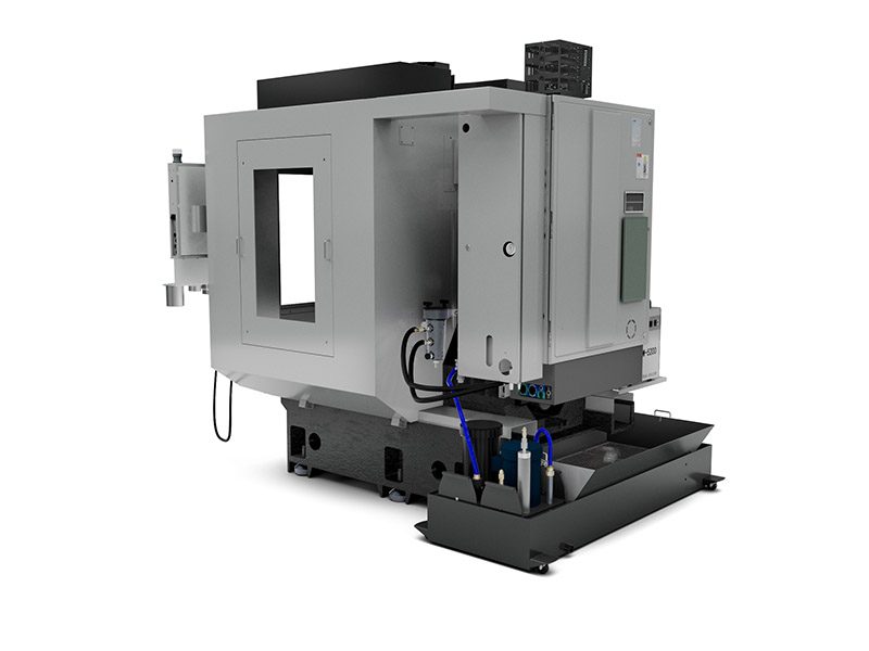

The compact footprint and rear chip discharge of the DC-1/40 allow machines to be placed side-by-side to maximize floor space, and provide easy side access for automation systems. The machine’s one-piece, extra-wide base provides stable support for heavier parts and fixtures, and the wide-stance triangulated column increases overall rigidity.
NOTE: The DC-1/40 has 14 mm T-slots. T-slot hardware and toe clamp kits are available from HaasTooling.com.
  • 10,000-rpm 40-taper spindle (12,000-rpm or 15,000-rpm available)

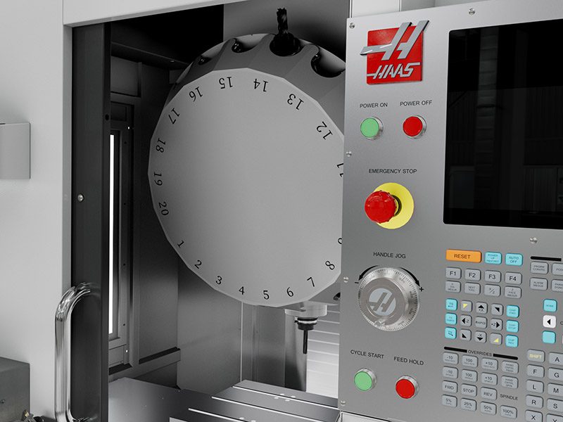

  • High-speed turret-style tool changer, 20 tools
  • Available auto window for easy automation

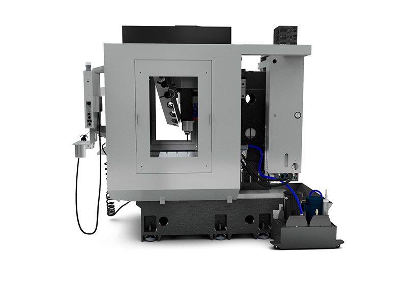

  • Rear chip discharge with front chip flush
  • Compact footprint
