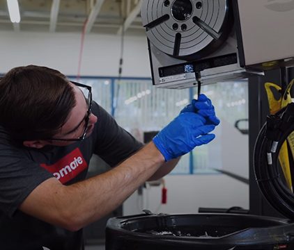

  • Inspect rotary oil level (mill)

  • Inspect the rotary oil level (Mill)
