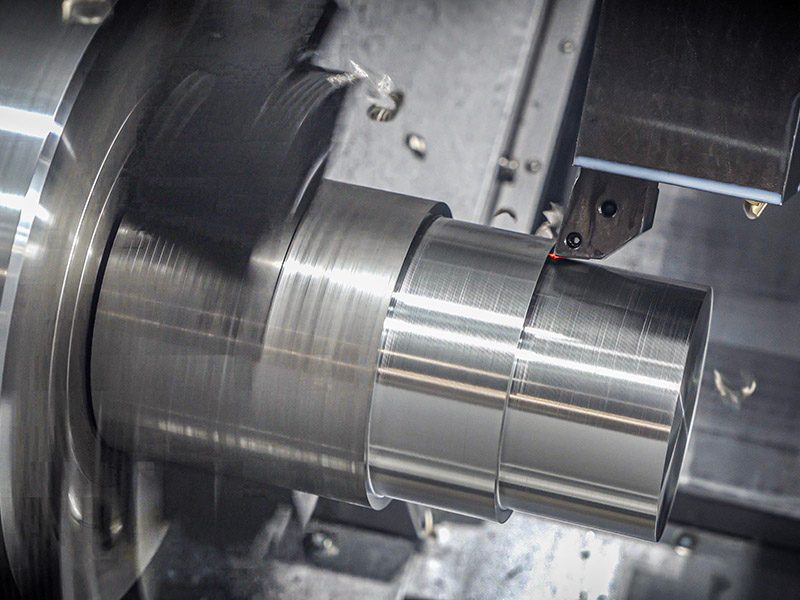

See how our lathe spindles are machined on Haas ST-40 turning centers in one of the longest-running robotic cells in the Haas factory.

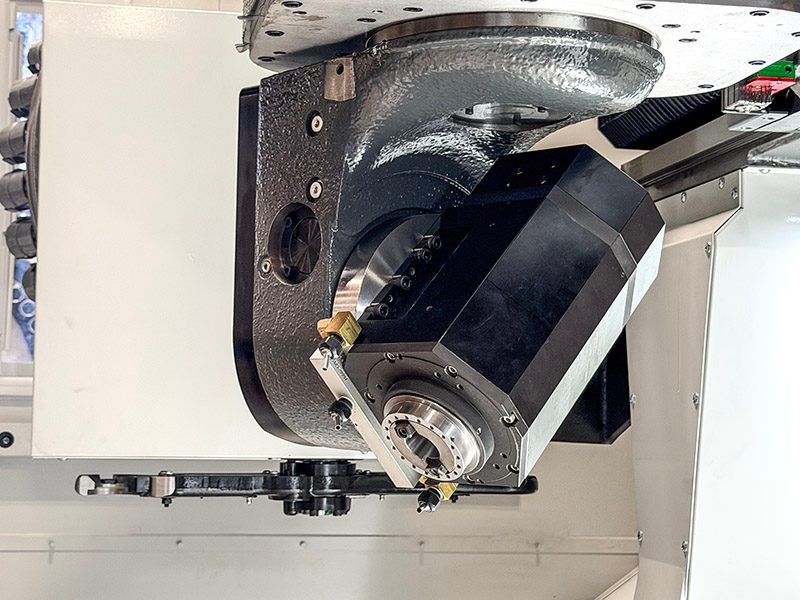

Haas Mill Spindle Options Overview
You have many options when choosing a spindle for your new Haas mill. This video provides an easy-to-understand overview of all the spindles we offer, categorized by taper size and spindle speed.

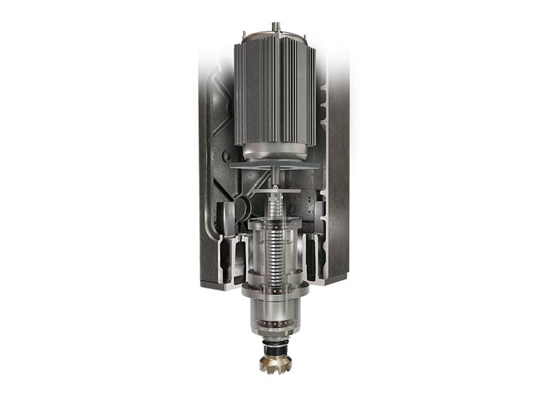

Belt Drive
This system features a Haas-built cartridge spindle that is driven by the motor via belt. This provides a good combination of torque and rpm for a wide selection of machining operations. It is a great overall value.
Inline Drive
The standard configuration for most Haas 40-taper VMCs is an inline direct-drive spindle that is coupled directly to the motor to provide excellent surface finishes and greater thermal stability. The inline spindle is available in 8100-rpm to 20,000-rpm.
Gear Drive
The Haas geared-head spindle provides increased low-end torque for heavy cutting, while retaining the ability to run up to 10,000 rpm for high-speed machining. It is standard on 50-taper machines, and optional on most 40-taper machines.

Spindle Construction
The advanced design of our spindles provides high axial-thrust capability, yet generates minimal heat. The front and rear bores of the housing and the OD of the spindle are finished in one operation. This guarantees perfect alignment between the bores and ODs, thus reducing bearing heat. We use only top-quality, high-precision bearings throughout our spindles, with the two forward bearings separated by a large spacer to enhance radial stability – enabling heavy cuts in hard materials. To ensure long life, each spindle is pressurized to prevent coolant contamination, and lubricated automatically to ensure precise lubrication and long bearing life.
