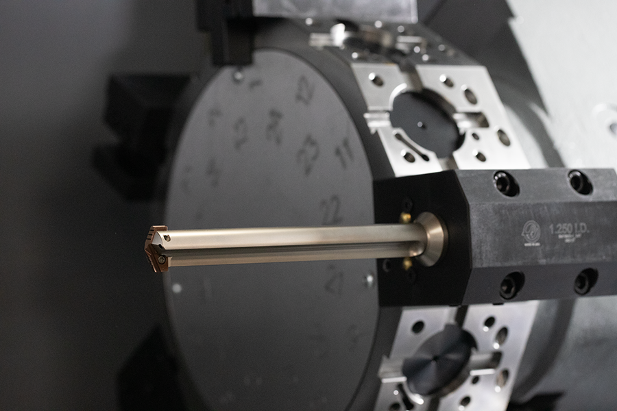

Straight Flute: recommended for horizontal drilling on lathes

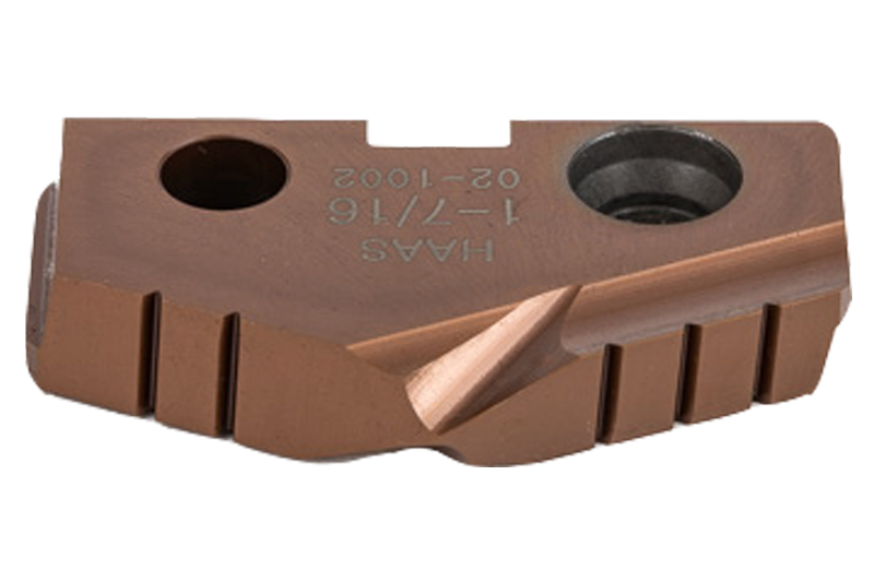

Split Point Inserts for self centering.

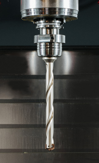

Spiral Flute: recommended for vertical drilling on mills
Insert Chip Breaker, Grade and Coating
Chip breakers and Insert grades are combined based on your selected workpiece material.
  • ST chip breaker with CS carbide grade for all steels,
  • Cl chip breaker with C3 carbide grade specifically for cast iron
  • SS chip breaker primarily for stainless steel. Due to the 'general purpose' C2 carbide grade makes this insert also suitable for cast iron, nonferrous and high temp alloys

Carbide Insert Grades
CS P40 High-strength carbide substrate for all carbon and alloy steels
C2 (K20) Carbide substrate primarily for stainless steel and cast iron, can also be used for non-ferrous materials and high temp alloys
C3 (K10) Carbide substrate with greater wear resistance specifically for cast iron
Insert strength
C5
C2
C3
Wear Resistance
Insert Coating AlCrN
All spade drill inserts are coated with Aluminum Chromium Nitride (AICrN) to provide a thin sturdy layer that is resistant to high temps that occur when drilling. AICrN also provides excellent wear resistance and reduces chipping and breaking.
