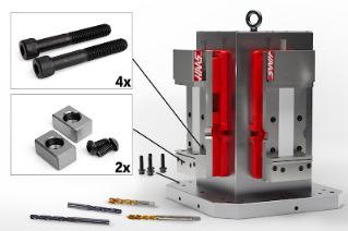

Tombstones offer maximum part production and increase throughput on your horizontal machine. Haas makes purchasing tombstones even easier with a complete lineup of tombstone kits. Kits offer all you need for mounting the tombstone to the machine plus including the drills and taps to easily prep your tombstone for mounting of vises.
All Haas Tombstone Kits include vise-body locating key stops, which aid in supporting the vise for easy installation.
Kits Include:
  • Cast Iron or Aluminum Tombstone
  • 2 Vises
  • Drills and Taps for Vise Mounting
  • Tombstone and Vise Mounting Hardware
Everything For Mounting | Everything For Lifting
All Included
Haas Tombstones offers all of the hardware needed to lift and mount your tombstone. Including metric and inch mounting hardware for both styles of pallets.

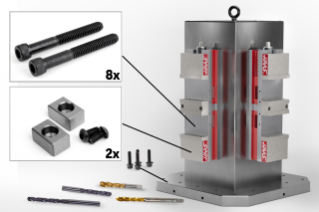

Kits include 2 Haas Workholding by Kurt Vises and a 400mm Tombstone
TOTAL PART WEIGHT = MAX PALLET WEIGHT– TOMBSTONE WEIGHT – VISE WEIGHT
Two 4" Fixed Jaw Vises
Aluminum
Total Kit Weight:
191 lb / 86 kg
Available Raw Material Weight:
309 lb / 104 kg ✓
Cast Iron
Total Kit Weight:
280 lb / 127 kg
220 lb / 99 kg ✓

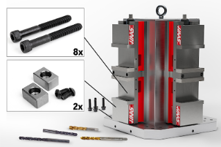

Two 6" Fixed Jaw Vises
Aluminum
Total Kit Weight:
287 lb / 130 kg
213 lb / 96 kg ✓
Cast Iron
Total Kit Weight:
376 lb / 170 kg
124 lb / 56 kg ✓

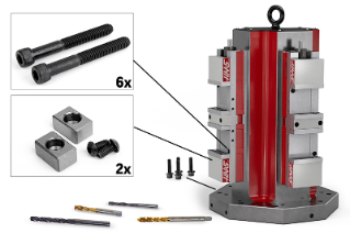

Two 4" Double-Station Vises
Aluminum
Total Kit Weight:
199 lb / 90 kg
301 lb / 136 kg ✓
Cast Iron
Total Kit Weight:
288 lb / 288 kg
212 lb / 98 kg ✓
