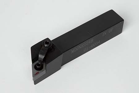

These high-quality indexable turning tools for external profiling and facing are constructed of hardened tool steel, and feature a precision pocket and secure clamping mechanism for the indexable inserts. They are available in shank sizes from 0.500" to 1.25", in a variety of tool lengths. Choose the insert shape, clamp style, and tool orientation to fit your specific application.

D – Double-Clamp System
• For negative-style inserts
• Powerful single-lever screw clamping
• Spring design releases clamp automatically
• Optimized for chip flow
M – Multi-Lock System*
• Eccentric lock pin secures the insert against the side
• Top clamp provides rigid downward clamping
S – Screw-On System
• For positive-style inserts
* For multi-lock holders: Rotate the eccentric lock pin counterclockwise until the insert drops on, and then rotate the eccentric pin clockwise to secure the insert against the side of the holder. Install the top clamp to hold down the insert.
