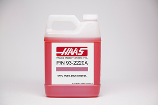

Haas Liquid Grease (HLG) cartridges and refills are no longer available. Machines using HLG should be converted to Haas Axis Lubrication Oil, at the earliest convenience.*
You may convert your machine to oil at any time. The process is simple, and is a good opportunity to verify that the machine’s axis lubrication system is working properly. See the conversion procedure linked below.
Order PN 93-3585: AXIS LUBE CONVERSION KIT HLG TO OIL from your local HFO, or through this website. The kit includes a canister of Haas Axis Lubrication Oil, and a 0.020" orifice for the side-mount tool changer (mill) or C-axis (lathe) lube line, if equipped. The conversion kit also includes a software patch containing updated system parameters, which is automatically associated with the machine serial number when the kit is ordered.
