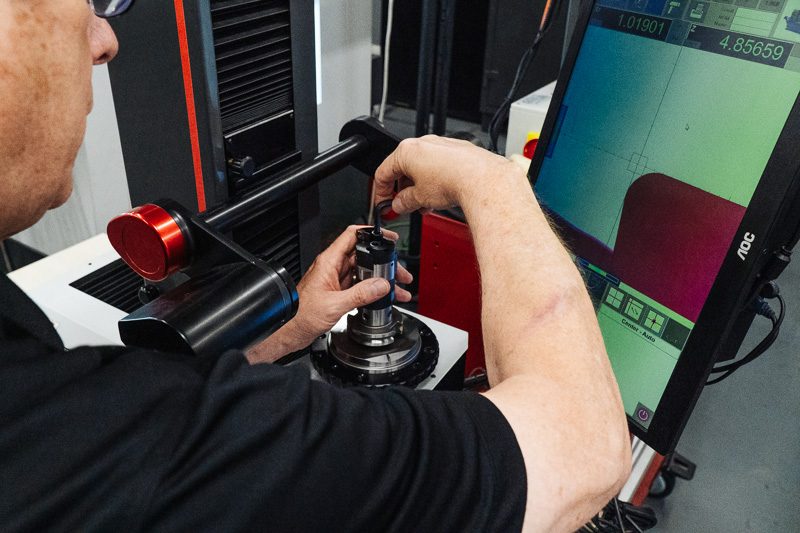

The task of setting the boring head diameter is easy and accurate when performed using a tool pre-setter like the Haas HTS-400. It allows you to set the correct diameter and adjust both cartridges to the same diameter for consistent, balanced stock removal and the best concentricity.
Follow the steps below to adjust the boring diameter.

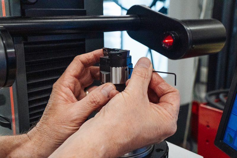

  1. Turn the LOCK SCREW counterclockwise to release the lock  (see image 1)
  2. Move the ADJUST SCREW clockwise using the WRENCH to increase the BORING DIAMETER. (see image 2)
  3. Each graduation on the scale is approximately 0.0787” or 2mm diameter. (see image 3)
  4. Turn the LOCK SCREW clockwise to lock the cartridge in place (see image 4)
  5. The CARTRIDGE on the other side is also operated in the same way as in steps 1, 2 & 4. Set the cartridge to the same position on the scale.
    Perform a rough boring operation.
  6. Measure the bore diameter. If the diameter is smaller than the tolerance after measurement, repeat steps from 1 to 6 above to adjust the bore diameter.
