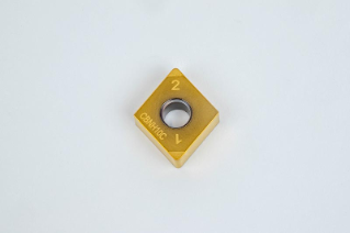

C-Style Inserts – 80° Rhombic
For external machining and facing. The large point angle is very rigid, and good for rough machining. This is the most commonly used insert.

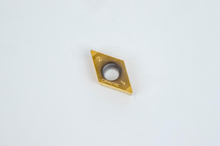

D-Style Inserts – 55° Rhombic
The smaller point angle of this insert is more versatile for finishing and detail work, but it has less cutting-edge strength than other geometries.

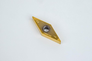

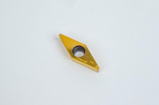

V-Style Inserts – 35° Rhombic

CNGA431 / CNGA120404, CBN Turning Insert, 80° Rhombic, Grade CBNH10C
Part #: 02-0741
RETAIL PRICE: $34.95 $423.95 $126.95 $16.95 $76.95 $177.95 $undefined
$26.97
02-0742
CNGA432 / CNGA120408, CBN Turning Insert, 80° Rhombic, Grade CBNH10C
Part #: 02-0742
$27.97

DNGA431 / DNGA150404, CBN Turning Insert, 55° Rhombic, Grade CBNH10C
Part #: 02-0743
$26.97
02-0744
DNGA432 / DNGA150408, CBN Turning Insert, 55° Rhombic, Grade CBNH10C
Part #: 02-0744
$27.97

VNGA331 / VNGA160404, CBN Turning Insert, 35° Rhombic, Grade CBNH10C
Part #: 02-0745
$27.97
02-0746
VNGA332 / VNGA160408, CBN Turning Insert, 35° Rhombic, Grade CBNH10C
Part #: 02-0746
$26.97

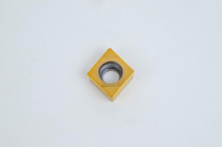

CCGW2151 / CCGW060204, CBN Turning Insert, 80° Rhombic, Grade CBNH10C
Part #: 02-0747
$26.97
02-0748
CCGW3251 / CCGW09T304, CBN Turning Insert, 80° Rhombic, Grade CBNH10C
Part #: 02-0748
$26.97
02-0749
CCGW3252 / CCGW09T308, CBN Turning Insert, 80° Rhombic, Grade CBNH10C
Part #: 02-0749
$27.97

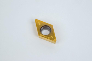

DCGW2151 / DCGW070204, CBN Turning Insert, 55° Rhombic, Grade CBNH10C
Part #: 02-0750
$26.97
02-0751
DCGW3251 / DCGW11T304, CBN Turning Insert, 55° Rhombic, Grade CBNH10C
Part #: 02-0751
$26.97
02-0752
DCGW3252 / DCGW11T308, CBN Turning Insert, 55° Rhombic, Grade CBNH10C
Part #: 02-0752
$26.97
