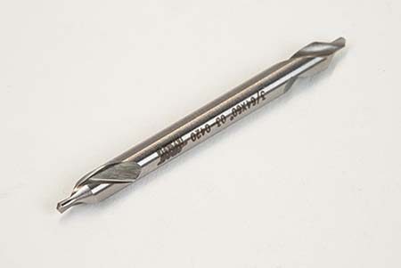

Center Drills (General Purpose):
Center drills are primarily used to create a tapered feature in the end of a part or stock to provide a secure contact point for a live or dead center. The straight pilot drill section starts the hole, and provides clearance for the point of the center, so it does not contact the bottom of the hole. The larger countersink section creates a taper in the stock that matches the angle of the center. These center drills feature a 60° countersink angle that matches the taper of our high-precision live centers.
Center Drill Sizes:
Center drills come in a range of sizes. The size of the center drill needed is determined by the size of the part being supported, along with the size of center needed.
Performace:
These high-speed-steel center drills are capable of drilling center holes in steel, stainless, cast iron, and aluminum.

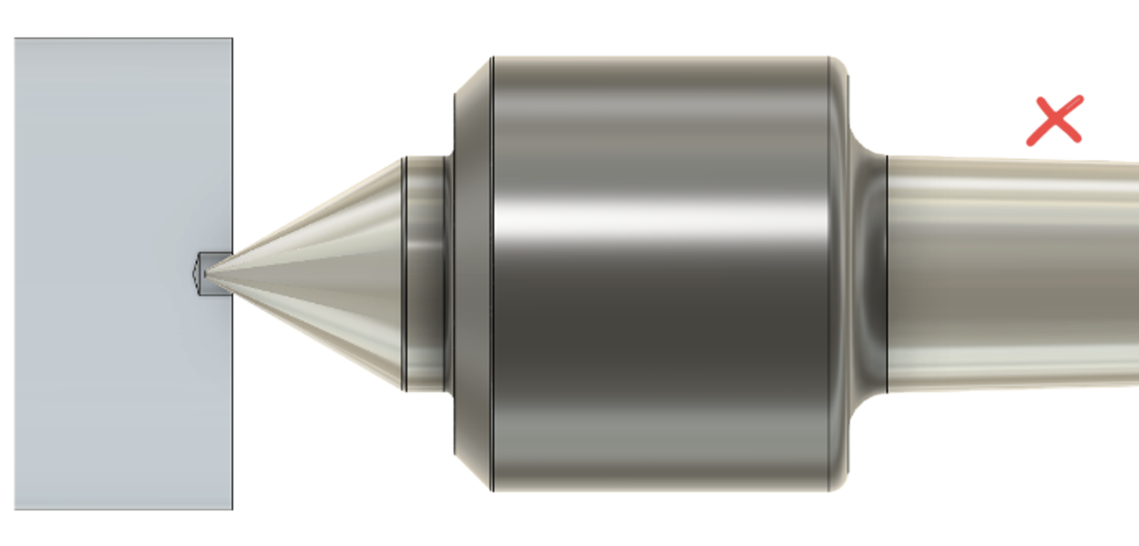

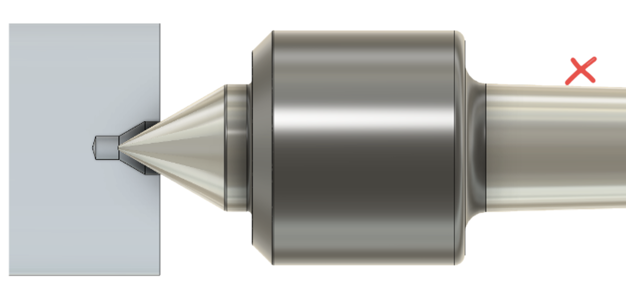

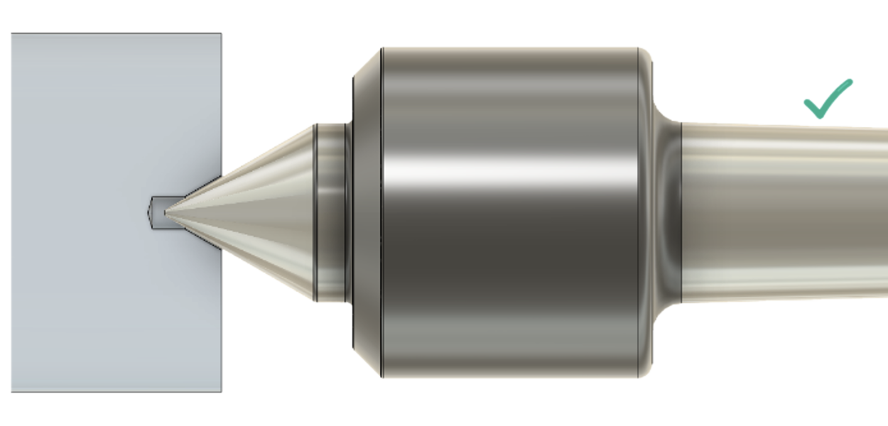

CENTER DRILL DEPTH
Center Drill Depth
____________________________
To ensure safe, secure, and accurate workholding, always drill center holes to the recommended depth. Incorrect drill depths – too shallow or too deep – will lead to improper workholding, which may cause imbalance in the workpiece, incorrect dimensions, or poor finishes. Check the technical specifications of your center drill to find the recommended depth range.
TOO SHALLOW
CORRECT
TOO DEEP
