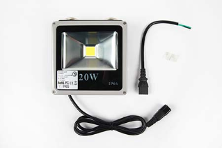

ATTENTION: Your Haas machine may have either a 115 VAC or 24V lighting system. Please verify the voltage of your lighting system, before ordering replacement lights.
Prior to October 2019, the work lights on Haas machines operated on 115VAC power – both the standard internal lights and the optional High-Intensity Lighting systems. However, in October 2019, Haas began transitioning the machines to a 24V lighting system for more reliability, beginning with the small-frame VMCs (VF-1 through VF-2, all variants). Currently, all Haas machines use a 24V lighting system.
  • Machines built prior to 10/1/2019 have 115 VAC lighting systems.
  • Machines build after 6/15/2021 have 24V lighting systems.
  • For machines built between 10/1/2019 and 6/15/2021, search by your machine serial number to find the correct replacement work light.
