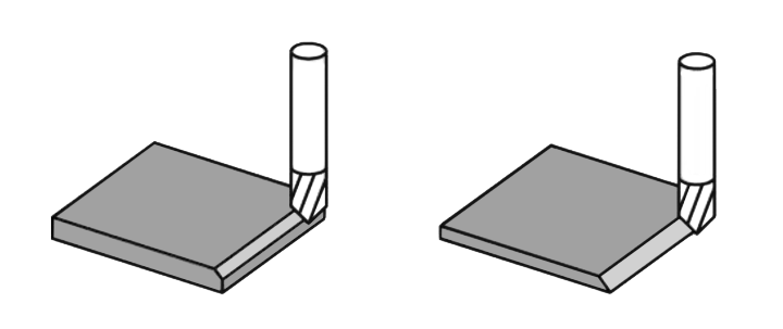

Chamfer Mills are one of the most common tools used by machinists, because nearly every machined component requires at least one chamfer operation. Many machining operations leave a burr or sharp edge on the workpiece, and a chamfer mill removes the sharp edges, leaving a smooth, angled surface or chamfer.
In addition to chamfering, these versatile chamfer mills can be used for several other machining operations, such as creating a full bevel along the edge of a part, breaking sharp edges, countersinking holes, or preparing material for welding operations.
Chamfering
Beveling
