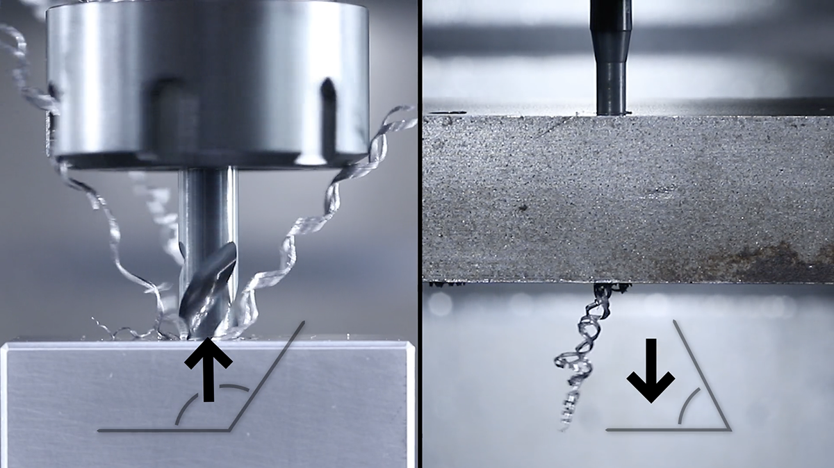

Cutting Angles come in various styles, and the style is always included in the tap name. The cutting angle determines whether the chips are pushed in front of the tap and into the hole, or drawn up the flutes and out of the hole.
STRAIGHT FLUTE
SPIRAL FLUTE
SPIRAL POINT

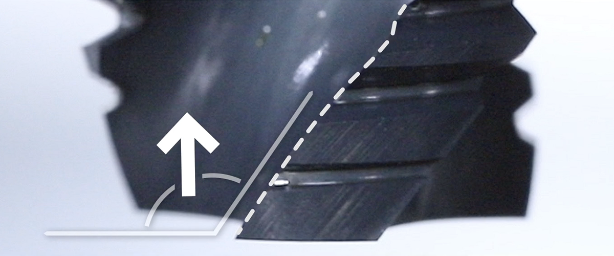

Spiral Flute taps have a positive rake cutting angle, and they pull the chips up the flutes and out of the hole as they are cut. These taps work very well tapping blind holes in “long chipping” materials, like aluminum and steels.
Spiral Point taps have a negative rake cutting angle, and push the chips into the hole as they are cut. It is best to use this type of tap on through-holes, so the chips can exit the hole through the bottom. If used on blind holes, make sure the hole is drilled deep enough to leave space for the chips to go, to prevent breaking the tap. Spiral Point taps will have trouble with some “long chipping” materials, like aluminum, stainless steel, and some softer steels, when tapping blind holes.
Straight Flute taps have a neutral rake cutting angle, which can cause the chips to go either way, depending on material and cutting conditions. These taps are primarily used on “short chipping” materials like cast iron. They can be used on blind holes or through-holes, and are a good choice for hand tapping.

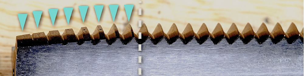

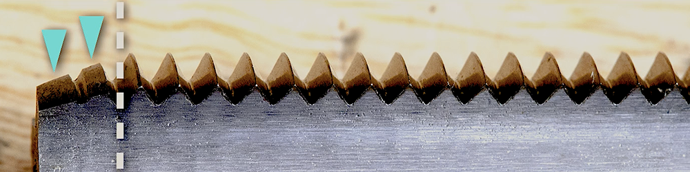

Chamfer Length is the second characteristic to consider when buying taps. There are three primary types of chamfers: Taper, Plug, and Bottoming. You can purchase any cutting angle (Spiral Point, Spiral Flute, Straight Flute) tap in any of the chamfer types, but Plug and Bottoming are most commonly used in CNC machine applications.
Any of the cutting angles can be applied to any of the chamfer styles, but Haas Tooling carries the most popular combinations, including spiral point bottoming, spiral point plug, spiral flute bottoming, spiral flute plug, and straight flute bottoming.

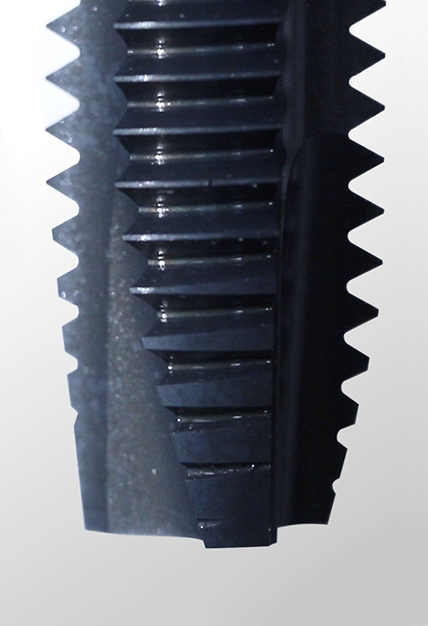

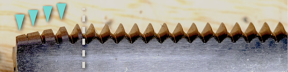

Taper chamfers are usually 8 or 9 threads long. They require the least amount of torque and last the longest, because the cutting loads are spread over a greater number of threads. Taper chamfers are most often found on “hand taps” designed to manually tap a hole. The long chamfer helps get the tap started straight in a hole. The drawback to taper chamfer taps is that they will not produce full threads near the bottom of a hole. Typically, in hand-tapping operations, you will start with a chamfer tap, and then “chase” the threads with a bottoming tap to cut the threads to the bottom of the hole.
Plug chamfers are medium length, usually 4 to 5 threads. These are more common for CNC machining than Taper chamfers, and are the “workhorse” of taps. They require a little more torque to cut the threads, but spread the cutting load well across 4 or 5 chamfered threads.
Bottoming chamfers are only 1 or 2 threads in length, and are the best choice when you need to thread close to a shoulder, counterbore, or the bottom of a hole. Bottoming taps require the most cutting force, and also wear out faster than comparable plug taps, because all the cutting is done by the first 1 or 2 threads of chamfer.
TAPER             PLUG            BOTTOMING

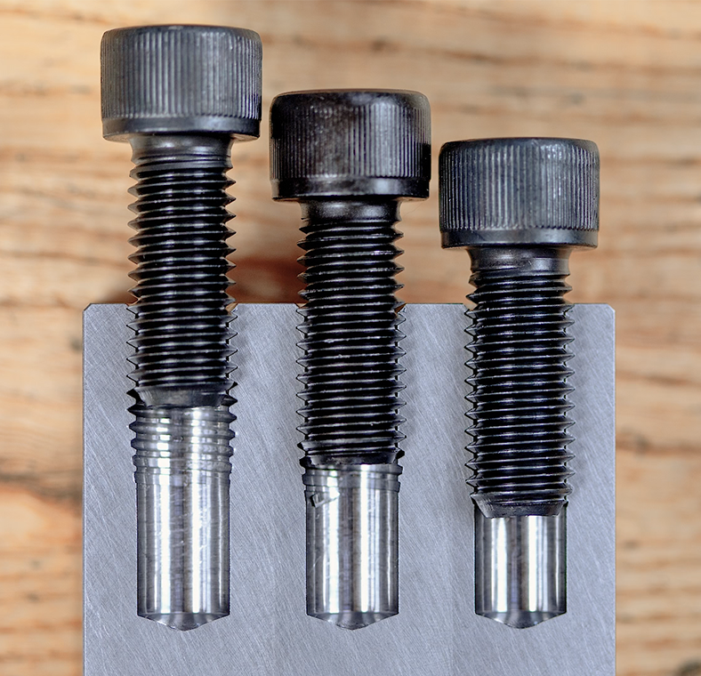

Be aware that taper, plug, and bottoming taps will cut full threads to different depths when programmed to the same Z-depth. Carefully review your engineering drawing requirements before choosing which cutting tap to use in a particular application.

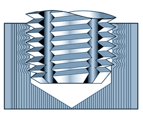

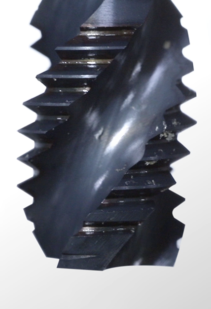

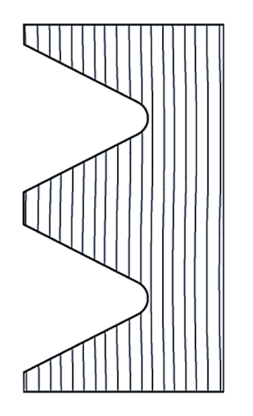

Roll taps, or form taps, unlike conventional cutting taps, form threads through material deformation, rather than by cutting the material. As a result, no chips are produced in the process. Since there are no chips to interfere with the tapping process, roll taps produce stronger, cleaner threads, with excellent surface finish. And since there are no chips to clog flutes or collect in blind holes, there’s less chance of tap breakage.
Roll taps require a larger drill than a cutting tap of the same size, to allow room for the material to flow when creating the threads. The grain flow of the material follows the contour of the formed thread, creating a stronger thread, especially in materials that work harden, like steel and stainless. Generally, roll taps can be run at higher speeds and feeds than cutting taps, and have a significantly longer tool life. They are well suited for smaller holes and materials that require a stronger tap.
ROLL/FORM TAPS
Roll taps form threads through material deformation, so there are no chips to interfere with the tapping process.

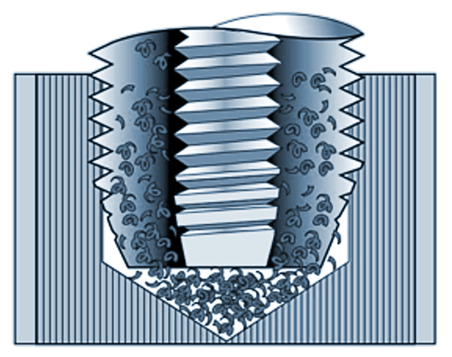

CUT TAPS
Cut taps form threads by cutting the material, creating chips that can clog flutes or collect in blind holes.
