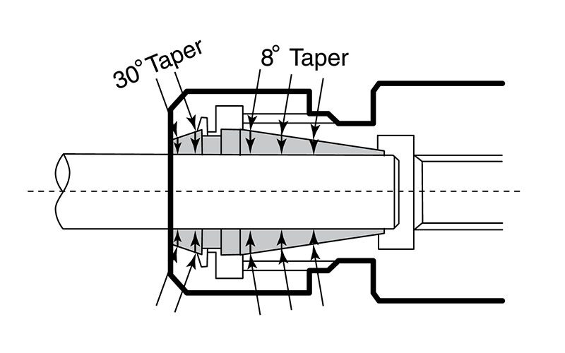

STRONG GRIPPING TORQUE
  • The longer clamping area of the double-taper collet provides stronger gripping force, and higher transferrable torque
  • Additional gripping torque can be achieved by using a ball bearing nut

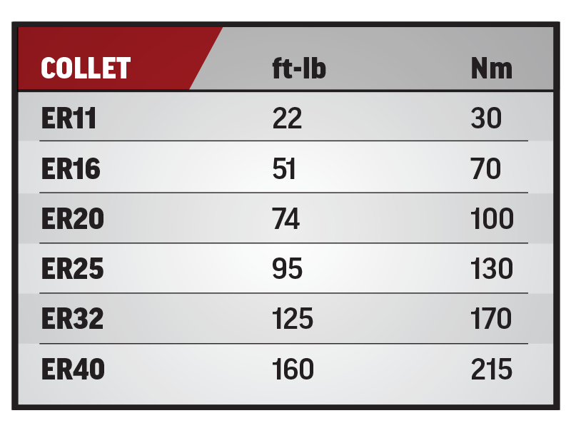

STANDARD ER COLLET TORQUE SPECIFICATIONS
Proper torque is an important variable for toolholding; too little torque and the cutting tool can slip, pull-out, or vibrate excessively, and too much torque can lead to accelerated wear, damage, or potentially increased runout (TIR). Below is a table that suggests standard torque values for each respective ER-taper size.

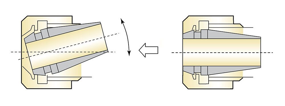

EASY ASSEMBLY AND DISASSEMBLY
To assemble the collet, gently insert the groove of the collet into the eccentric ring inside the nut, and then snap the collet into place. To disassemble the collet, tilt the collet to the side until it snaps out of the eccentric ring, and remove it from the nut.
