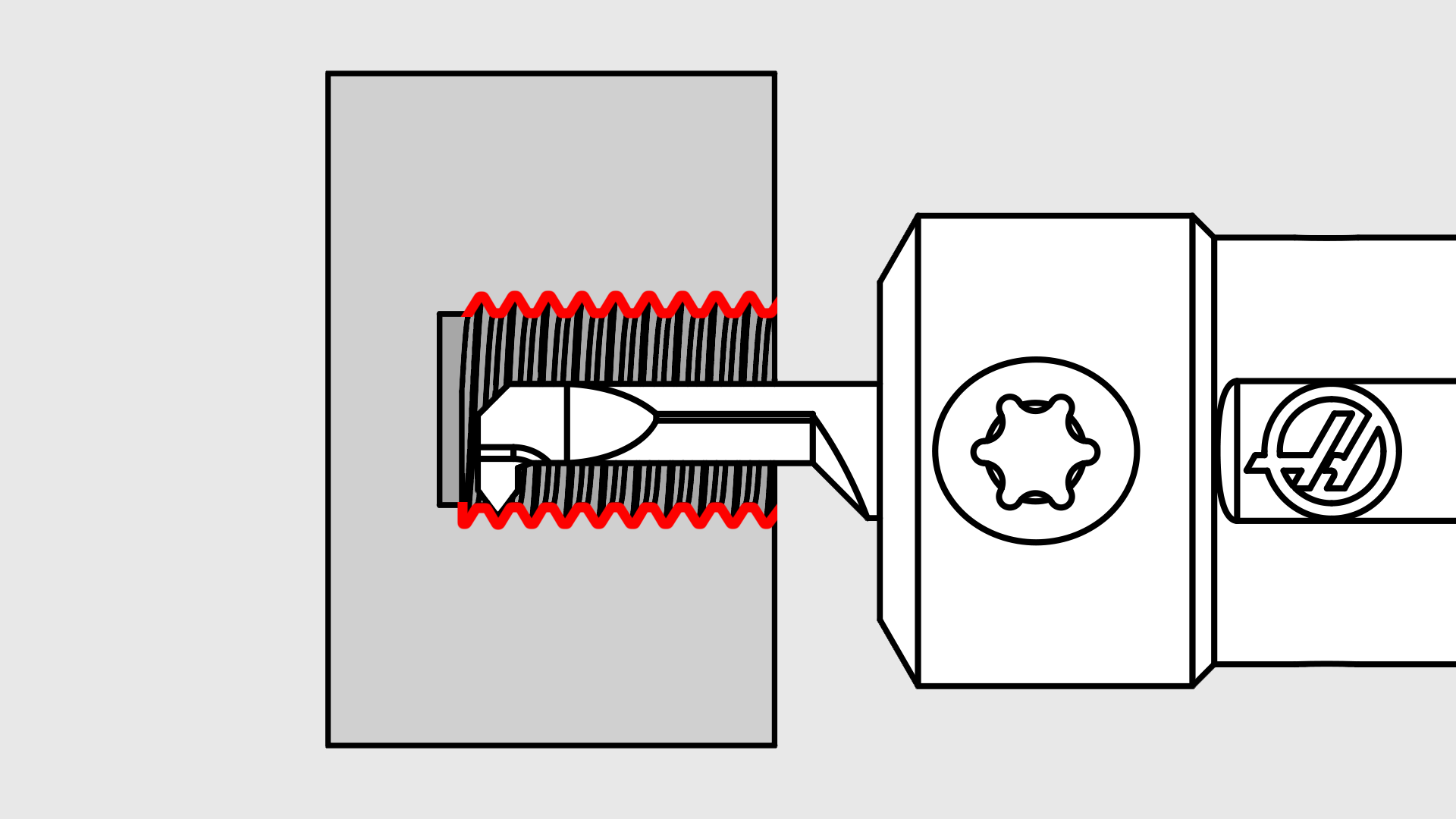

  • Many Geometries for ID boring, ID Threading, ID and Face Grooving
  • Micro Grain Carbide grade with TiN coating

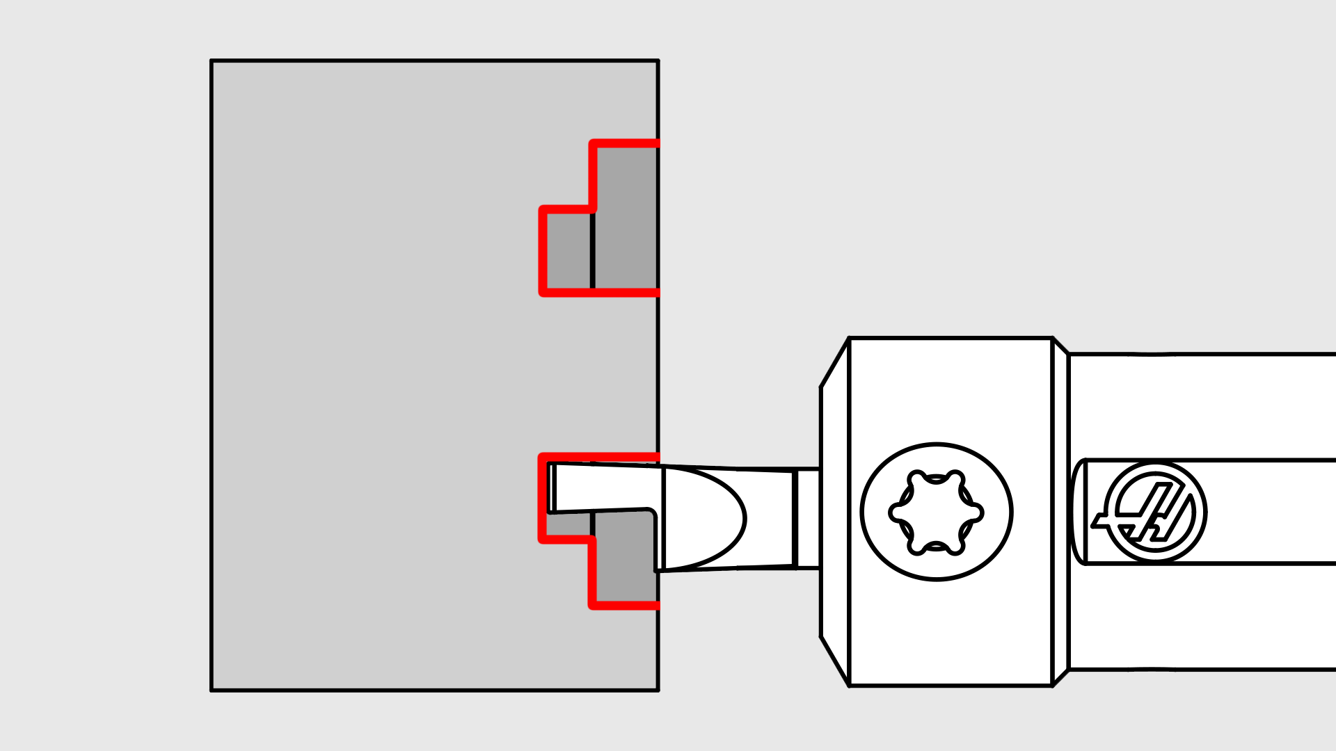

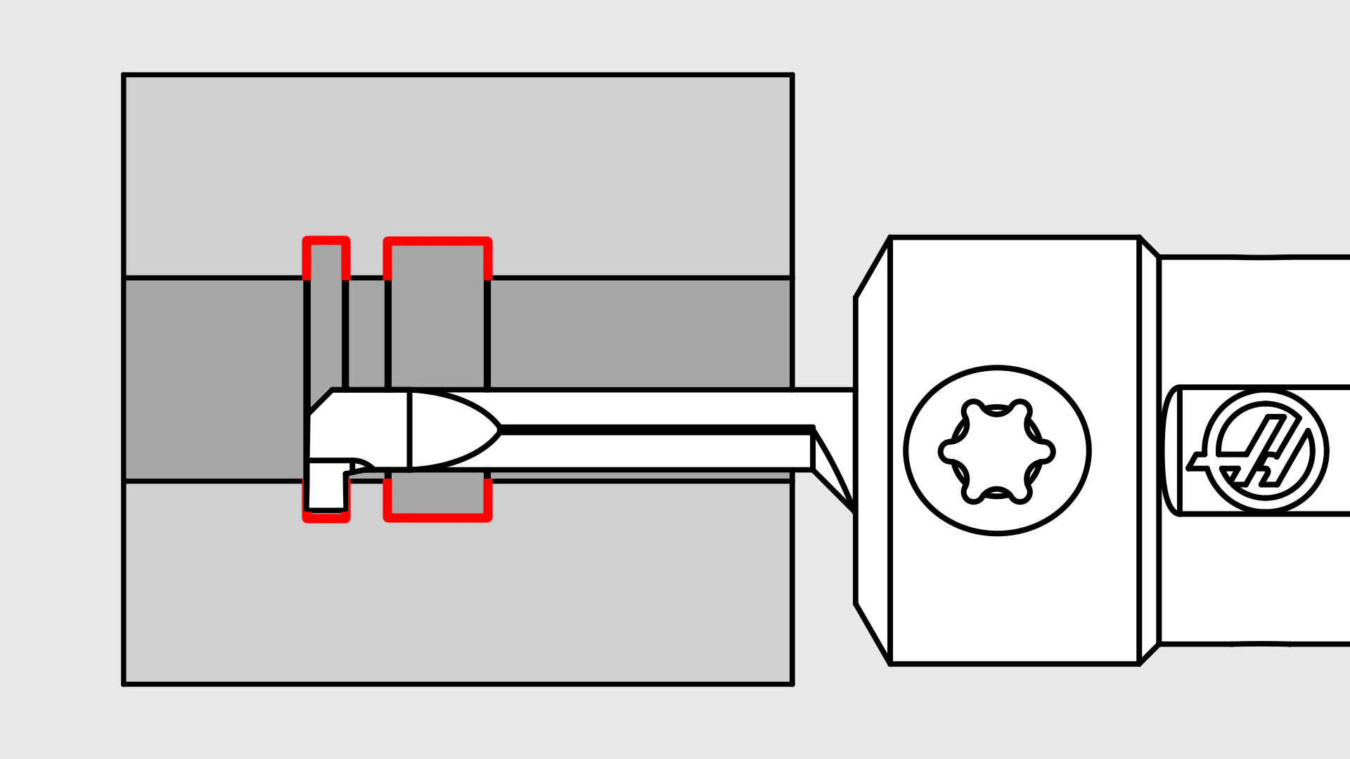

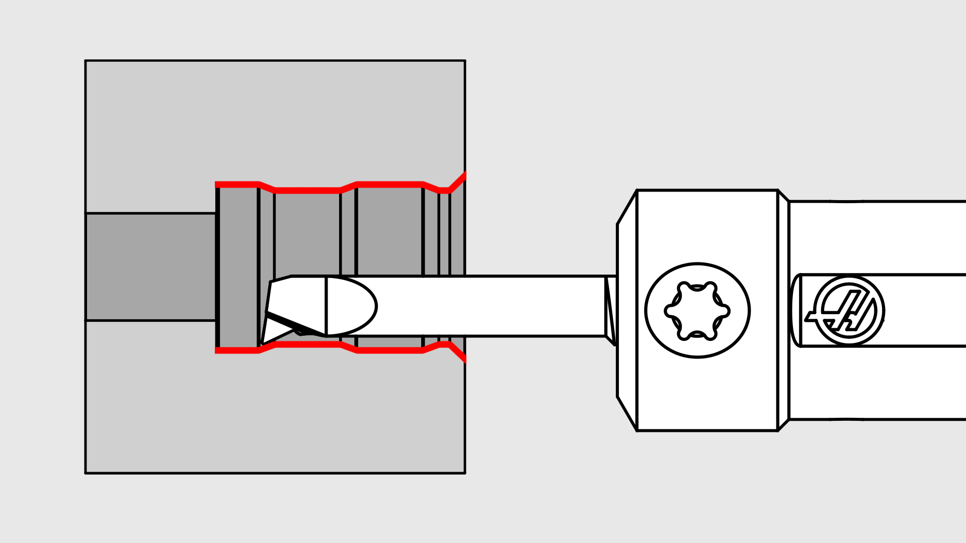

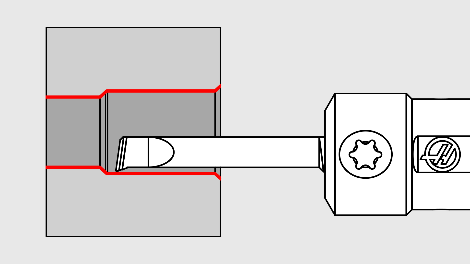

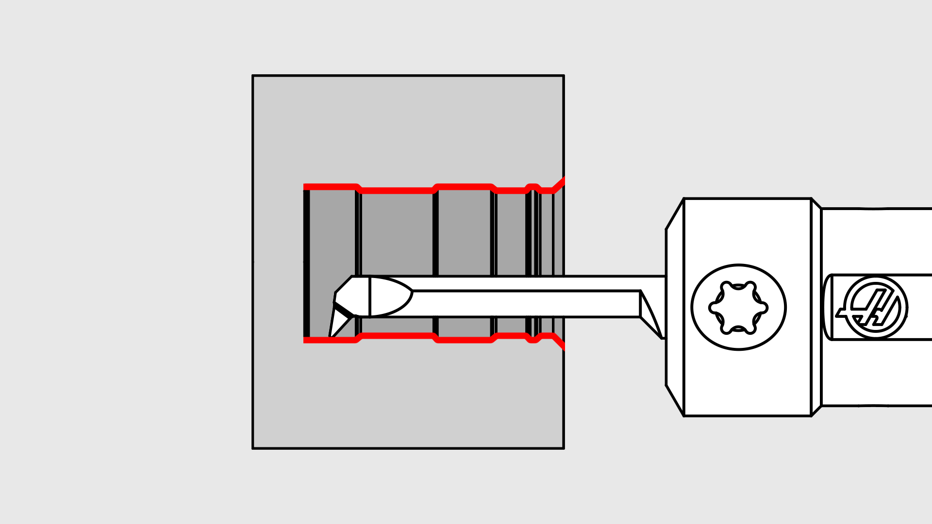

HMB - Boring and Profiling
HMRG - Radius Groove
HMBC - Boring w/Chipbreaker
HMC - Chamfering
HMFG - Face Groove
HMG - Groove
HMPB - Profiling
HMTH- Threading
