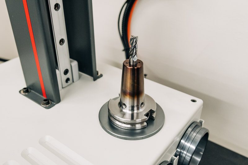

Shrink fit toolholders are considered one of the most solid, robust, and accurate tool clamping systems in high-volume machining. Haas shrink fit machines are fully equipped, sturdy, and easy to use – at amazing prices. They feature a simple, user-friendly control panel that makes loading cutting tools into shrink fit toolholders fast and easy.
Shrink fit toolholders rely on the thermal expansion characteristics of metal to provide extremely accurate tool holding, with very high grip force. The bore of the shrink fit toolholder is engineered to be slightly smaller than the diameter of the cutting tool. When the toolholder is heated, the bore expands, allowing the cutting tool to drop in. when the toolholder cools, the bore contracts, firmly clamping the cutting tool in place.
Haas shrink fit machines are used to properly heat and cool the toolholders quickly, reducing the time needed to change cutting tools, and ensuring the toolholders are not overheated.
Features of the Haas Shrink Fit Machines
  • Interchangeable tool sleeves are easy to change when heating different taper toolholders
  • Fast heating – the eddy current induces heat from the high-frequency magnetic field, for short cycle times and easy operation
  • Higher efficiency – the process is timed to apply enough heat to the toolholder to remove cutting tools, without overheating
  • Units feature compressed air cooling or automatic liquid cooling (depending on model) for ease of use
  • HSF-325: Clamping range for tool diameters 10 mm to 32 mm
  • HSF-450: Clamping range for tool diameters 3 mm to 32 mm
  • Haas shrink-fit holders are available in a wide range of diameters
  Benefits of Shrink Fit Tooling
  • Very low runout (< 0.0001" TIR)
  • Very accurate
  • Very high grip force
  • Small nose diameters for better part access
  • Quick tool changeovers
  • Low maintenance
Applications
  • High-volume production
  • High-accuracy machining
  • High spindle speeds and feedrates
  • Long-reach applications
  • Better part access for 5-axis machining
Recommended for carbide cutting tools only.
