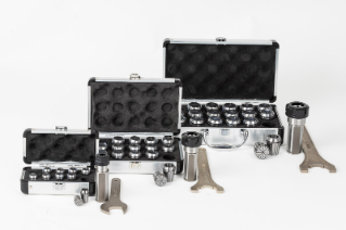

  • Collets are available individually or in kits
  • Collet series is determined by the toolholder ER-taper size (11, 16, 20, 25, 32, 40)
  • Collet bore diameter is determined by the cutting tool shank diameter

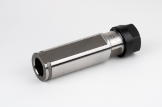

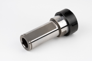

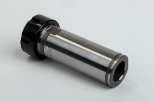

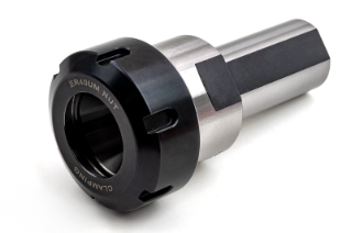

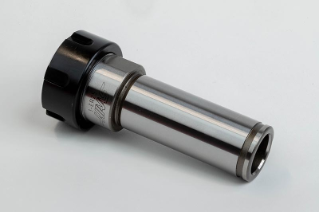

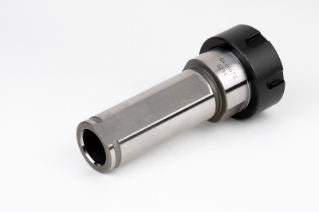

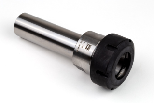

STRAIGHT SHANK ER COLLET CHUCKS OVERVIEW
Straight Shank ER Collet Chucks – Guidelines
Straight shank ER collet chucks are a versatile and precise method for clamping a variety of round shank tooling, such as spot drills, drills, taps, reamers, and more. Our straight shank collet chucks feature ER-8, 11, 16, 25, 32, or 40 collet tapers for tool clamping. The cylindrical shanks have one flat, and will install in any tool block that has the appropriate bore size and set-screw clamping, such as our BOT or BMT tool blocks. A bushing may be used to size down the bore in the tool block, if it is larger than the shank of the collet chuck.

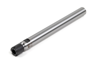

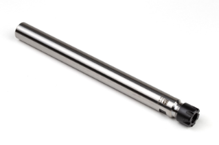

Straight shank ER collet chucks can also be used as extended-length milling collets, by clamping them into the appropriate endmill toolholders.
  • High clamping force and high transferable torque
  • Sizes: ER-8, 11, 16, 25, 32, or 40
  • Shanks manufactured to H6 tolerance

08-1719A
49-Piece, Straight Shank ER Collet Kit; ER16, ER25, and ER32
Part #: 08-1719A
RETAIL PRICE: $661.95 $undefined
$562.97

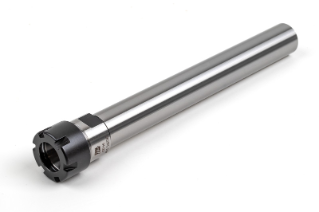

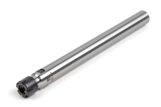

04-1224
ER8M 1/2" Straight Shank Extended Collet Chuck x 5" Shank Length, TSC
Part #: 04-1224
RETAIL PRICE: $57.95 $undefined
$34.97
