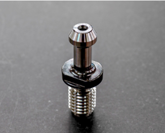

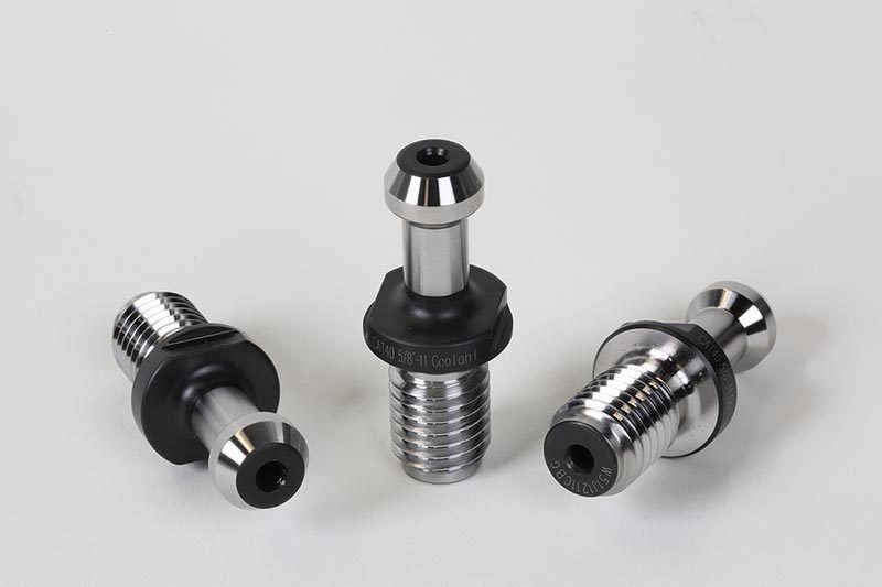

TSC Pull Studs:
TSC (through-spindle coolant) pull studs have a hole through the center that allows through-spindle coolant to flow through the toolholder.

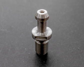

Solid Pull Studs:
Solid pull studs do not have a hole through the center, and WILL NOT allow through-spindle coolant to flow through the toolholder.
