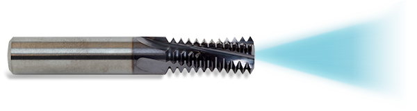

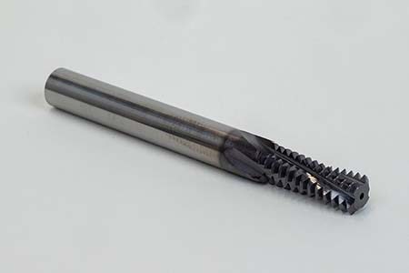

Haas solid carbide thread mills allow threading of a range of hole sizes, in a wide range of materials, using the same thread mill.
These tools are titanium aluminum nitride (TiAlN) coated, solid carbide cutters with cylindrical shanks, and they feature a hole through the center of the tool to take advantage of through-tool coolant.
This is especially beneficial for removing swarf when threading blind holes, and to lubricate and cool the cutter.

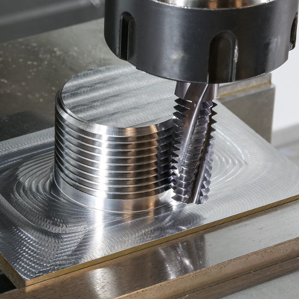

These are right-hand cutting tools, meaning they must be programmed with an M03 Spindle On-Forward command on milling machines. These cutters can produce internal right-hand or left-hand threads. The difference is in the programming technique. The circular interpolation motion must be accompanied by a helical motion of the Z-axis equal to 1 pitch of the thread being cut. Positive motion in the Z-axis (moving Z upward) produces a right-hand thread, while negative motion (moving Z downward) produces a left-hand thread.
A thread mill is similar to an endmill, but with the profile of a thread on the side. Modern CNC machines can helically interpolate all three axes to mill a thread profile into a workpiece. The operator can use the machine’s cutter compensation feature to very precisely control the thread’s major diameter. As the tool wears, offset adjustments will allow you to continue cutting good threads, as long as the form is still good. Thread mills typically produce more threaded holes per tool than taps, for this reason.
Thread mills can also produce threads on the outside of a boss. Be aware that not all thread forms have the same specifications for internal and external versions. Some threads may require a unique thread mill for the internal and external versions.
