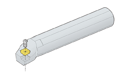

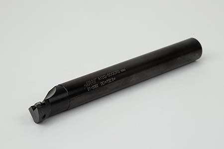

These high-quality indexable turning tools for internal profiling are constructed of hardened tool steel, and feature a precision pocket and secure clamping mechanism for the indexable inserts. They are available in shank diameters from 0.313" to 1.500", in a variety of tool lengths. Choose the insert shape, size and clamp style to fit your specific application.
We also offer carbide boring bars, for applications with larger length-to-diameter ratios, or that are prone to vibration. These boring bars feature a carbide shank, which is more rigid than tool steel, and offers higher strength and durability. They offer excellent cutting performance, with improved tool life, and better surface finishes.
CARBIDE VS STEEL BORING BAR
Clamping Styles
____________________________
M – Multi-Lock System*
• For negative-style inserts
P – Lever-Lock System
S – Screw-On System
• For positive-style inserts
* For multi-lock holders: Rotate the eccentric lock pin counterclockwise until the insert drops on, and then rotate the eccentric pin clockwise to secure the insert against the side of the holder. Install the top clamp to hold down the insert.
