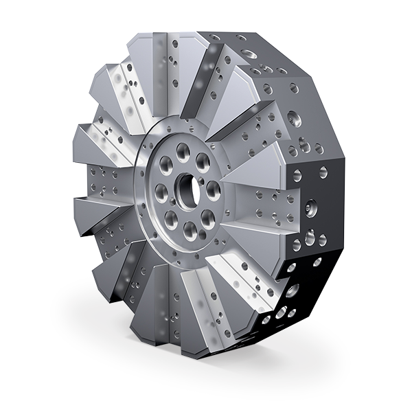

Set up your Haas BOT turret with the best tools available. Haas bolt-on style tool turrets provide super-rigid mounting of turning tools and boring bars. The turrets accept industry-standard bolt-on toolholders around the perimeter, and have radial slots on the face for mounting turning tools in either the right- or left-hand direction.
  • Industry-standard bolt pattern
  • Black oxide coating for corrosion resistance

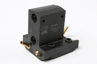

Internal (ID) Turning Holder
  • OEM tooling designed to fit your Haas lathe turret
  • Inch and metric sizes available
  • Through-tool coolant back cover plate included
  • Interchangeable front coolant nozzles

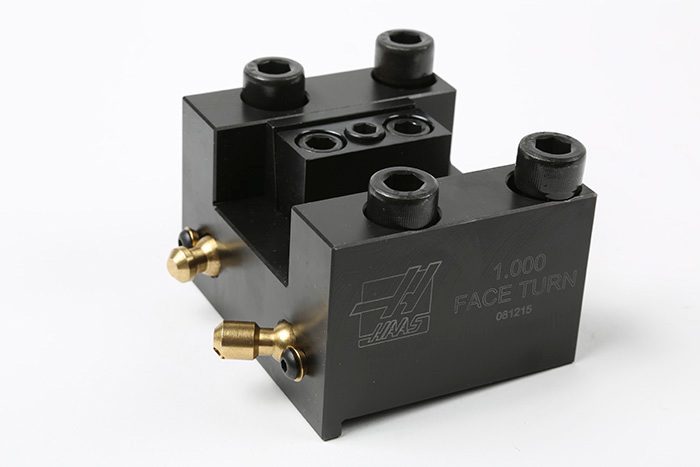

Face Groove Holder
  • Includes wedge clamp for rigid holding of the tool shank
  • Available for inch and metric shank sizes
  • Holds tool shank parallel to spindle centerline

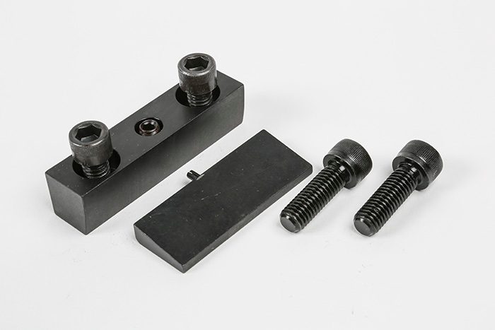

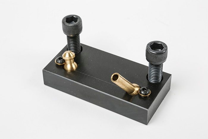

Clamp
  • Wedge and/or block style available
  • Wedge and block clamps hold inch and metric shanks
  • Secure rigid holding of the turning tool
  • Bolted or pinned for proper alignment
Coolant Block
  • Easiest way to deliver coolant to the cutting area
  • Top and bottom coolant nozzles for best coolant delivery
  • Black-oxide coating for corrosion resistance
  • Includes all necessary hardware for immediate use

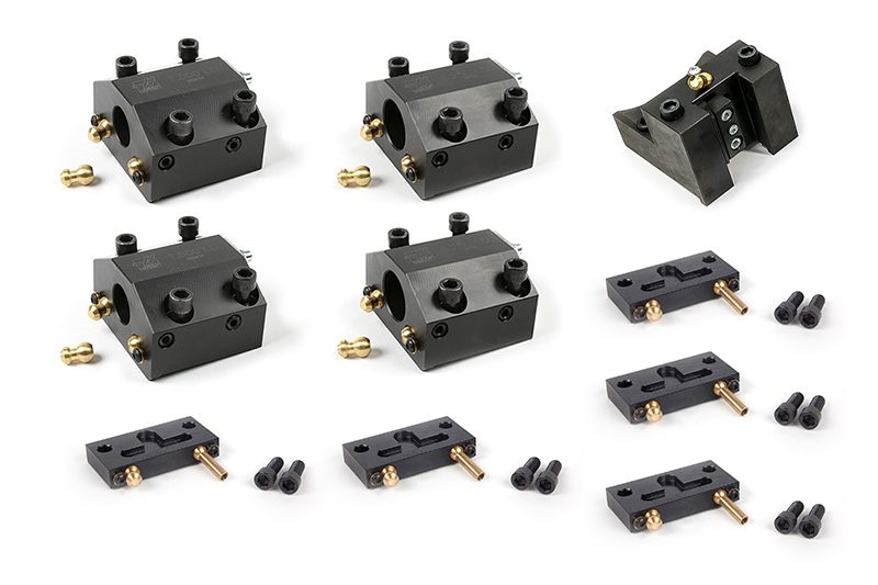

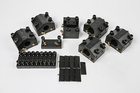

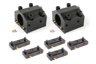

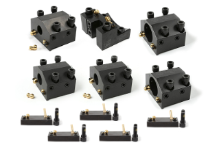

Toolholder Kits
  • Kits can include internal turning holder, coolant blocks, external turning holder, and more
  • Inch and metric kits available
