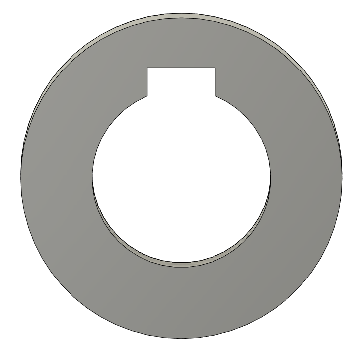

KEYWAY PROFILE
Holders:
  1. Quenched and tempered tool steel hardened to 58-60 HRC
  2. Increased resistance to compression to provide a long service life
  3. Includes through tool coolant to cool, lubricate, and extract chips
Shop Keyway Holders
Inserts:
  1. Sintered alloy hardened to 70-71 HRC
  2. High toughness capable of withstanding strong pressures
  3. TiN coating provides anti wear and seize properties
  4. Available in Clearance, Slip/Snug, and Interference Fit
SHOP KEYWAY INSERTS

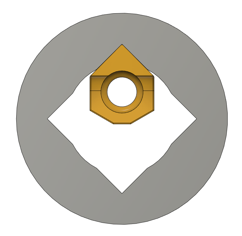

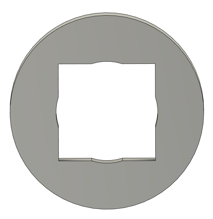

SQUARE PROFILE
Holders:
Shop Square Holders
Inserts:
  3. TiN coating provides anti-wear and seize properties
  4. One insert can make various sizes
SHOP SQUARE INSERTS

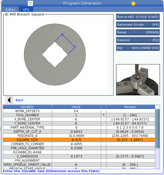

An oversized pre-drilled hole is required
Pre-Drilled Hole Diameter = Square Thickness x 1.050
Ex: 10mm x 1.050 = 10.50mm

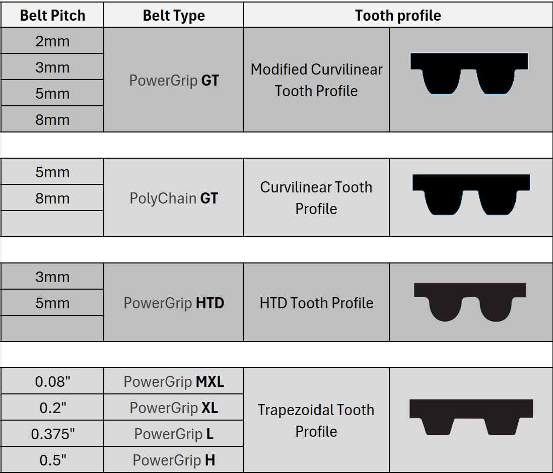

SYNCHRONOUS PULLEY PROFILE
The Haas Synchronous Pulley Broaching line consists of a wide range of inserts to form a variety of tooth profiles and pitches for synchronous belt pulleys (also known as timing belts). The inserts are manufactured to many different metric and Inch profiles, allowing you to make your own sprockets or pulleys to accommodate synchronous belts from PowerGrip®, PolyChain® GT®, HTD® PowerHouse®, MXL, XL, L and H belts and many other similar profiles.
Insert Coating and Grade
Haas synchronous pulley inserts are manufactured from a sintered alloy, and then heat treated to a hardness of 70-71Rc. This gives the inserts high toughness, and allows them to withstand the high pressures generated during the broaching process. The inserts receive a titanium nitride (TiN) coating to increase wear resistance and reduce friction.

  4. Profiles for PowerGrip®, GT®, PowerHouse® and other similar synchronous belts.
  5. Available in inch and metric pitches.

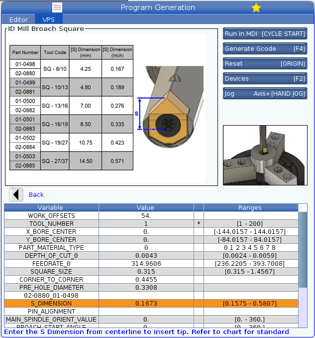

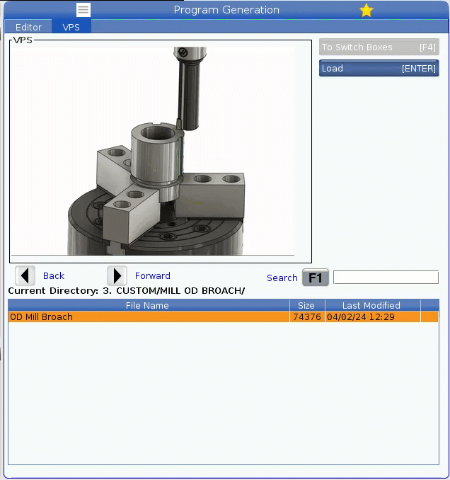

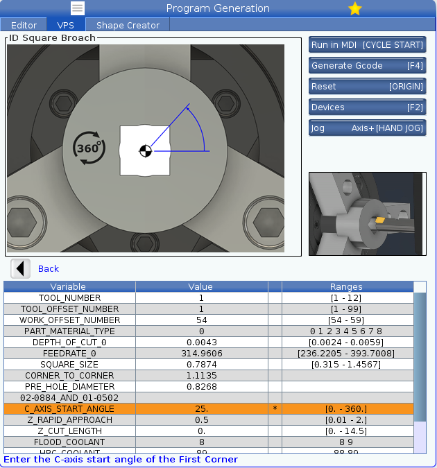

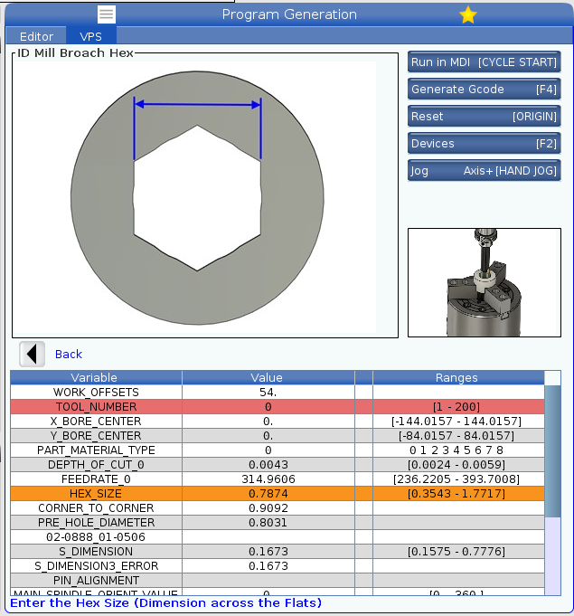

Broaching VPS Templates
MILL ID/OD BROACHING VPS TEMPLATES
Built-In Haas VPS Templates for Mill Broaching
Quickly and easily start broaching on your Haas Mill! Haas offers an easy-to-follow Visual Programing System for broaching right on your Haas control.
  • MILL ID BROACHING VPS TEMPLATE
  • MILL OD BROACHING VPS TEMPLATE
  • TEMPLATE INSTALLATION INSTRUCTIONS
* If your machine’s control does not have the templates built in, you can download the templates above. Install the templates into the My VPS folder, and access them via the VPS CUSTOM folder. (The VPS Templates are compatible with Mill NGC software release 100.22.000.1000 or later.) The mill broaching template can be found on your Haas mill control on the VPS tab of your Edit page.
CAUTION: These are beta templates. Verify the path of the generated program in graphics. It is also recommended to cycle the sequence without a part loaded (air cuts) before commencing with machining.

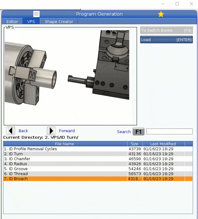

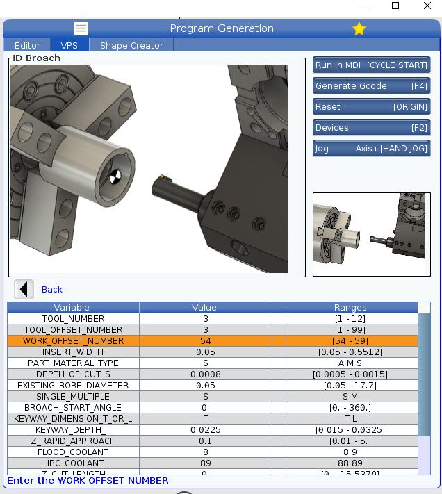

LATHE ID/OD BROACHING VPS TEMPLATES
Built-In Haas VPS Templates for Lathe Broaching
Quickly and easily start broaching on your Haas lathe. Haas offers an easy-to-follow Visual Programing System for broaching right on your Haas control.
  • LATHE ID BROACHING VPS TEMPLATE
  • LATHE OD BROACHING VPS TEMPLATE
  • TEMPLATE INSTALLATIONS INSTRUCTIONS
* If your machine’s control does not have the templates built in, you can download the templates below. Install the templates into the My VPS folder, and access them via the VPS CUSTOM folder. (The VPS Templates are compatible with Lathe NGC software release 100.22.000.1000 or later.). The lathe broaching template can be found on your Haas lathe control on the VPS tab of your Edit page.

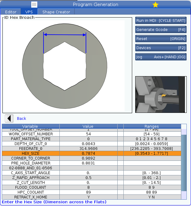

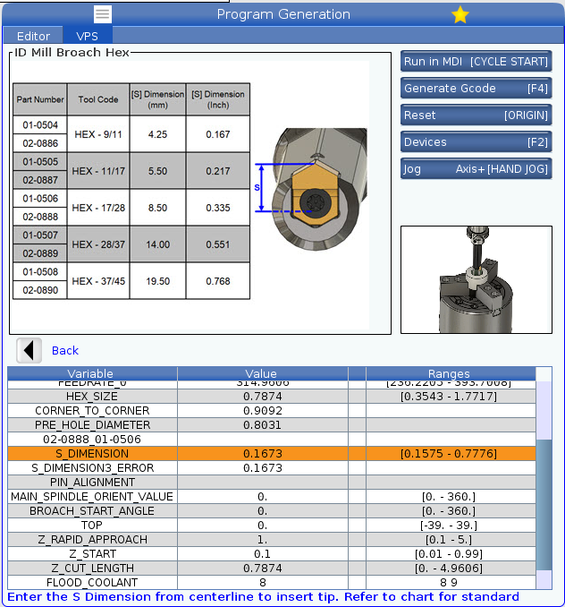

Mill HEX BROACHING VPS TEMPLATES
HEX Built-In Haas VPS Templates for Mill Broaching
Quickly and easily start broaching on your Haas mill. Haas offers an easy-to-follow Visual Programing System for broaching right on your Haas control.
  • Mill HEX BROACHING VPS TEMPLATE

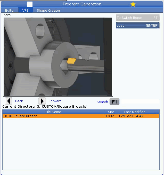

Mill Square BROACHING VPS TEMPLATES
Square Built-In Haas VPS Templates for Mill Broaching
  • Mill Square VPS TEMPLATE

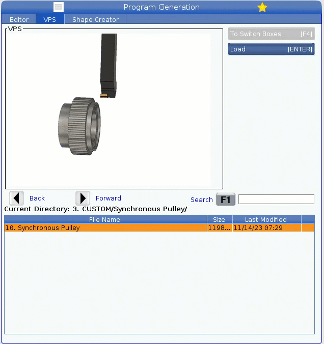

Synchronous Pulley VPS Template
Remove any programming worries by downloading the Haas Synchronous Pulley VPS Template straight to your lathe to allow programs to be generated using the G156 Broaching Canned Cycle. Just enter basic data, such as tool number and material type, then enter your belt pitch and number of pulley teeth. Let the template generate a program to form the pulley teeth, with data such as pitch diameter, part diameter, and whole depth calculated.
  • SYNCHRONOUS PULLEY VPS TEMPLATE
* If your machine’s control does not have the templates built in, you can download the templates above. Install the templates into the My VPS folder, and access them via the VPS CUSTOM folder. (The VPS Templates are compatible with Lathe NGC software release 100.17.000.1200 or later.) The synchronous pulley broaching template can be found on your Haas lathe control on the VPS tab of your Edit page.
CAUTION: This is a beta template. Verify the path of the generated program in graphics. It is also recommended to cycle the sequence without a part loaded (air cuts) before commencing with machining.
