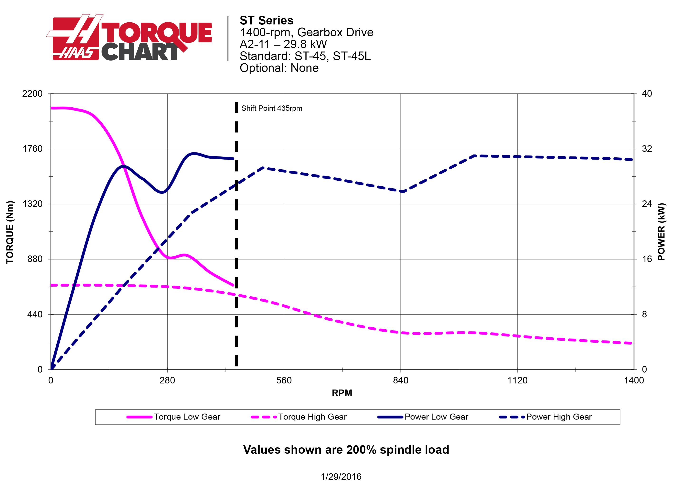

1400-rpm Spindle
    CNY ONLY
Standard spindle for the ST-45/L
  • 1.4k speed
  • A2-11 Nose
  • 40 hp Power
  • Gearbox drive
  • Option Info
  • Torque CHart

This 1400-rpm spindle features a 2-speed gearbox and a 7.0" through-bore. It provides a good combination of torque and rpm for a wide selection of machining operations on large parts.
  • Large spindle bore for greater part capacity
  • 2-speed gearbox provides plenty of torque for demanding applications at low surface speeds
  • Large-size bearings for rigidity and thermal stability

  • The following charts are for reference only.
  • These power numbers are based on 240V service, supplied at the required amperage.
  • Actual results may vary depending on the supplied power and the operating conditions.
  • Haas spindles will provide these peak power numbers (which equate to 200% spindle load) for 3 minutes,
    150% spindle load (75% of the peak number) for 10 minutes, 100% spindle load (50% of the peak number) continuously.
