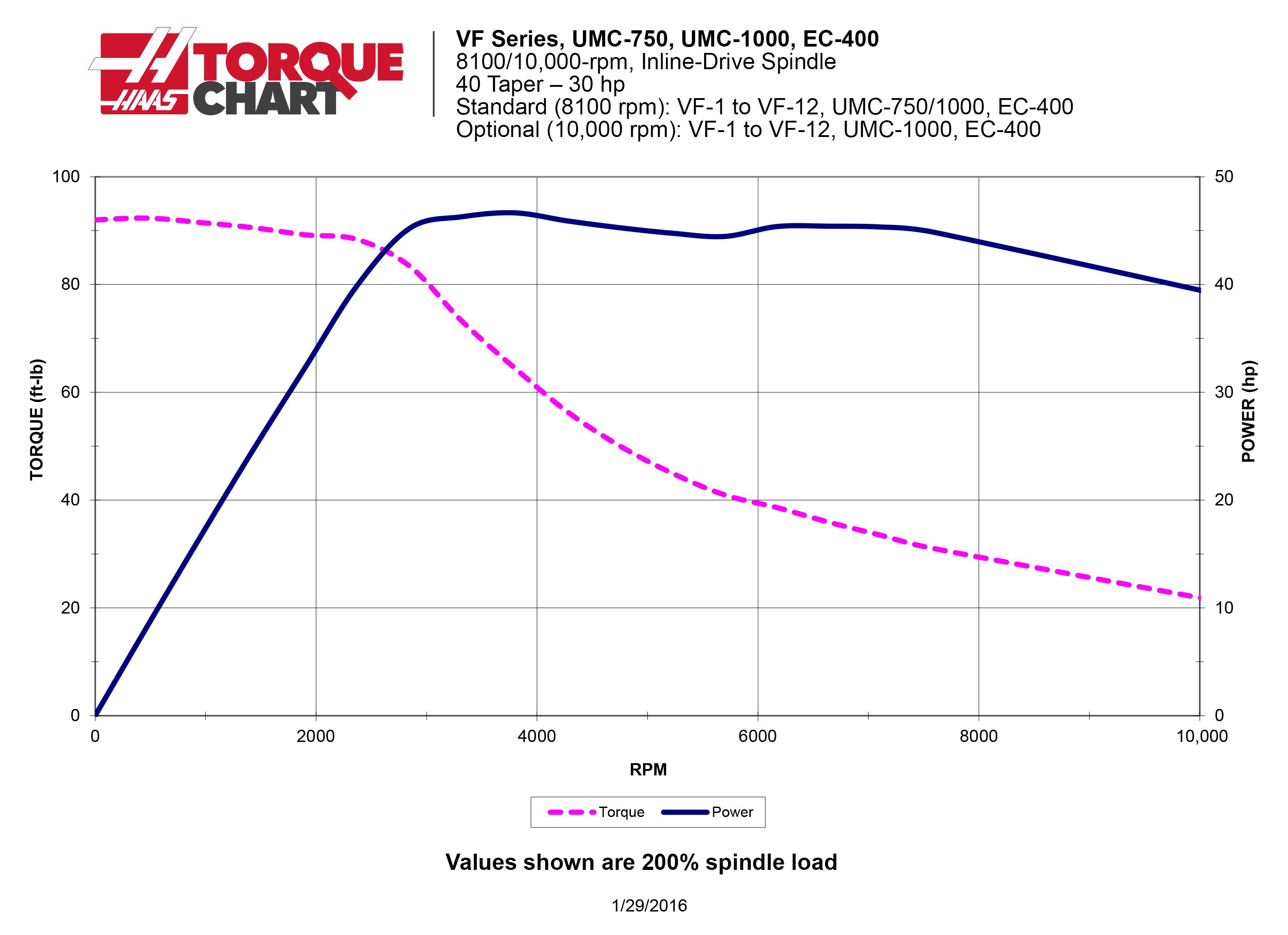

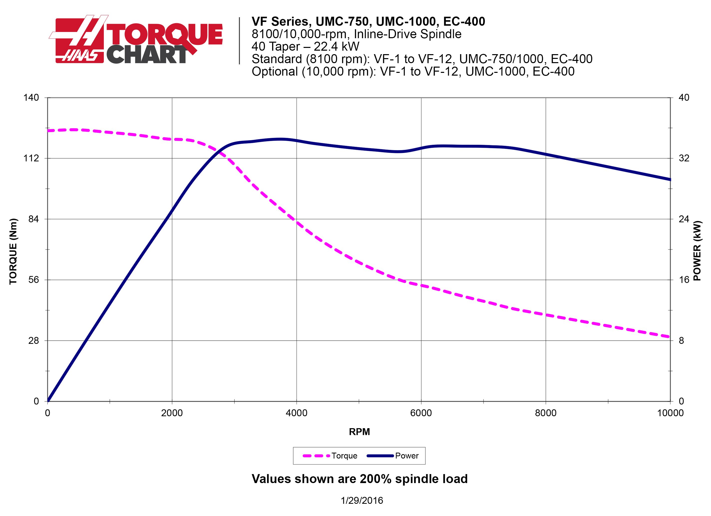

This 8100-rpm spindle is outstanding for all-purpose machining work. This standard spindle for the VF and EC Series mills provides high rpm without sacrificing low-speed torque or high-speed power. The inline spindle is quiet and very powerful.
  • Inline direct-drive spindle
  • Versatile combination of speed and power for all-purpose machining
Service Documents
Note:
  • The following charts are for reference only.
  • These power numbers are based on 240V service, supplied at the required amperage.
  • Actual results may vary depending on the supplied power and the operating conditions.
  • Haas spindles will provide these peak power numbers (which equate to 200% spindle load) for 3 minutes,
    150% spindle load (75% of the peak number) for 10 minutes, 100% spindle load (50% of the peak number) continuously.
