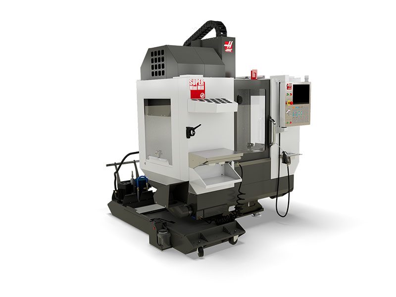

Super-Speed Mini Vertical Mill with 16" x 14" x 15" travels
The completely redesigned Super Mini Mill is enhanced with all-new FEA-optimized base and column castings, larger travels, a side-mount tool changer, and fast spindle speeds and rapids for increased production output. An all-new Y-axis washdown nozzle improves chip flow inside the machine, and a new 45-gallon (170-liter) external coolant tank simplifies maintenance. The new Super Mini Mill is perfect for high-production shops where space is limited, and easily interfaces with Haas robot packages or the Compact APL for fast, easy automation.
See Available Stock
Current Lead Time
  • 40 Taper
  • 3 Axis
  • 10k RPM
  • 30+1 Tool Capacity
Compare Machines
EXPLORE ALL INVENTORY
Contact Distributor
Compare Machines
BUILD & PRICE
Contact Distributor
  • Build-&-Price
  • Specs
  • Automation
  • Machine Info
