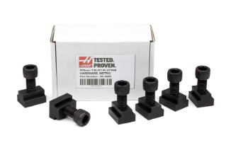

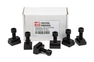

          ZESTAWY OSPRZĘTU I ZACISKÓW DOLNYCH Z ROWKIEM TEOWYM 14 MM DOSTĘPNE W SKLEPIE HAASTOOLING.COM
