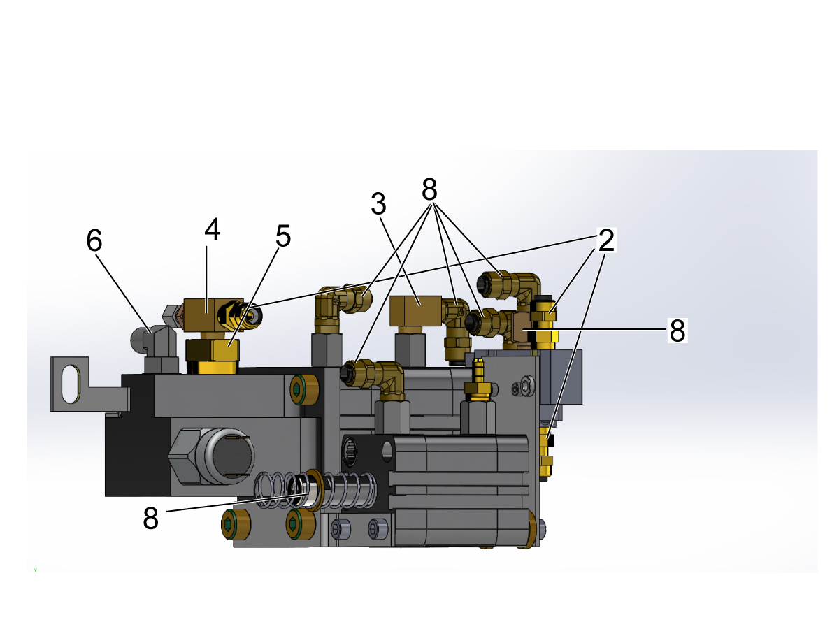

- Bölüme Geç - 1. Solenoid Assemblies Back to Top

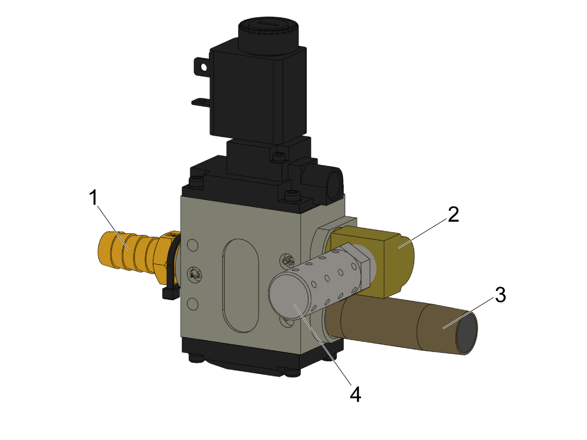

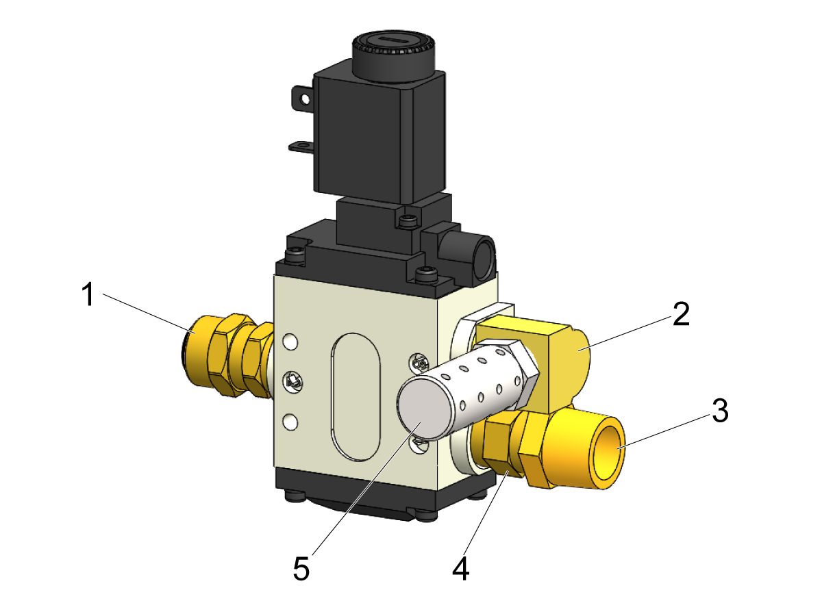

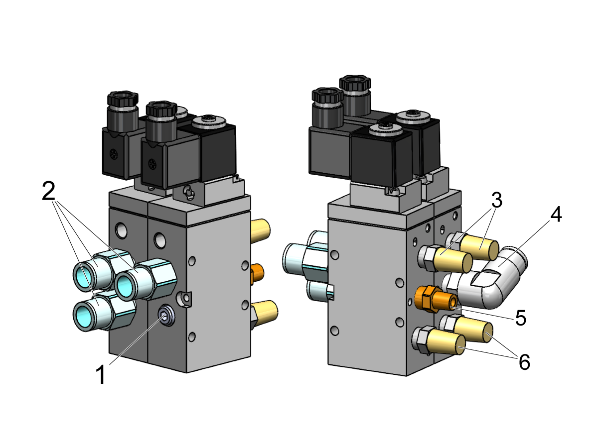

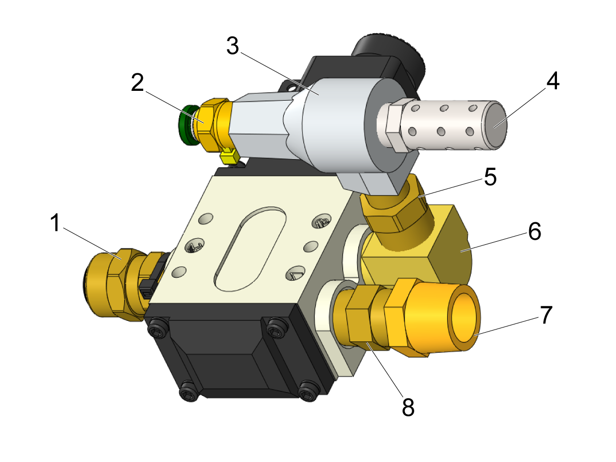

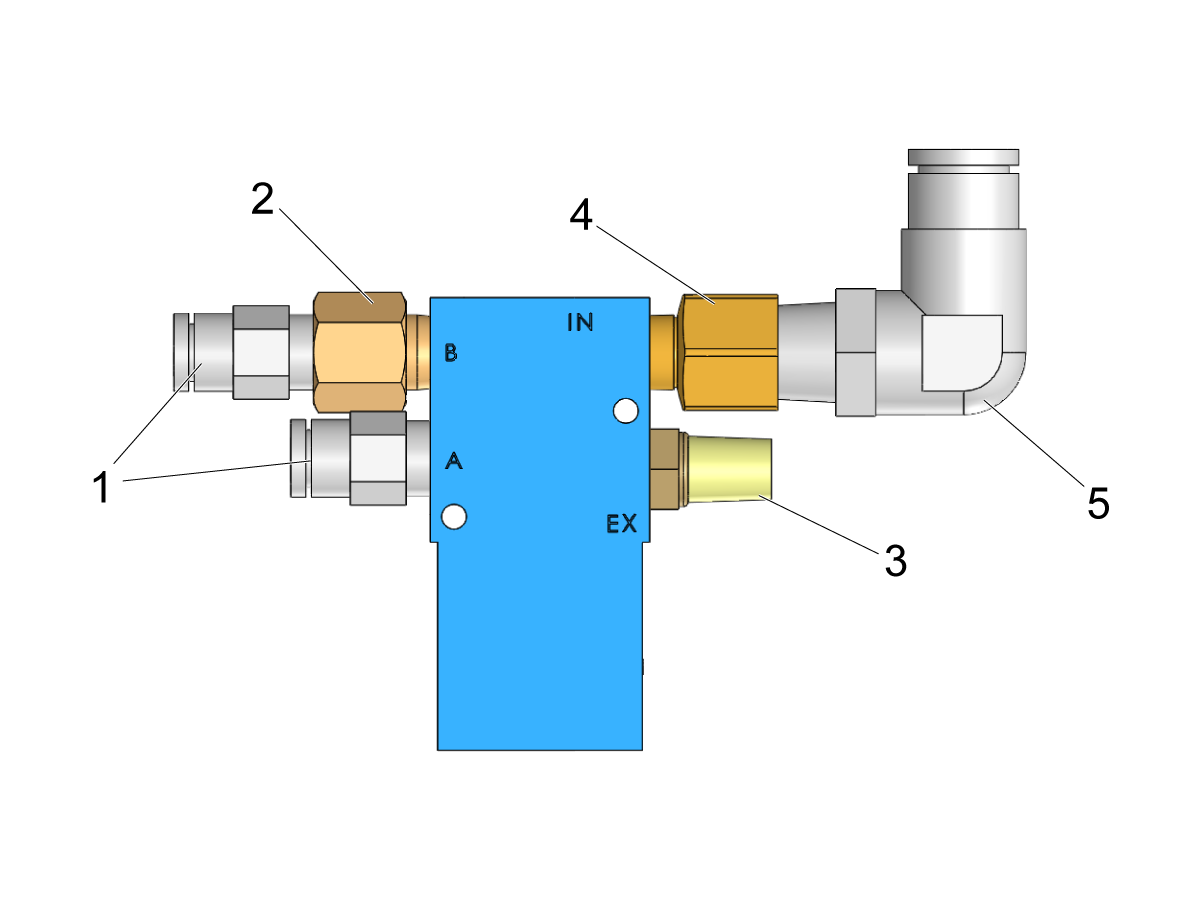

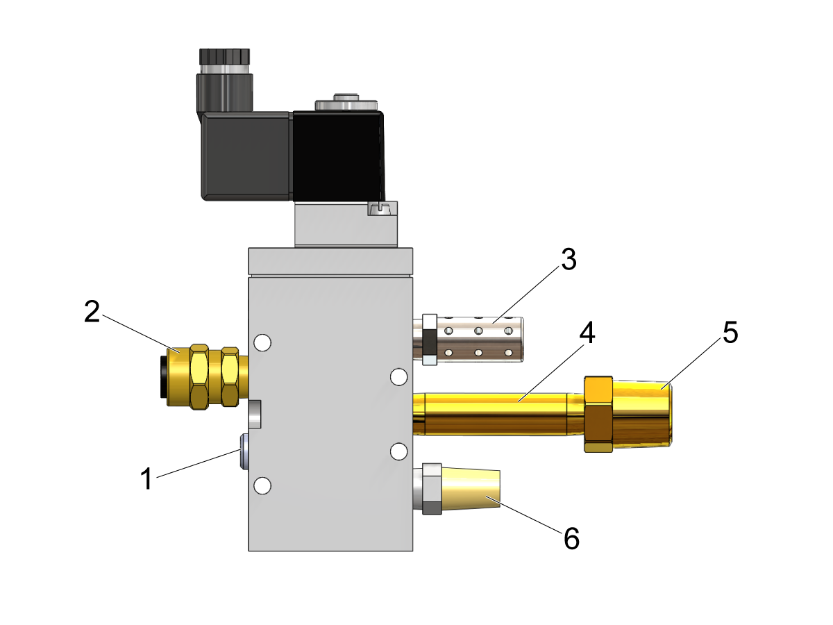

Solenoid Assemblies
93-30-0389 Festo
  1. 58-0562 FITG LBO1/4 NPT1/8M STR
  2. 58-2255 FITG NPT1/8M NPT1/8F ORIFICE .250 STR
  3. 58-0093 FITG NPT1/8F NPT1/8M ORIFICE .081 STR
  4. 58-2262 AIR MUFFLER NPT-1/8-M EXTENDED BRONZE
  5. 58-3685 FITG REDUCER NPT1/4F NPT1/8M STR BRASS
  6. 58-3657 FITG REDUCER NPT1/4F NPT1/8M STR BRASS
  7. 32-5660 SINGLE 40T SMTC SOL ASSY
93-30-0389 MAC
  3. 58-2262 AIR MUFFLER NPT-1/8-M EXTENDED BRONZE
  4. 58-3657 FITG REDUCER NPT1/4F NPT1/8M STR BRASS
  5. 58-3685 FITG LBO 3/8 X NPT 1/4M 90 STL

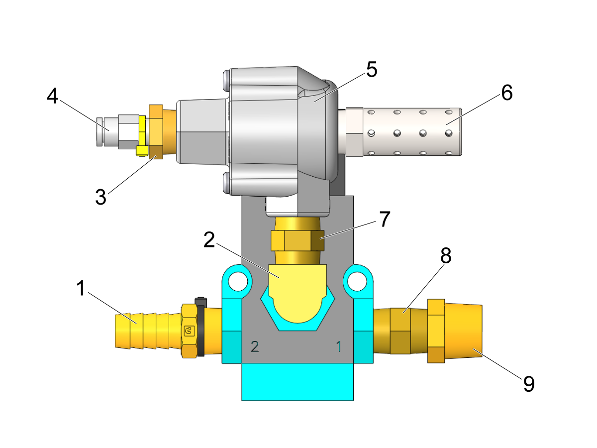

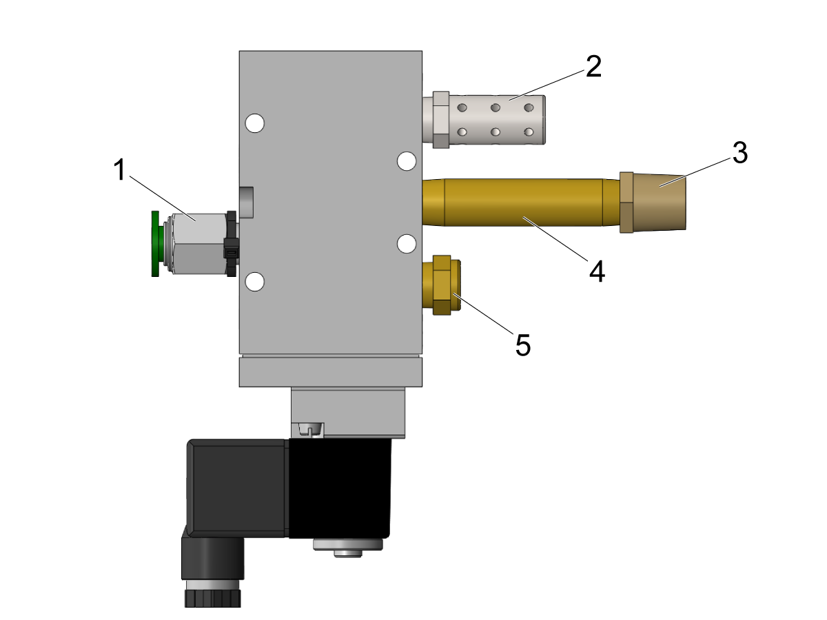

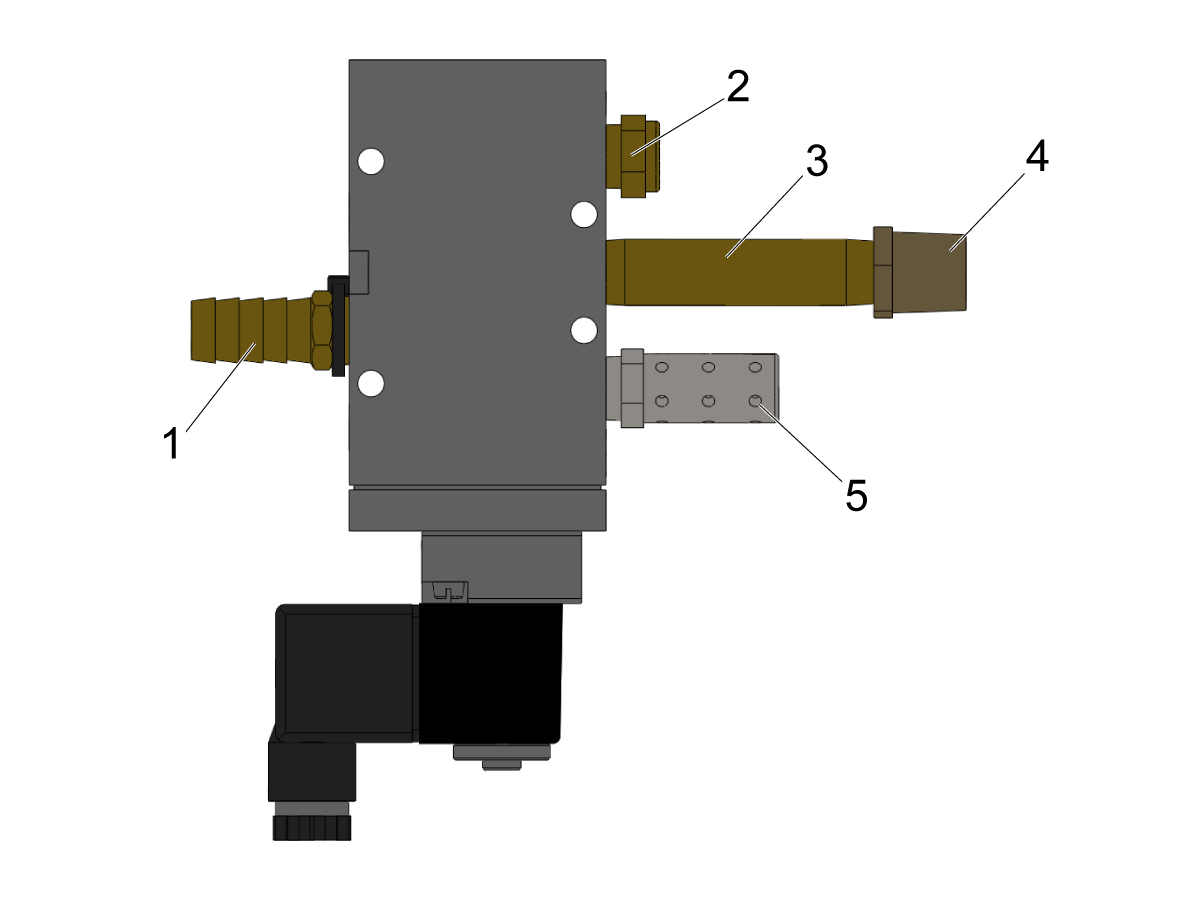

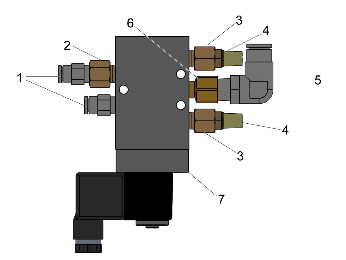

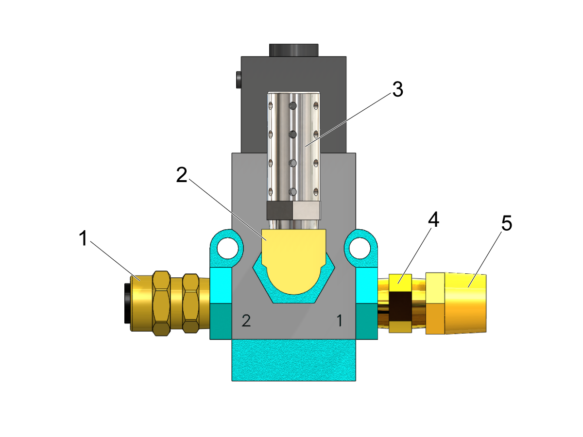

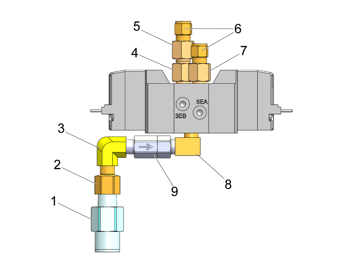

93-30-4170 Festo
  1. 58-0234 FITG PC1/2F NPT1/4M STR STL
  2. 58-1861 FITG NPT1/4M MUFFLER FREE FLOW
  3. 58-1697 FITG REDUCER NPT1/2F NPT1/4M STR BRASS
  4. 58-1081 FITG JIC10M NPT1/2M STR STL
  5. 58-0546 SILENCER 40DB HIGH NOISE REDUCTION
  6. 58-7637 FITG LBO-5/16 X NPT-1/8-M STR
  7. 58-2069 FITG NPT1/8F NPT1/8M ORİFİS .0625 STR
  8. 58-3670 FITG REDUCER NPT1/4M NPT1/8F BRASS
93-30-4170 MAC
  1. 58-1693 FITG LBO 1/2 X 3/8 NPT-M STR
  2. 58-2269 AIR MUFFLER 3/8 NPT M
  3. 58-0766 FITG 3/8 M X 1/2 F NPT
  4. 58-1081 FTG JIC 10 M X 1/2 NPT F
  5. 58-0546 SILENCER 40 dB HIGH NOISE REDUCTION
  6. 58-7637 FITG LBO 5/16 X 1/8M NPT
  7. 58-0091 ORIFICE 1/8NPT X .060 VIBRA SEAL
  8. 58-3664 FITG REDUCER 3/8 M X 1/8 F NPT

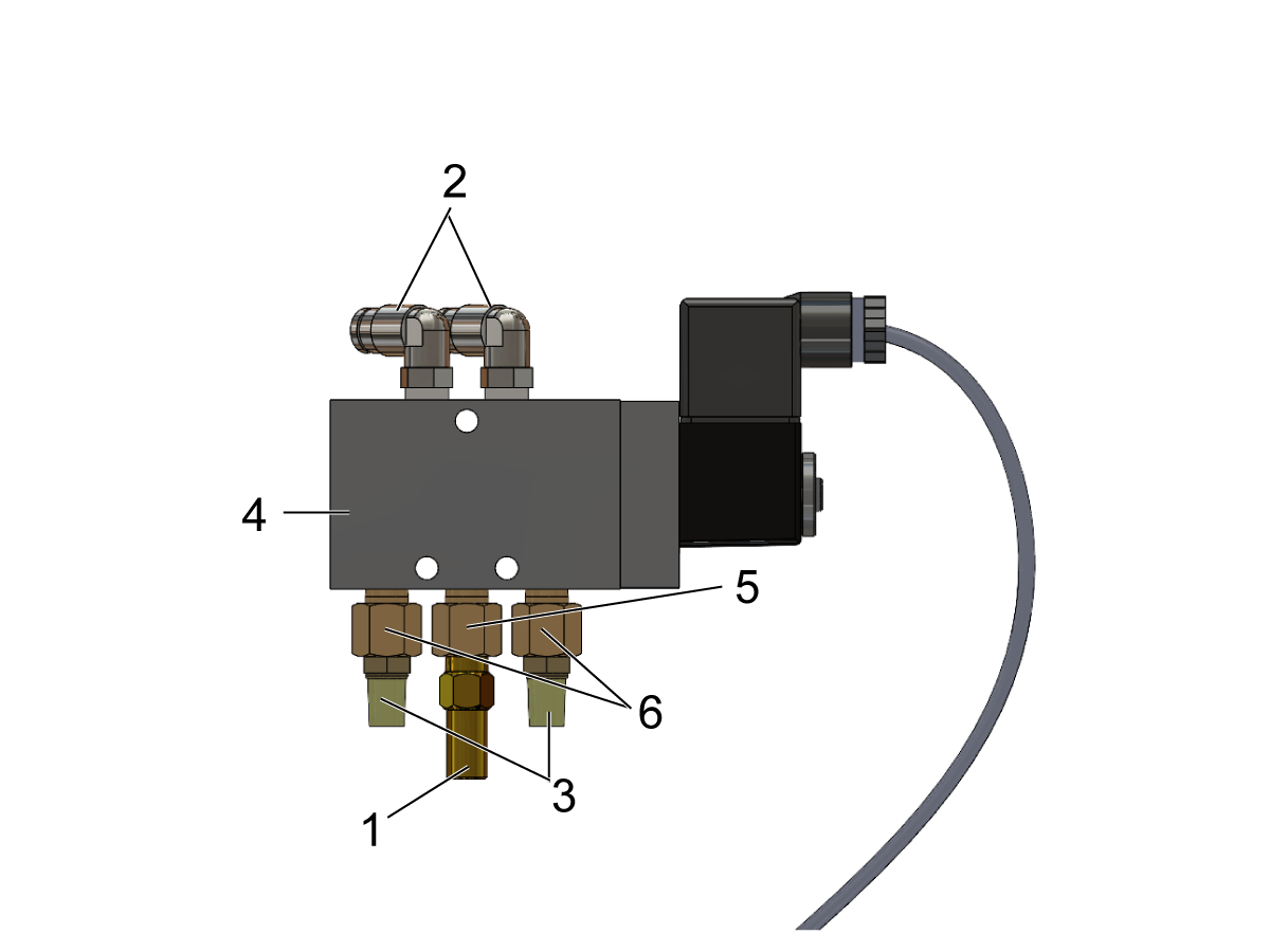

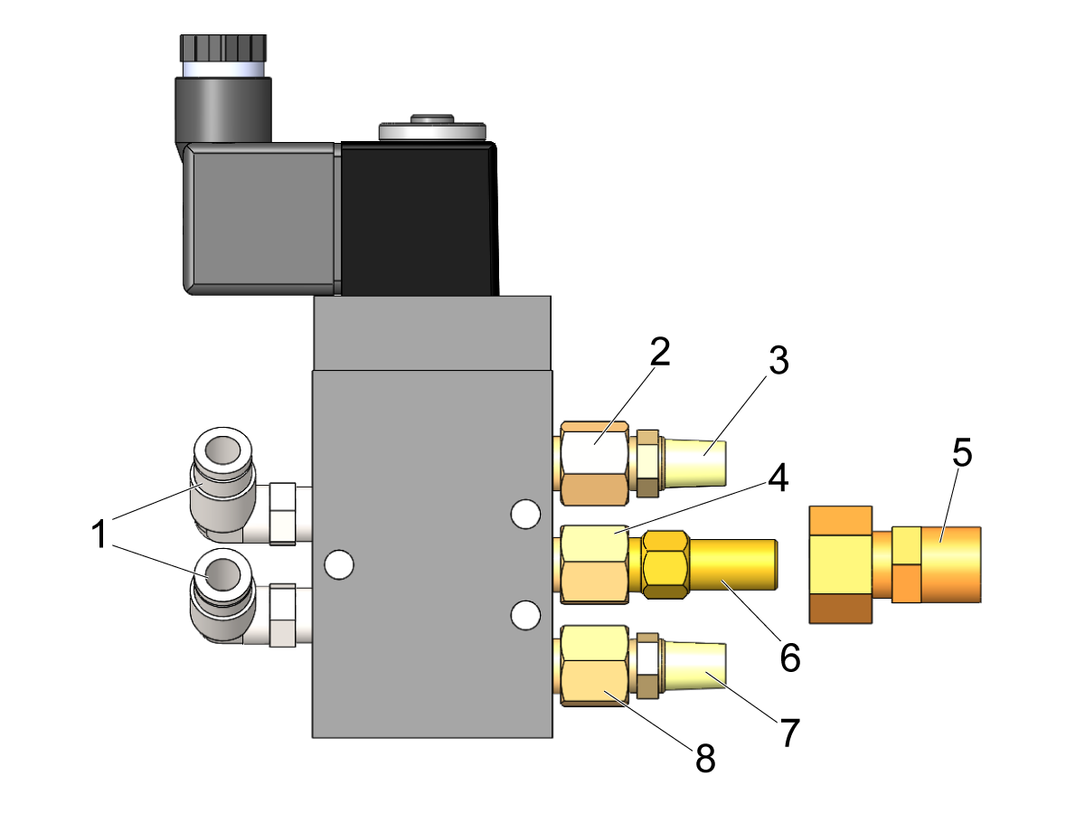

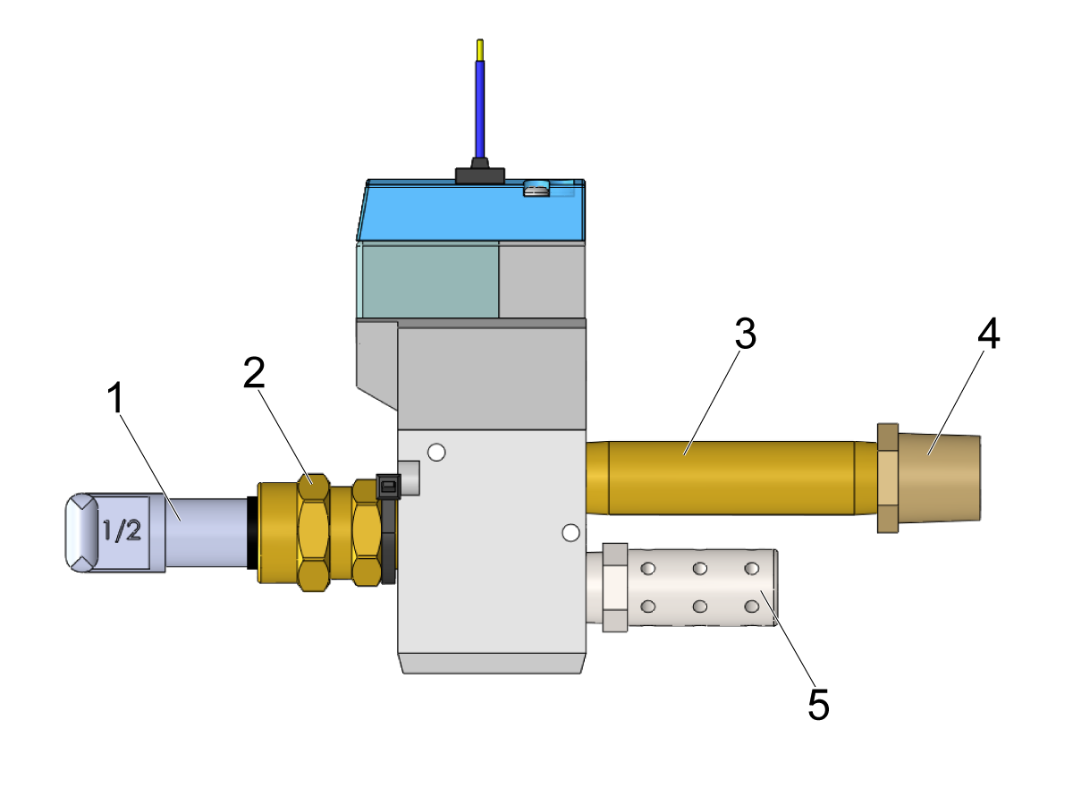

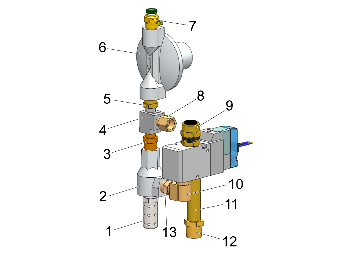

93-30-6650 Festo
  1. 58-3670 FITG REDUCER NPT1/4M NPT1/8F BRASS
  2. 58-3050 FITG PC1/4F NPT1/8M 90 STL
  3. 58-3065 AIR MUFFLER NPT-1/4-M EXTENDED BRONZE
  4. 58-0231 FITG PC1/2F NPT1/4M STR STL

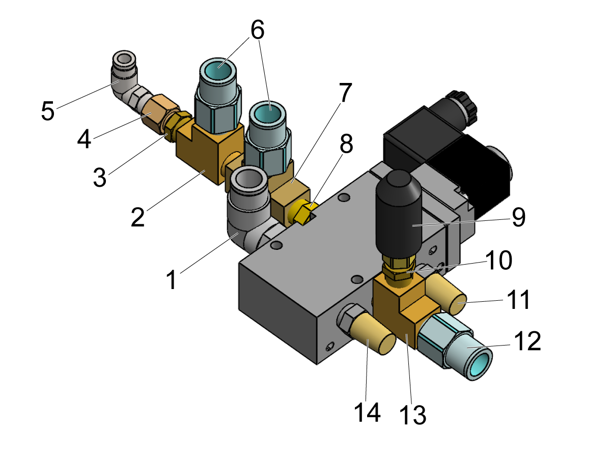

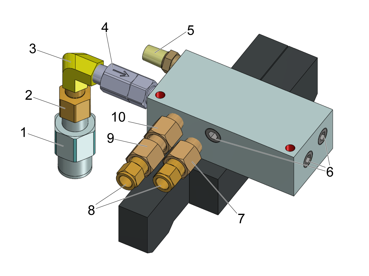

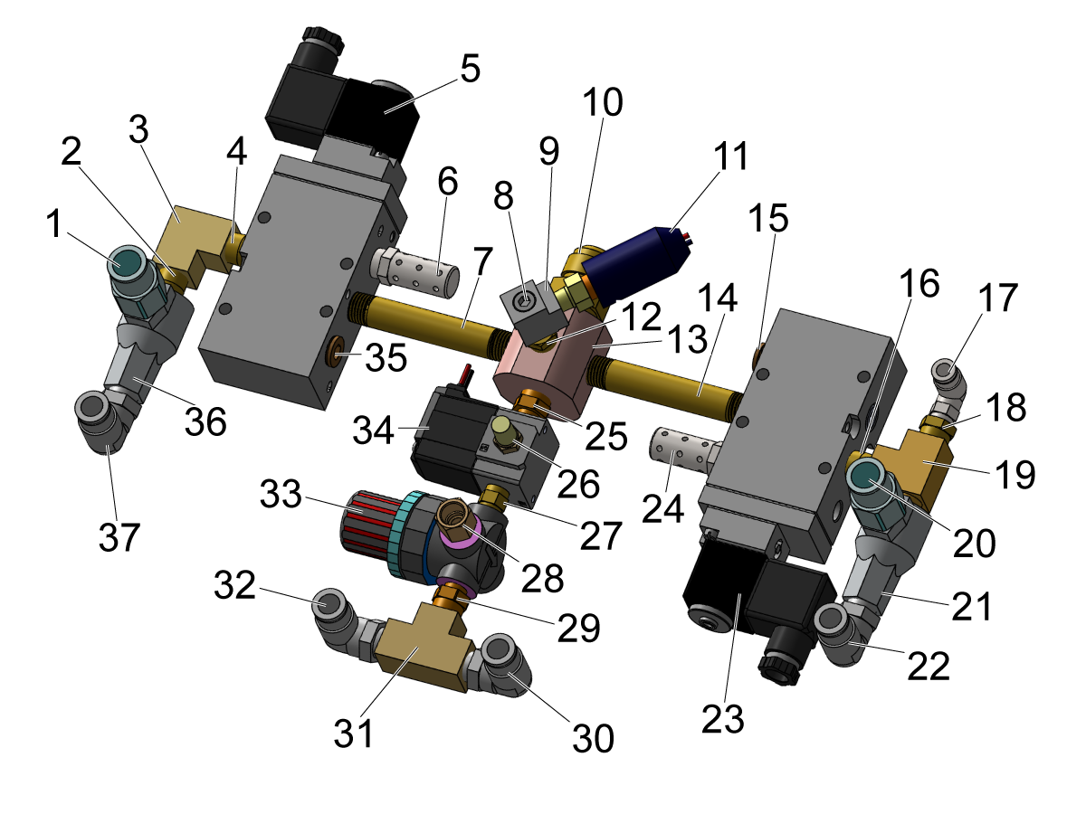

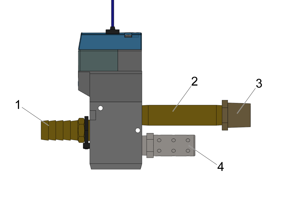

93-30-6774B Festo / SMC
  1. 58-3105 FITG NPT1/4M PLUG STL
  2. 58-3685 FITG LBO 3/8 X NPT 1/4M 90 STL
  4. 36-5630A AIR DUMP SOL ASSY EC-400
  5. 58-3001 FITG NPT1/4M NPT1/4F NPT1/4F TEE BRASS
  6. 58-3670 FITG REDÜKTÖR NPT1/4M NPT1/8F PİRİNÇ
  7. 58-3050 FITG PC1/4F NPT1/8M 90 STL
  8. 58-3105 FITG NPT1/4M PLUG STL
  9. 36-5620B LIFT PROTECT SOL ASSY EC-400
  10. 58-3050 FITG PC1/4F NPT1/8M 90 STL
  11. 58-1627 FITG NPT1/8M PLUG STL W/THREAD SEALANT
  12. 58-1674 FITG REDUCER NPT1/4M NPT1/8M STR BRASS

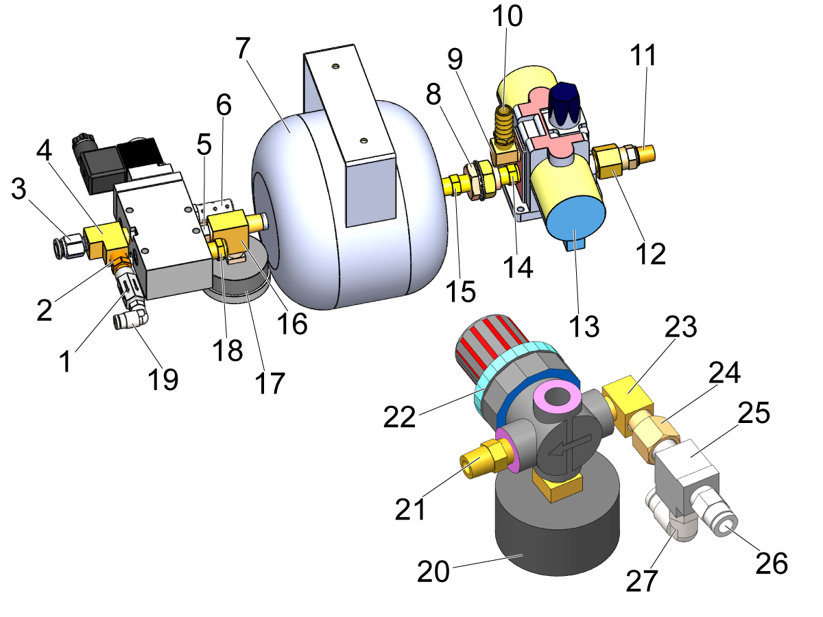

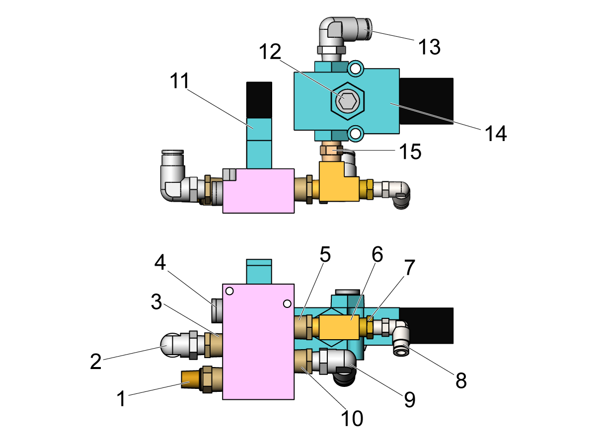

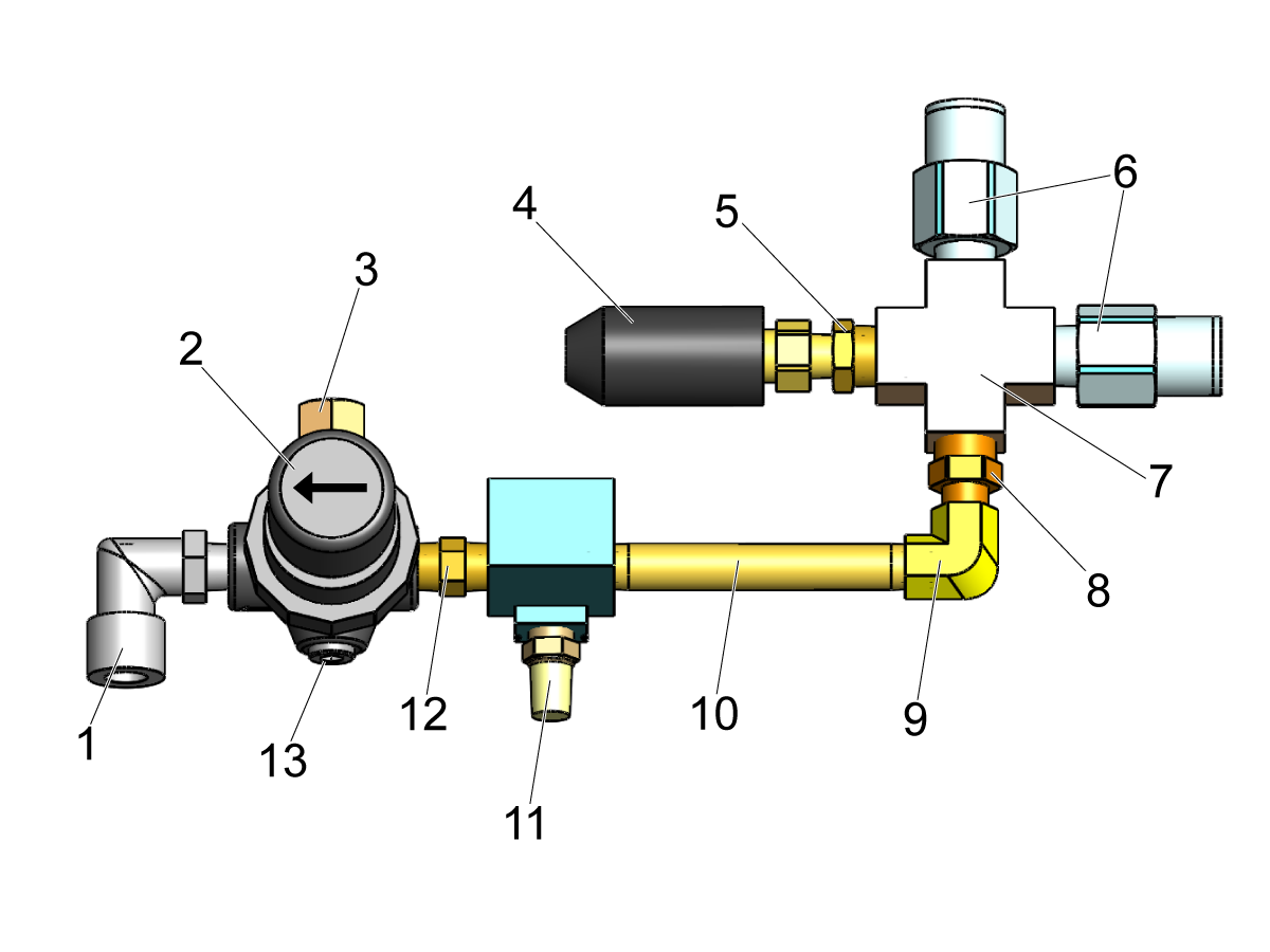

93-30-6774B MAC / MAC
  1. 58-2269 AIR MUFFLER NPT-3/8-M EXTENDED BRONZE
  3. 58-3665 FITG REDUCER NPT3/8M NPT1/4F BRASS
  4. 58-0336 FITG NPT 3/8M PLUG STL
  5. 58-3665 FITG REDUCER NPT3/8M NPT1/4F BRASS
  6. 58-3001 FITG NPT1/4M NPT1/4F NPT1/4F TEE BRASS
  7. 58-3670 FITG REDUCER NPT1/4M NPT1/8F BRASS
  8. 58-3050 FITG PC1/4F NPT1/8M 90 STL
  9. 58-3685 FITG LBO 3/8 X NPT 1/4M 90 STL
  10. 58-3665 FITG REDUCER NPT3/8M NPT1/4F BRASS
  11. 36-5630A AIR DUMP SOL ASSY EC-400
  12. 58-0336 FITG NPT 3/8M PLUG STL
  13. 58-3685 FITG LBO 3/8 X NPT 1/4M 90 STL
  14. 36-5620B LIFT PROTECT SOL ASSY EC-400
  15. 58-3690 NIPPLE 1/4 NPT X 1 1/8 HEX BRASS

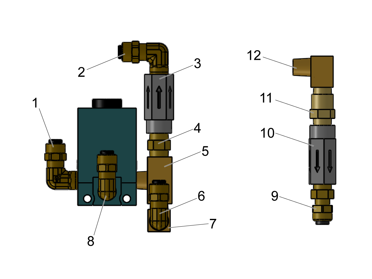

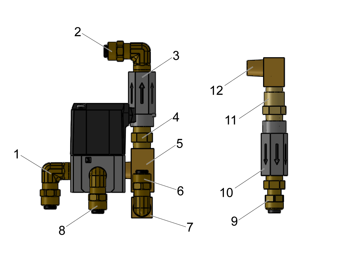

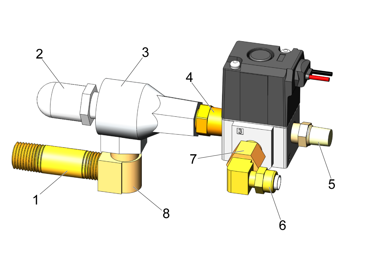

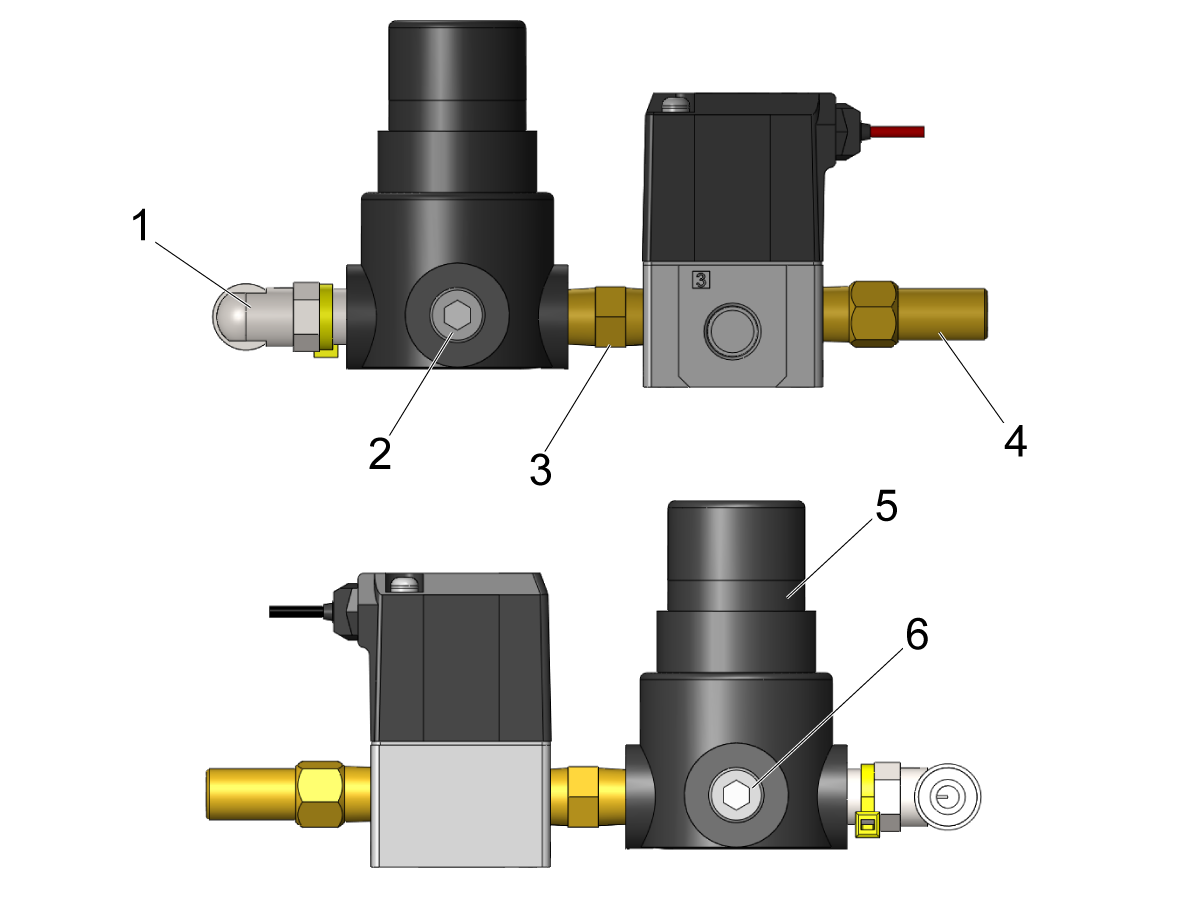

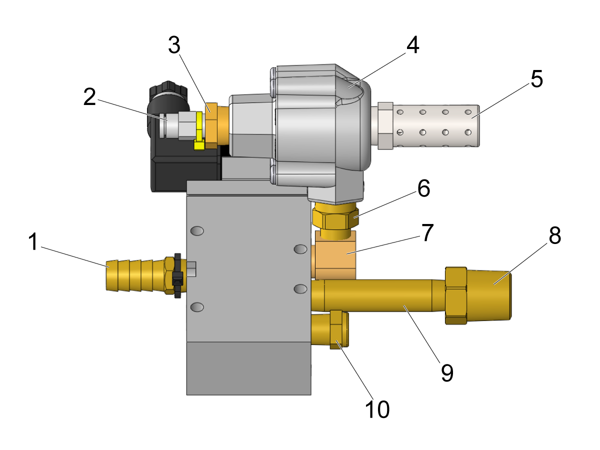

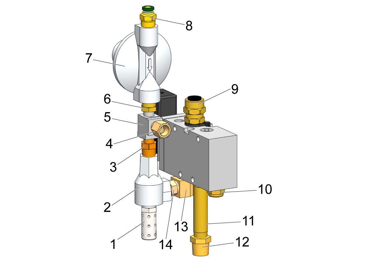

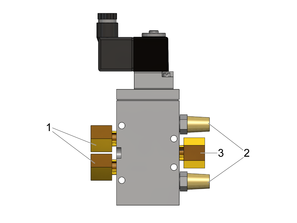

93-30-8058 MAC
  1. 58-3075 FITG POLY1/4F NPT1/8M 90 BRASS
  2. 58-3075 FITG POLY1/4F NPT1/8M 90 BRASS
  3. 58-2754 VALVE CHECK NPT-1/8-F X NPT-1/8-F BRASS
  4. 58-16732 NIPPLE 1/8 NPT X 1 HEX BRASS
  5. 58-2743 FITG NPT1/8F NPT1/8M NPT1/8F TEE BRASS
  6. 58-16700 FITG NPT1/8F NPT1/8M 90 BRASS
  7. 58-3075 FITG POLY1/4F NPT1/8M 90 BRASS
  8. 58-3075 FITG POLY1/4F NPT1/8M 90 BRASS
  9. 58-16706 FITG POLY1/4F NPT1/8M STR BRASS
  10. 58-2754 VALVE CHECK NPT-1/8-F X NPT-1/8-F BRASS
  11. 58-2751 VALVE CHECK NPT-1/8-M X NPT-1/8-M BRASS
  12. 58-16700 FITG NPT1/8F NPT1/8M 90 BRASS
93-30-8058 SMC

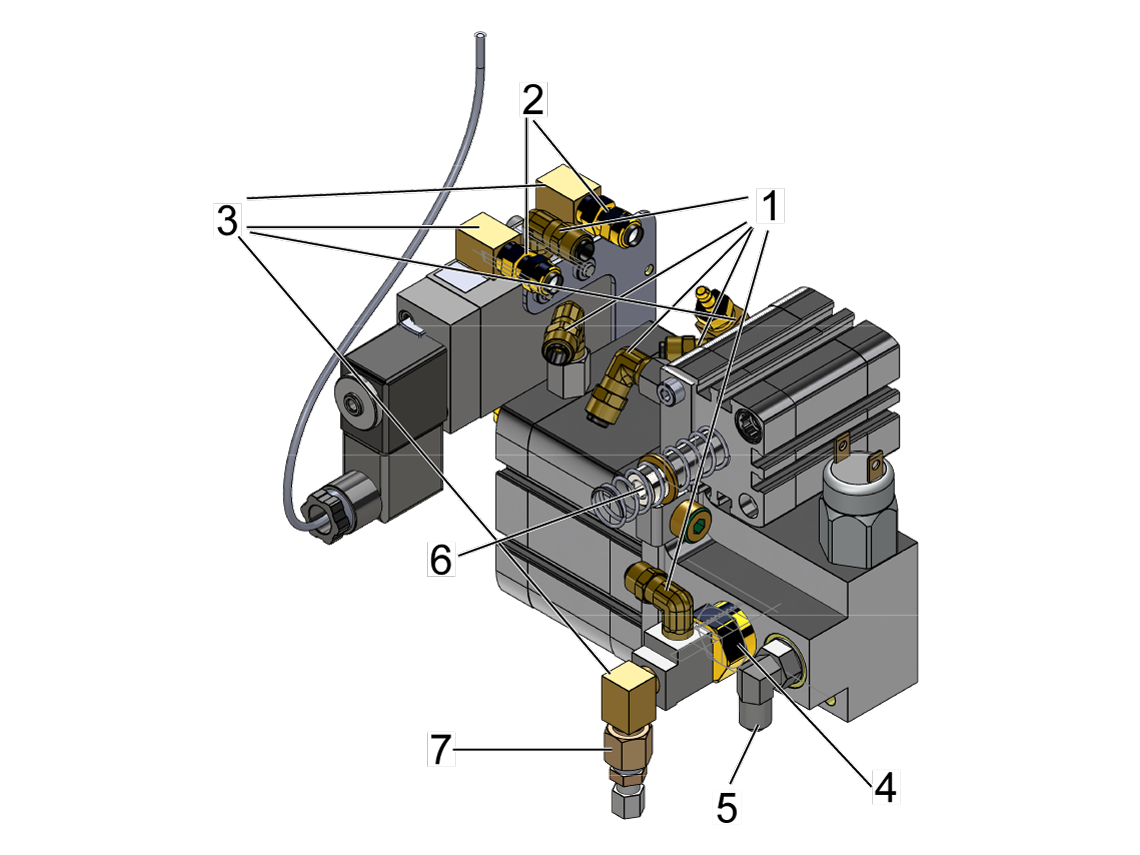

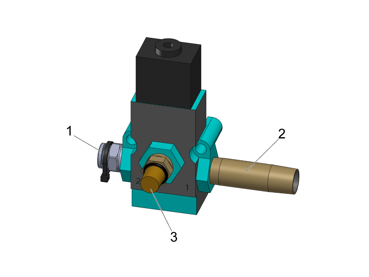

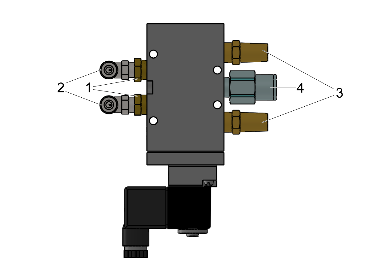

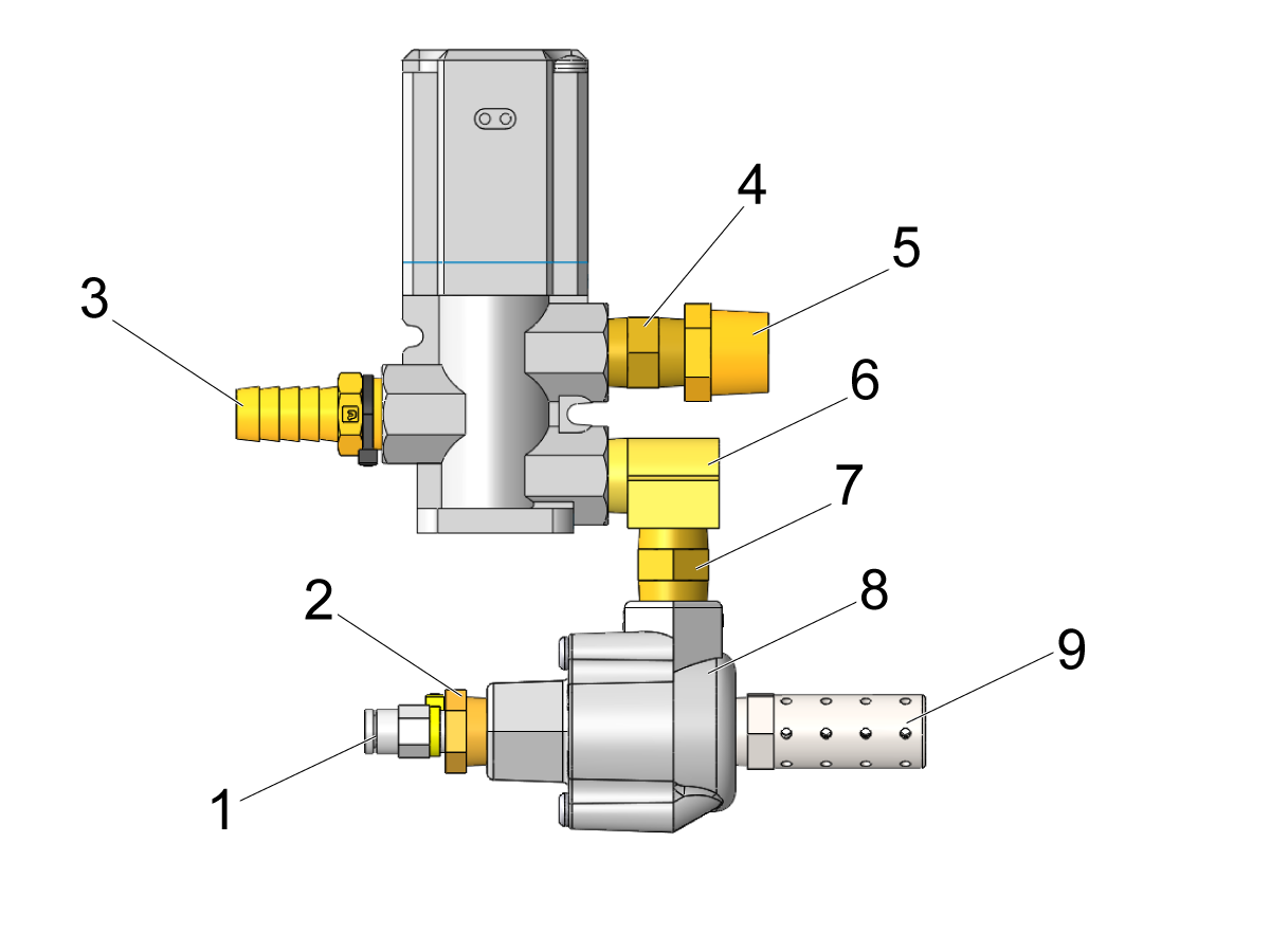

93-30-11053 MAC
  1. 58-1674 FITG NPT 1/8-M X 1/4-M
  2. 58-2754 VALVE CHECK NPT 1/8-F X 1/8-F
  3. 58-3614 FITG NPT 1/8-M X 1/4-F 90
  4. 58-1386 SUSTURUCU FLUSH NPT 1/8-M
  5. 58-3050 FITG PC1/4F NPT1/8M 90 STL
  6. 20-5630 MEME UCU HEX 1/8 NPTM X 3/8 PÜRÜZSÜZ
  7. 58-3617 FITG COMP 3/8 X 1/4 MNPT 90 BR
93-30-11053 SMC
  4. 58-3050 FITG PC1/4F NPT1/8M 90 STL
  5. 20-5630 MEME UCU HEX 1/8 NPTM X 3/8 PÜRÜZSÜZ
  6. 58-3617 FITG COMP 3/8 X 1/4 MNPT 90 BR

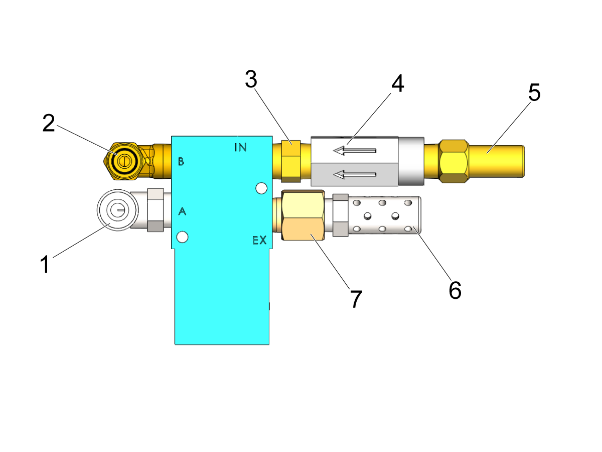

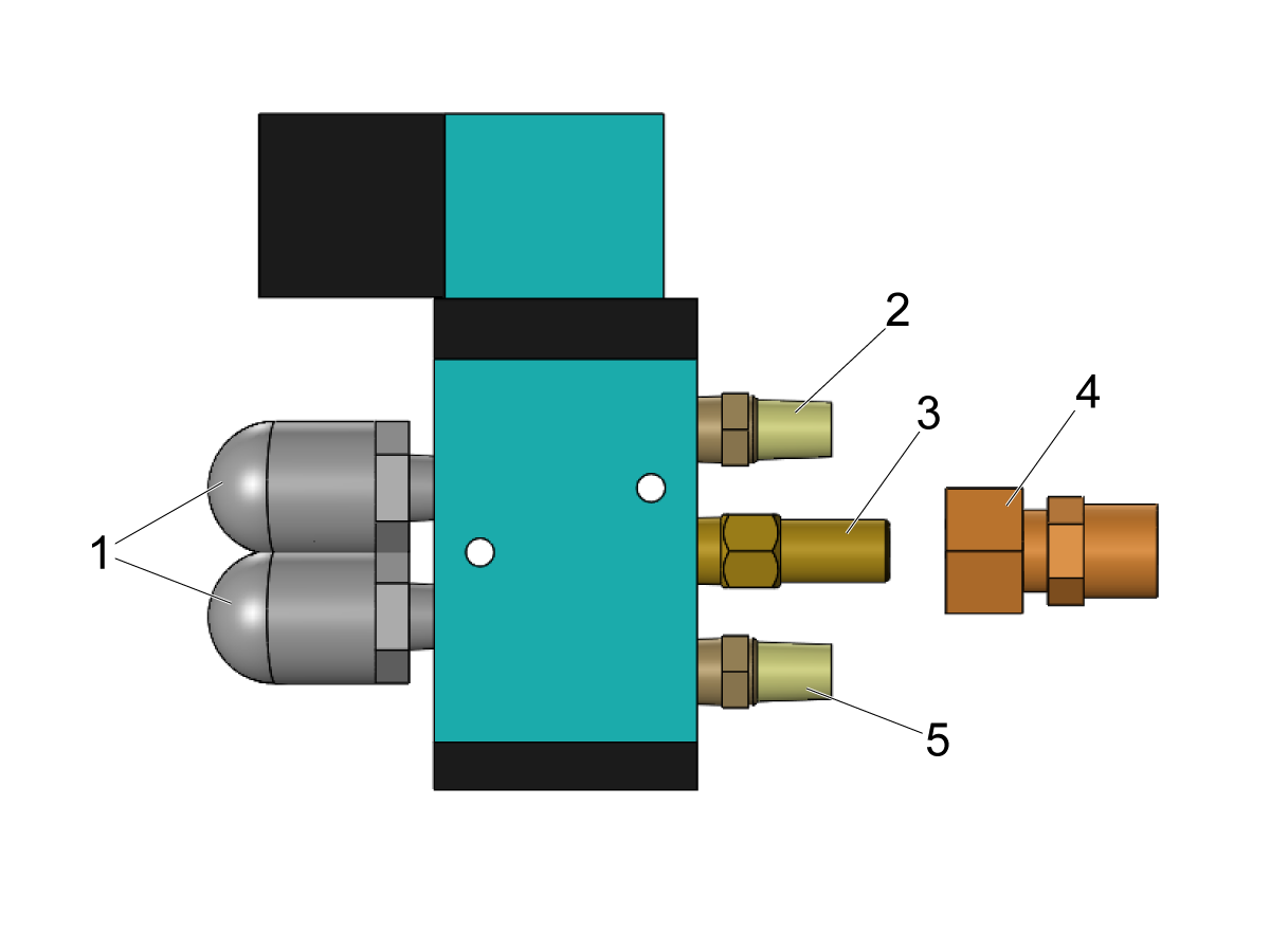

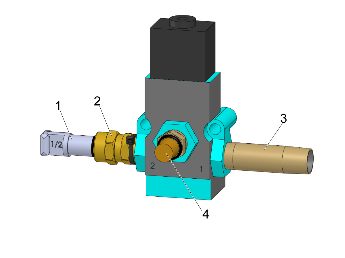

93-30-11061 Festo
  2. 58-1574 FITG POLY1/2F NPT1/4M STR BRASS
  3. 58-1861 FITG, MUFFLER NPT 1/4M FREE FLOW
  4. 58-0742 NIPPLE 1/4 NPT X 3 BR
  5. 58-16751 FITG, RED NPT-1/2-M X NPT-1/4-F
  6. 58-3069 AIR MUFFLER NPT1/4M EXTENDED BR
93-30-11061 MAC
  1. 58-0915 FITG POLY1/2F NPT3/8M STR BR
  2. 58-1722 FITTING, NPT3/8M NPT3/8F 90 BR
  3. 58-1381 MUFFLER FREE FLOW 3/8 NPTM
  4. 58-3600 NIPPLE, 3/8 NPT HEX BR
  5. 58-3625 FITG, REDUCER NPT1/2M NPT3/8F BR
93-30-11061 SMC
  2. 58-3600 NIPPLE, 3/8 NPT HEX BR
  3. 58-3625 FITG, REDUCER NPT1/2M NPT3/8F BR
  4. 58-1722 FITTING, NPT3/8M NPT3/8F 90 BR
  5. 58-1381 MUFFLER FREE FLOW 3/8 NPTM
93-30-11061 Numatik

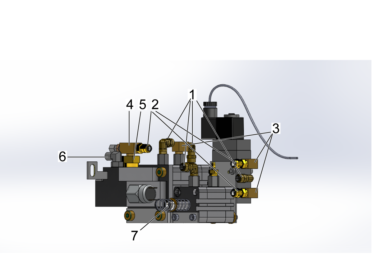

93-30-11079 Festo
  1. 58-3050 FITG PC1/4F NPT1/8M 90 STL
  2. 58-0093 FITG NPT1/8F NPT1/8M ORİFİS .081 STR
  4. 58-2255 FITG NPT1/8M NPT1/8F ORIFICE .250 STR
  5. 58-1521 FITG COMP 3/8 X 1/4 MNPT BR STR
  6. 20-5630 NIPPLE HEX 1/8 NPTM X 3/8 SMOOTH
  7. 58-2262 AIR MUFFLER NPT-1/8-M EXTENDED BRONZE
  8. 58-0093 FITG NPT1/8F NPT1/8M ORİFİS .081 STR
93-30-11079 MAC
  2. 20-5630 NIPPLE HEX 1/8 NPTM X 3/8 SMOOTH
  3. 58-1521 FITG COMP 3/8 X 1/4 MNPT BR STR
93-30-11254 MAC
  1. 58-3658 FITG PC3/8F NPT1/8M 90 STL
  2. 58-2262 AIR MUFFLER NPT-1/8-M EXTENDED BRONZE
  3. 20-5630 NIPPLE HEX 1/8 NPTM X 3/8 SMOOTH
  4. 58-1521 FITG COMP 3/8 X 1/4-M NPT BR STR
  5. 58-2262 AIR MUFFLER NPT-1/8-M EXTENDED BRONZE

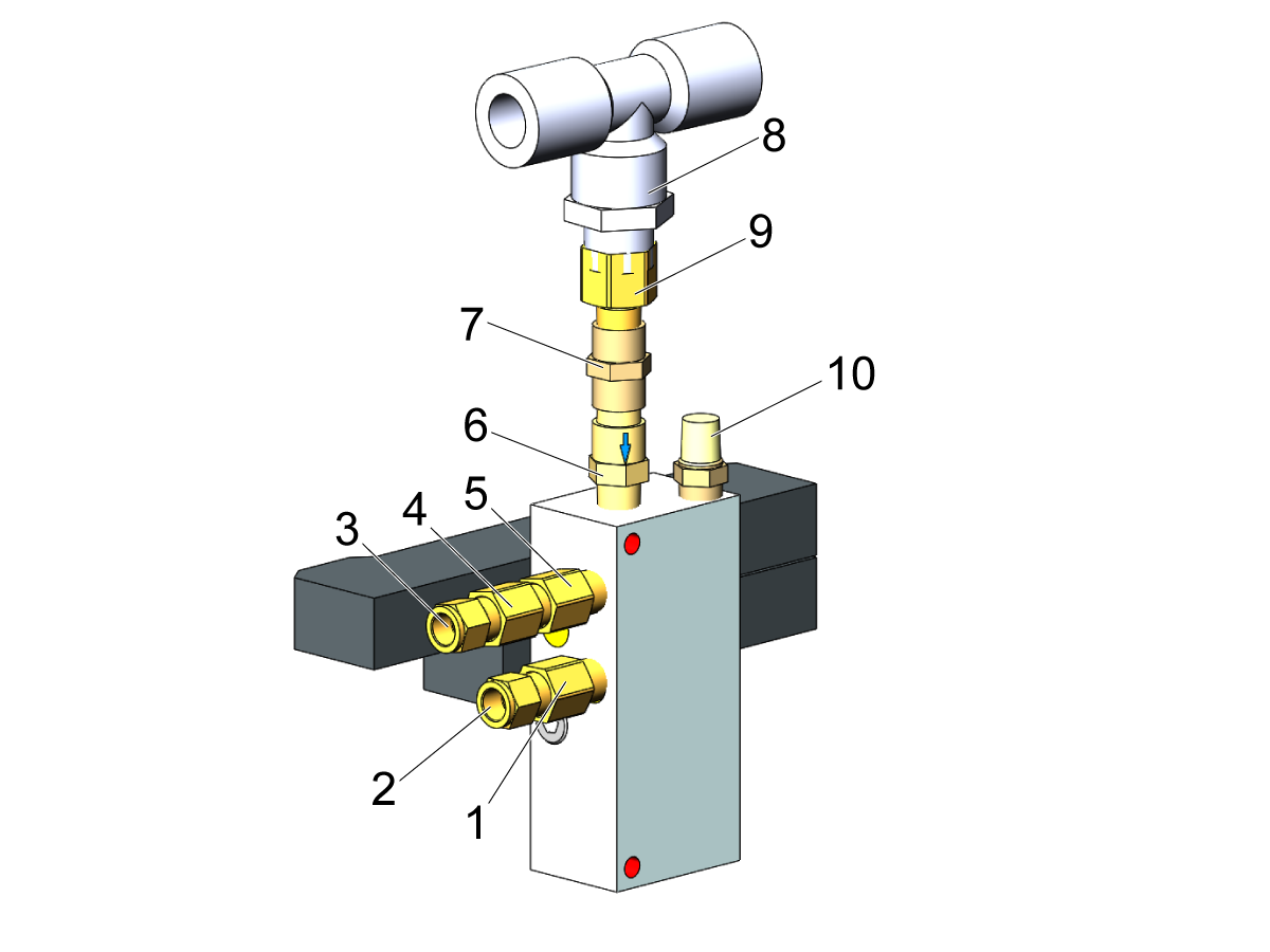

93-30-11431A MAC
  3. 58-3050 FITG PC1/4F NPT1/8M 90 STL
  5. 58-1853 CHECK VALVE NPT1/8M NPT1/8M STR BRASS
  7. 58-0254 FITG PC1/2F NPT1/4M 90 STL
  8. 58-2746 FITG NPT1/8F NPT1/8F STR BRASS
  9. 58-2262 AIR MUFFLER NPT-1/8-M EXTENDED BRONZE

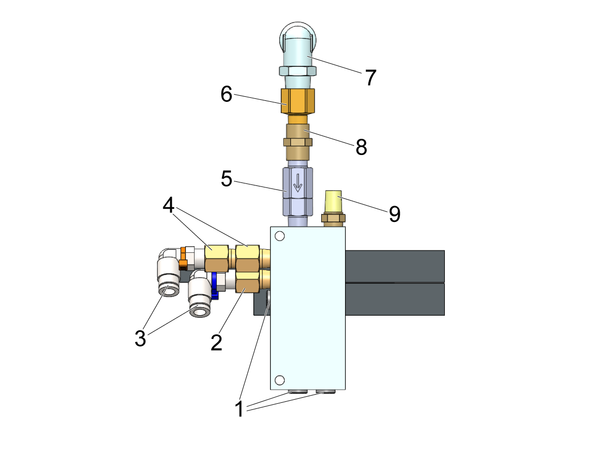

93-30-11431A SMC
- 01.04.2021 Öncesi Üretilmiş
  1. 58-2255 FITG NPT1/8M NPT1/8F ORIFICE .250 STR
  3. 58-2255 FITG NPT1/8M NPT1/8F ORIFICE .250 STR
  4. 58-16700 FITG NPT1/8F NPT1/8M 90 BRASS
