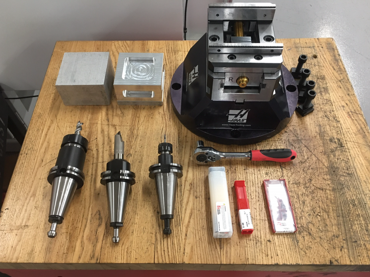

Mill - Chatter - Test Cut Procedure - Equipment List
Part Number Quantity Description
99-05-0090 1 Haas Riser For 5" Self Centering Vise
99-05-0004 1 5" Manual Self Centering Vise
99-03-0573 2 ½” End Mill 3 Flute With .030" Radius
99-01-0159 1 45 Degree Small Chamfer Mill
99-02-0505 1 Small Chamfer Mill Insert
99-04-0004 1 CAT40 ¾” End Mill Holder
99-04-0011 1 CAT40 ER32 Collet Chuck 4” Gage Length
99-04-0006 1 CAT40 ER16 Collet Chuck 2.5” Gage Length
99-04-0200 1 CAT40 Solid Pull Stud (10 pack)
99-04-0250 1 ER-32 Collet 13
99-04-0218 1 ER-16 Collet 4
99-03-2088 2 1/8” Ball End Mill
N/A 1 6061 Aluminum 3 Inch x 3 Inch Bar Cut To 0.75 Inch
Mill - Chatter - Test Cut Procedure - Tool List

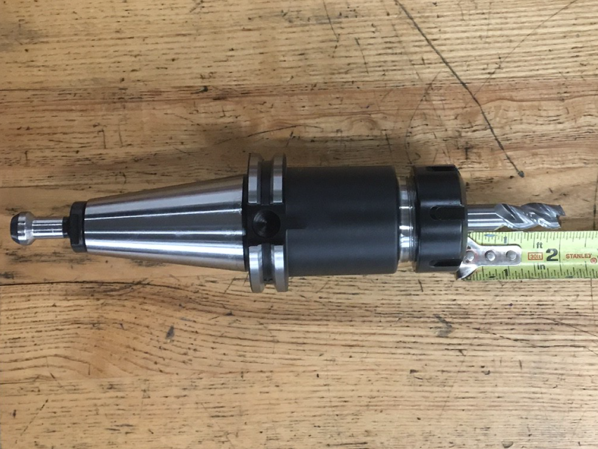

Tool Number 1:
Cutter Type: ½” End Mill 3 Flute with .030" Radius
Holder Type: ER Collet
RPM: 10,000
Number of  Flutes: 3
Minimum Working Length: 1.9"
Haas Tool PN: 03-0573
Haas Tool Holder PN: 04-0011
Haas Collet PN: 04-0250
Haas Insert PN: N/A
Tool Number 2:
Cutter Type: ” ¾” Chamfer Tool
Holder Type: Weldon
RPM: 10,000
Number of  Flutes: 1
Minimum Working Length: 2.75"
Haas Tool PN: 01-0159
Haas Tool Holder PN: 04-0200
Haas Collet PN: N/A
Haas Insert PN: 02-0505

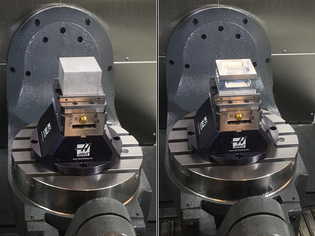

Mill - Chatter - Test Cut Procedure - Setup
A vise of their choice.
The outside profile is .500” deep so they should grip on .150-.200”,  .200” is max.
Set G54 Offset:
Bolt the vise to the center of the table as show in photo. Part center must be within 2 inches of the center of the table.
  • Set tool offsets off top of material
  • Set G54 X0 Y0 to center of material
  • Set G54 Z = Zero

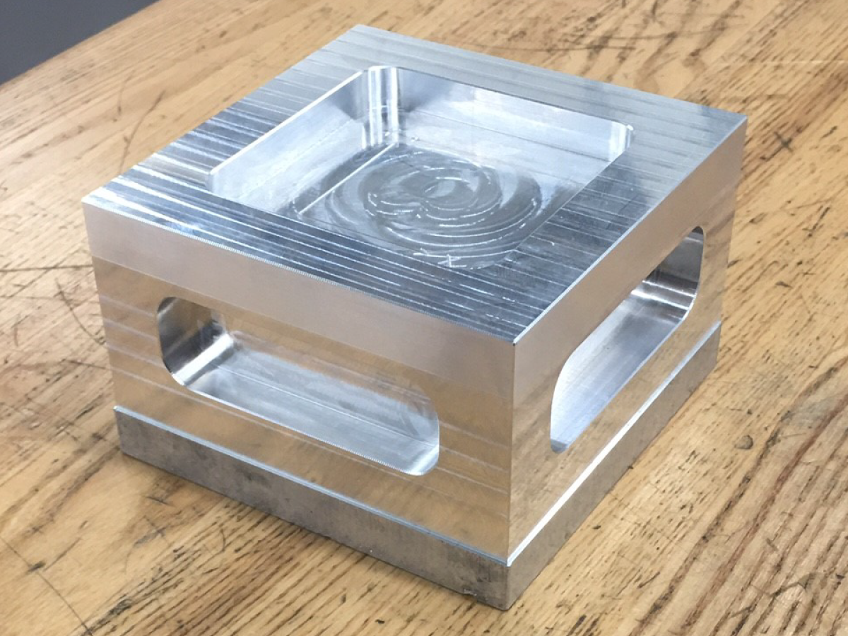

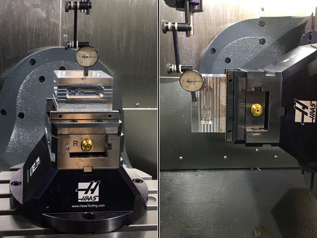

With the part in the vise, use a indicator to measure the step between the two tool paths.
Measure the step on either side of the pocket.
Measure these two locations on all four sides of the part and use the Y+ and X+ arrows to record the measurements below.
If there is a step out from the top surface to the bottom surface, record a positive value. If there is a step in from the top surface to the bottom surface, record a negative value.
Note: This step should be less than 0.001”.
  Left Side Right Side
X+
X-

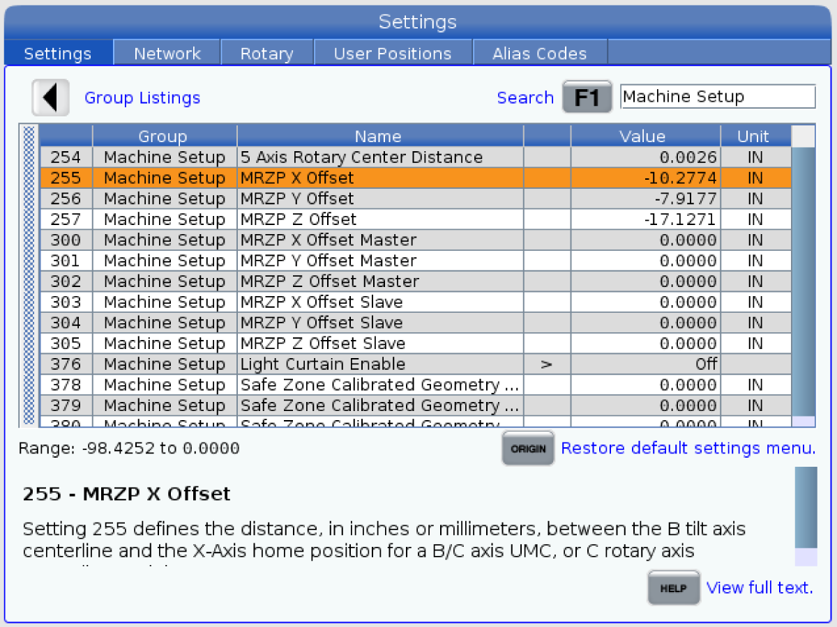

Y+
Y-
Adjust setting 255 MRZP X OFFSET or settings 300 MRZP X OFFSET MASTER and setting 303 MRZP X AXIS SLAVE until the X+ and X- results match.
  • If the X+ side has a positive step and the X- side has a negative step, adjust these settings in the positive direction by half the difference.
  • If the X+ side has a negative step and the X- side has a positive step, adjust these settings in the negative direction by half the difference.
Adjust setting 256 MRZP Y OFFSET or setting 304 MRZP Y AXIS SLAVE until the Y+ and Y- results match.
  • If the Y+ side has a positive step and the Y- side has a negative step, adjust these settings in the positive direction by half the difference.
  • If the Y+ side has a negative step and the Y- side has a positive step, adjust these settings in the negative direction by half the difference.
Once all four sides have the same step, adjust setting 257 MRZP Z OFFSET or setting 302 MRZP Z AXIS MASTER.
  • If all four sides have a negative step, adjust these settings in the negative direction.
  • If all four sides have a positive step, adjust these settings in the positive direction.
The tool length offset can also be used to adjust the step on all four sides of the part. If a large adjustment is needed, you need to make sure the probe calibration was done correctly.

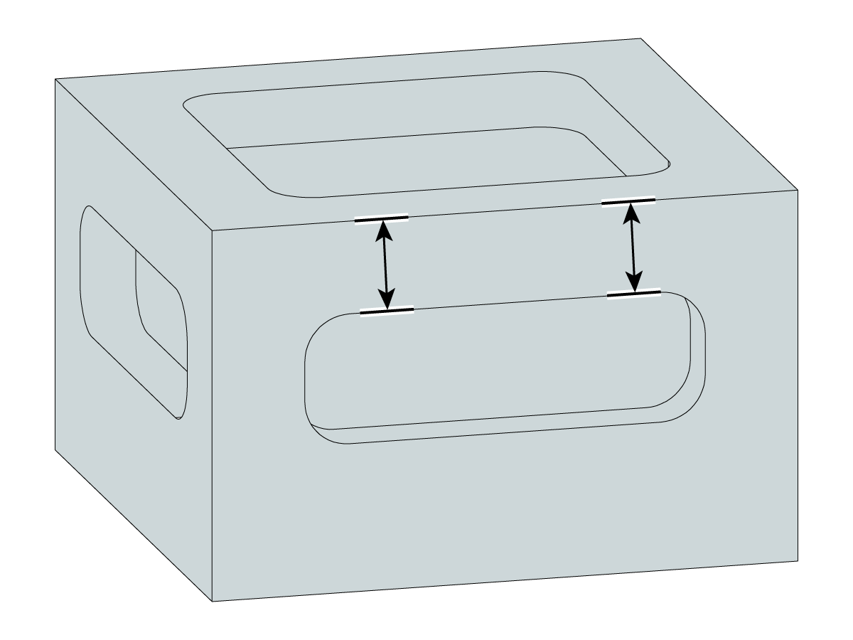

With a micrometer, measure the distance between the top face and pocket. Measure in two locations, the left and right side of the pocket. Record the measured values for all four sides of the part.
This distance should be 0.625” +/- .001”
X+
X-
Y+
Y-
If this distance is not 0.625” +/- .001” there could be a problem with the machine geometry.

With a micrometer, measure the distance between the side face and pocket. Measure in two locations, the left and right side of the pocket. Record the measured values for all four sides of the part.
X+
X-
Y+
Y-
7
These values should be correct if the values in Step 3 are set correctly.
