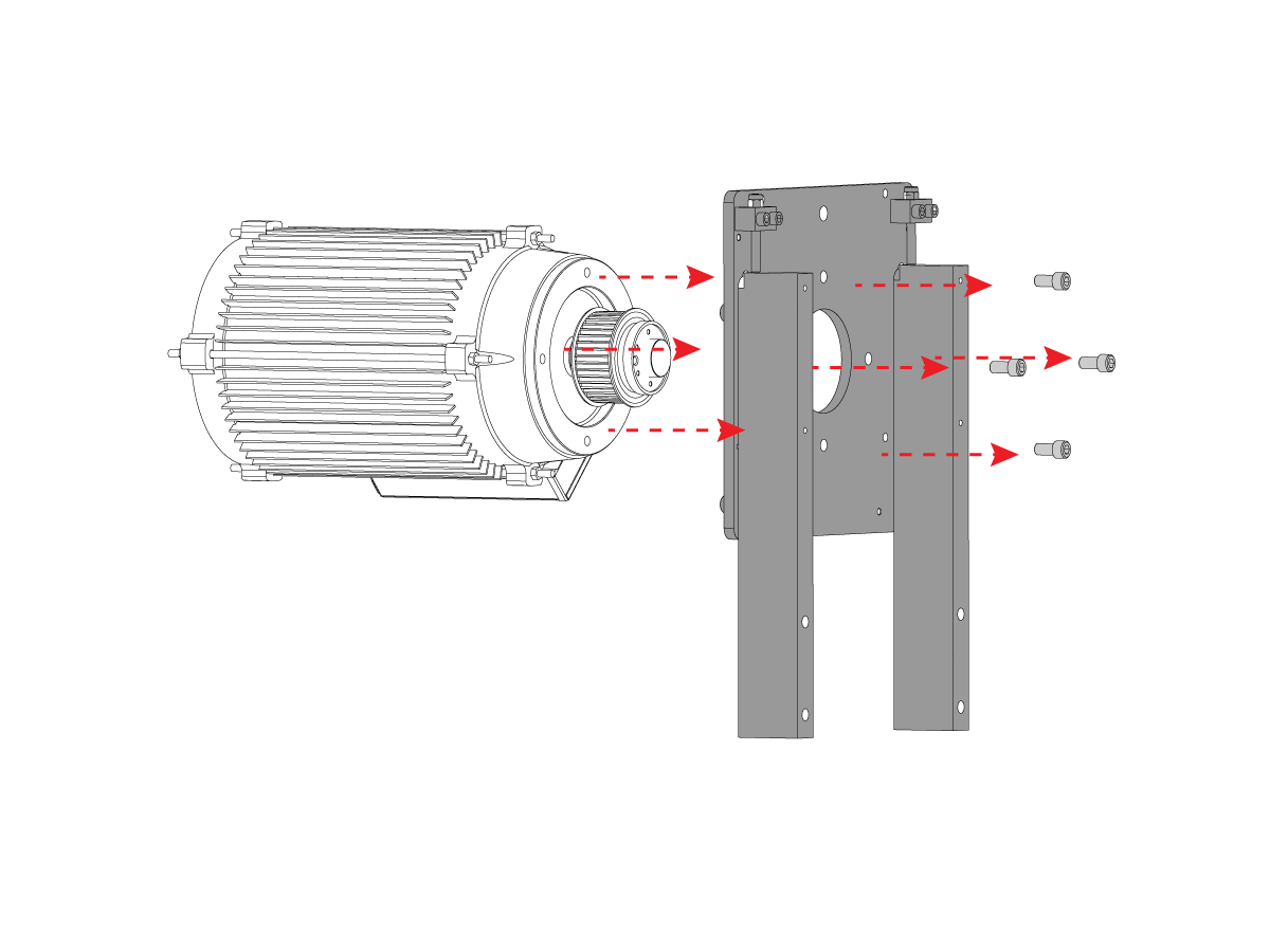

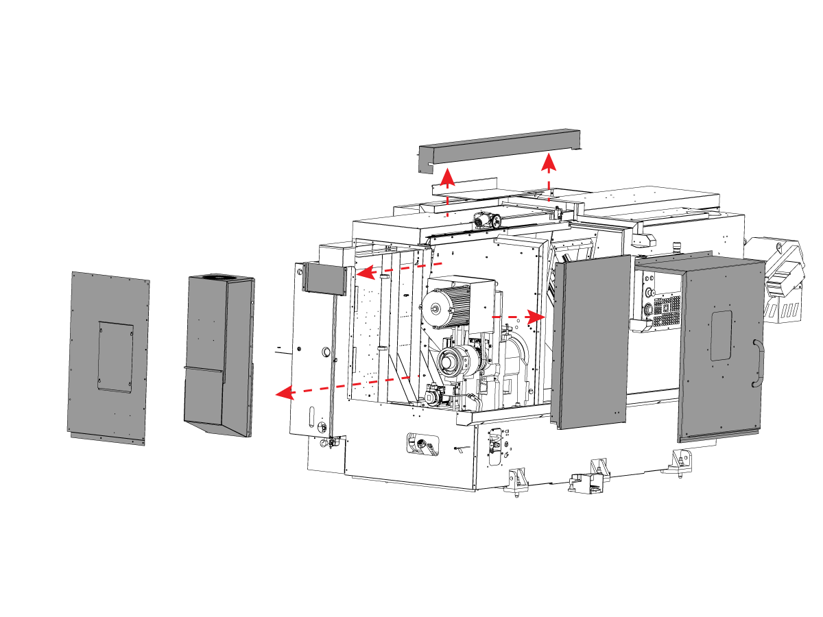

This procedure tells how to replace Spindle Motor Mount Brace and Spindle Motor Mount Plate to the Cast Motor Mount and Cast Motor Plate

Removal
  • Remove the door wiper and bumper assembly.
  • Remove the door roller guide from the top of the door.
  • Lift the bottom of the door up from the bottom door track. Pull the door away and out of the machine.
 Warning: The door is heavy. Get a second person to help you lift the door.

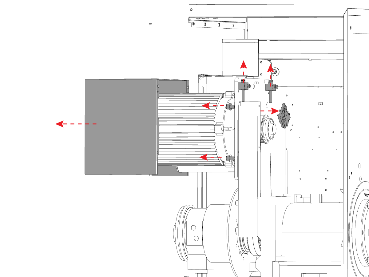

  • Remove the left front panel.
  • Remove all the left side panels.
  • Remove Motor Shrouds
  • Loosen the Motor Mount plates bolts
  • Remove Spindle Encoder mount and encoder
  • Loosen the belt tensioner
  • Remove the spindle belt from motor pulley
Note: Keep all encoder components to rebuild this motor with new motor plate

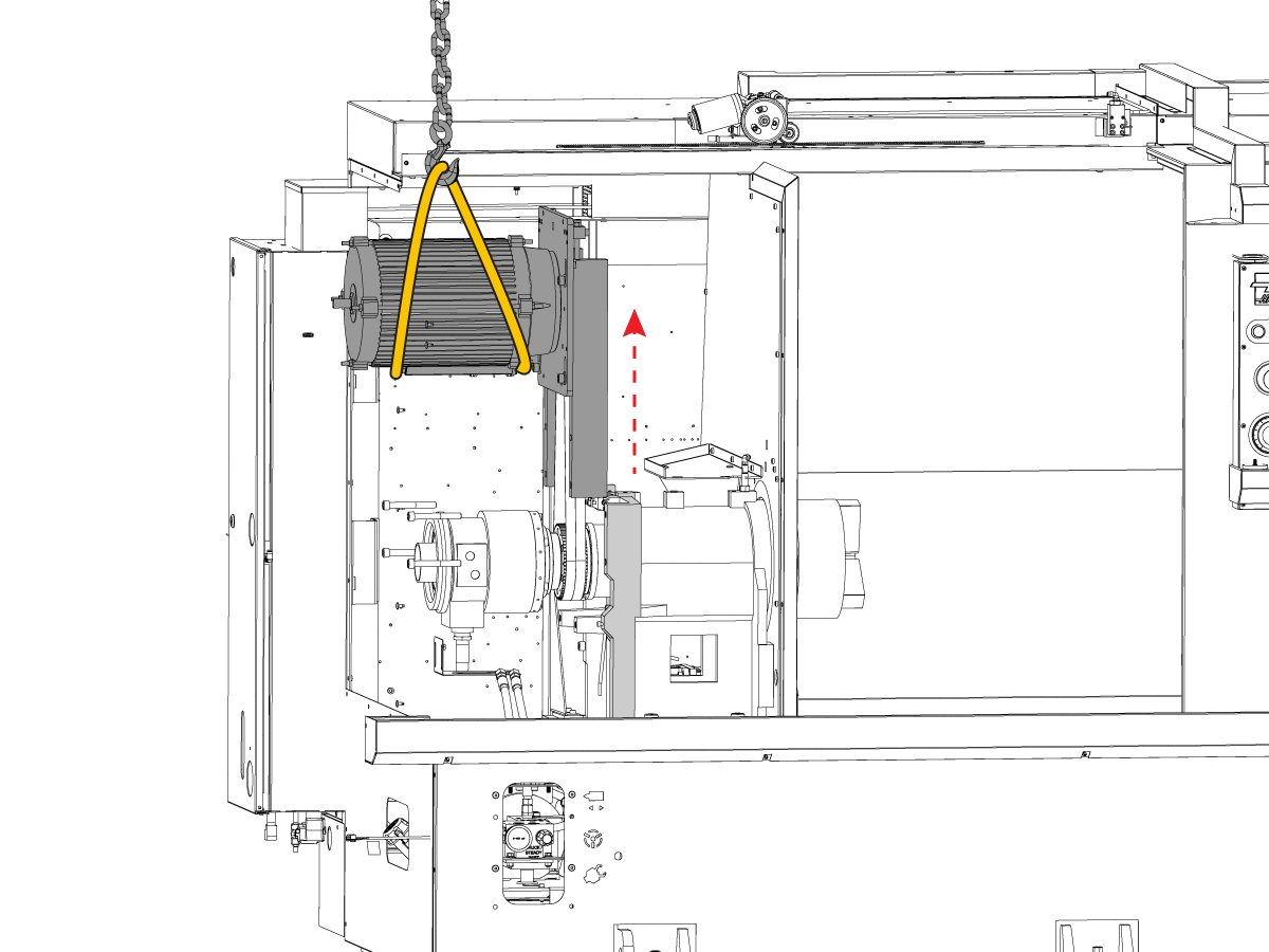

  • Remove Spindle Motor and Mounting Bars
  • Remove solid Steel Motor Plate from removed motor.
Installation
  • Install Cast Motor Plate onto the  motor. Refer to HAAS FASTENER TORQUE SPECIFICATIONS.

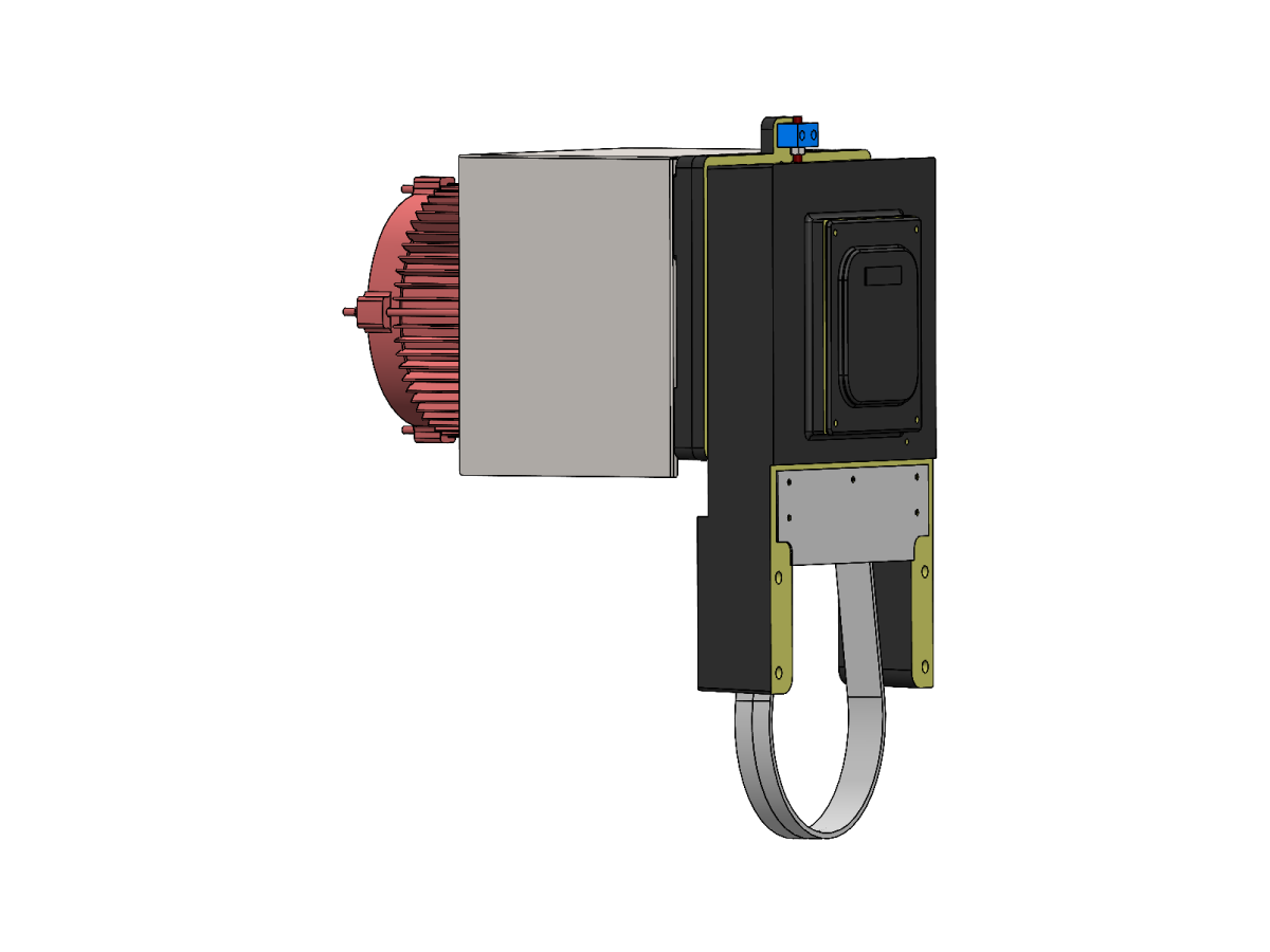

  • Install  the new encoder mount spacer and belt tension block.

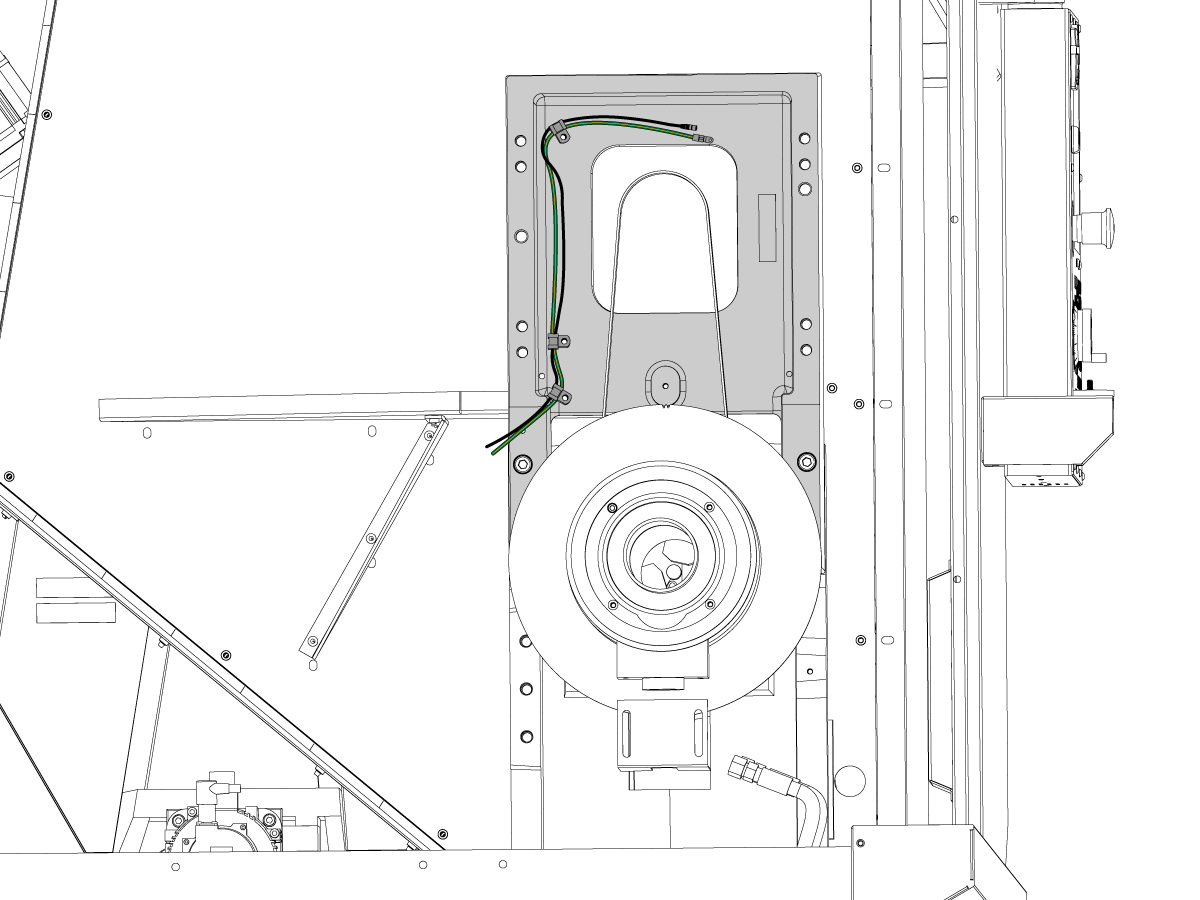

  • Install Cast Motor Mount onto spindle housing
  • Torque the (x4) bolts. Refer to HAAS FASTENER TORQUE SPECIFICATIONS.
  • Secure the encoder cable and ground cable to the motor mount

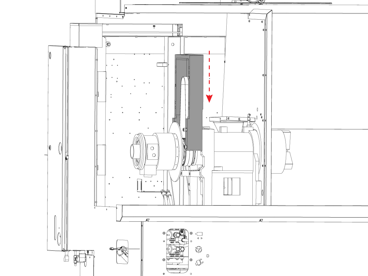

  • Install motor assembly (with belt tension block) onto motor mount.
  • Tension the belt using the Gates Sonic Meter .
  • Install Encoder mount pate and Encoder.
  • Gap the encoder components
  • Perform the C-Axis - Engagement Offset procedure.
