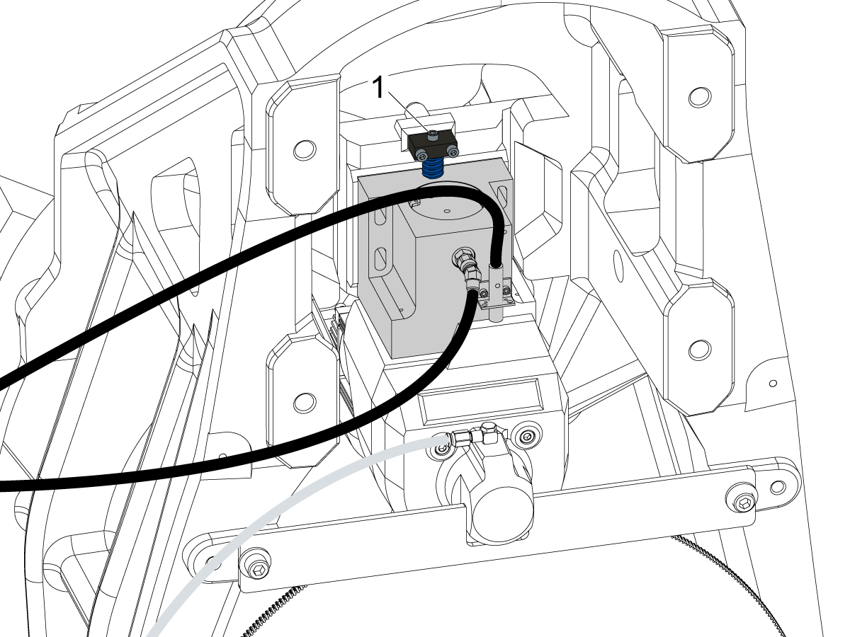

Set C-axis Engagement Offset
Break the C-axis mount bolts loose but keep them slightly snug [1].
Move the mount away from the disc by turning the adjustment screw to the right (tightening on a normal bolt) [2].
Note : ST-40/40S and larger machines have their C-axis assemblies [1] at the top of their spindle head casting. This assembly is adjusted the same way as ST-15 -35 machines.

Mesh the gears by turning the adjuster screw to the left until the C-axis drive gear is fully engaged with the disc gear. The mount may need to be pushed in by hand or tapped with a soft mallet to make sure the gears are fully meshed. The screw will start to stick out when fully engaged. See Red Arrow.
Note: Check that the drive gear is not engaged on the top of the disc gears tooth.
Slightly snug the mounting bolts.
