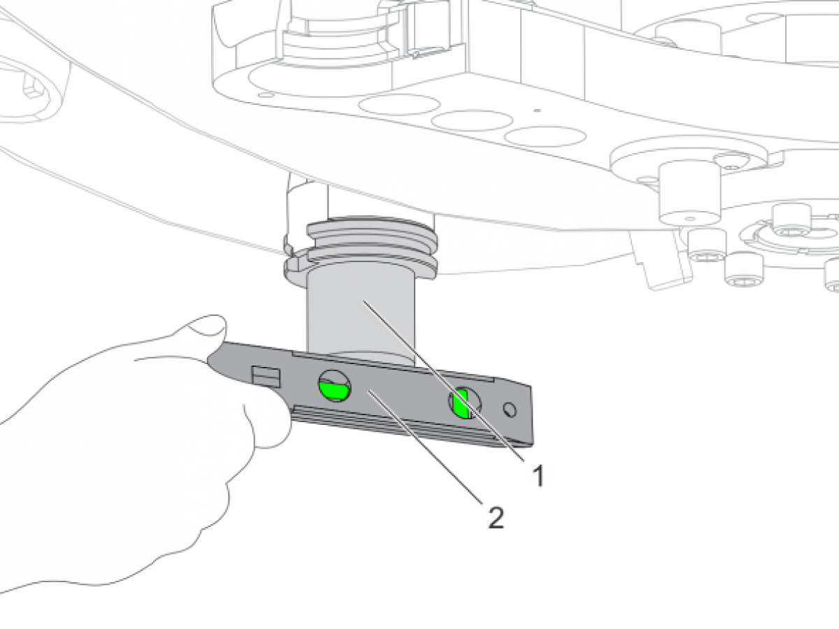

Place a tool [1] with a flat surface into the tool pocket.
Hold a bubble level [2] under the tool.
Jog the V Axis until the tool is level.
Press [POSITION].
Record the position of the V Axis.
Press [DIAGNOSTIC].
Select Parameters.
Select Factory.
Find Parameter 9.078 (V_AXIS TOOL CHANGE OFFSET) [1]. Enter the recorded value of the V Axis for this parameter.
