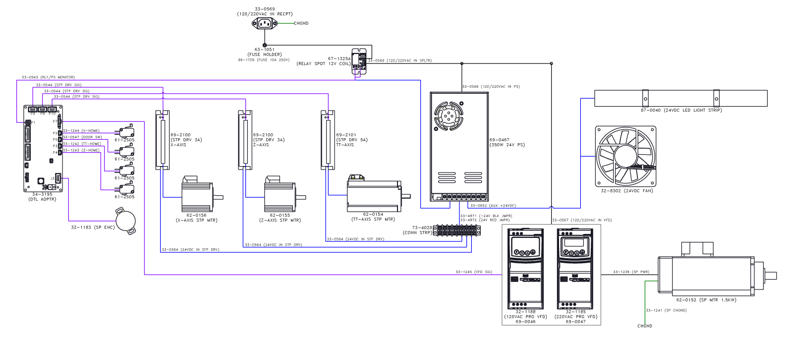

11.2 Desktop Lathe - Wiring Diagrams
Note: The part numbers are for reference only and may not be available to be ordered.
Electrical Cabinet Wiring Diagram
Control Cabinet Wiring Diagram
