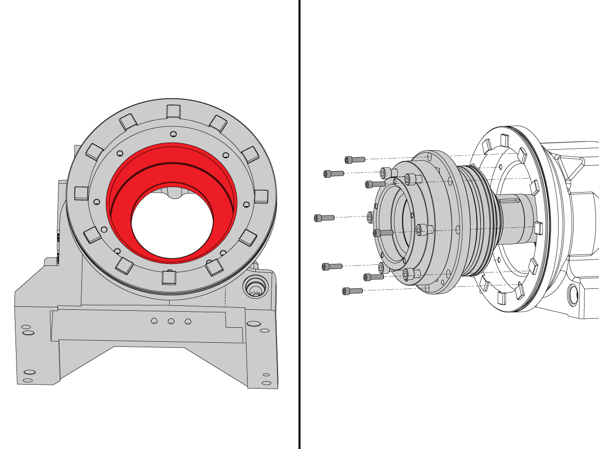

Clean the housing thoroughly.
Grease locations highlighted in red with black moly grease (99-1792).
Install new main shaft and screw down.

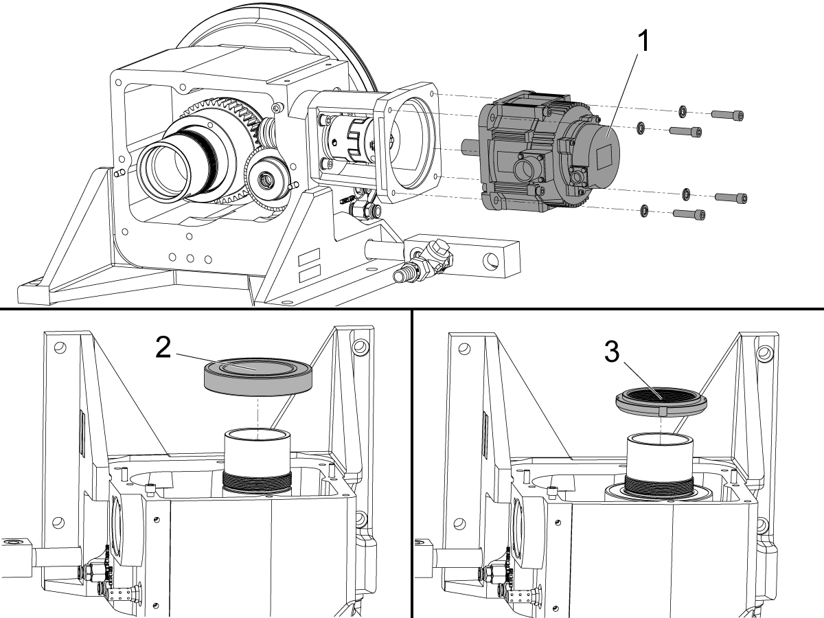

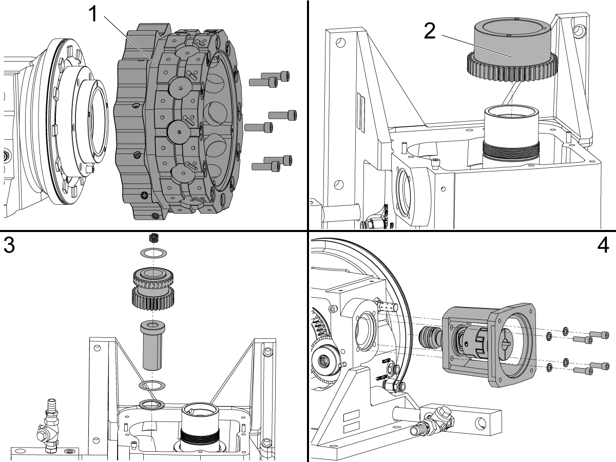

Clean, re-grease (if needed) and reinstall the following items in order:
  1. The turret onto the main shaft
  2. Spur gear
  3. Cluster gear, three washers, and spring
  4. Worm gear, motor mount, and coupler
Clean and reinstall the following items:
  1.  Turret servo motor
  2.  Bearings

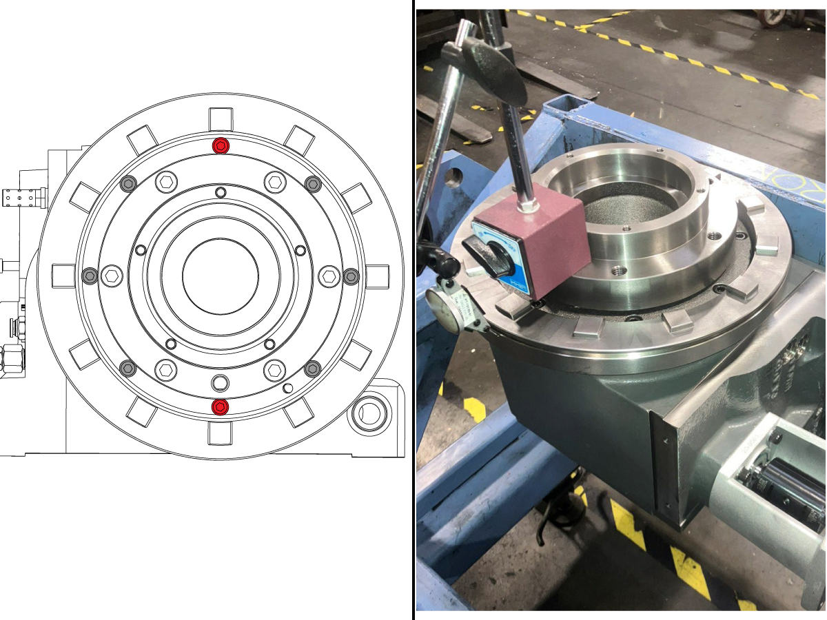

Remove the turret and loosen all but two of the bolts holding the main shaft in place.
Remove the turret and loosen all bolts holding the main shaft in place. Tighten down two bolts across from each other, similar to the one highlighted in red.
Use a dial indicator and sweep the housing OD to check the runout of the shaft. Adjust the shaft, using a pry bar, until the indicator reads ......... or less.  Tighten then torque all bolts to Haas specification.

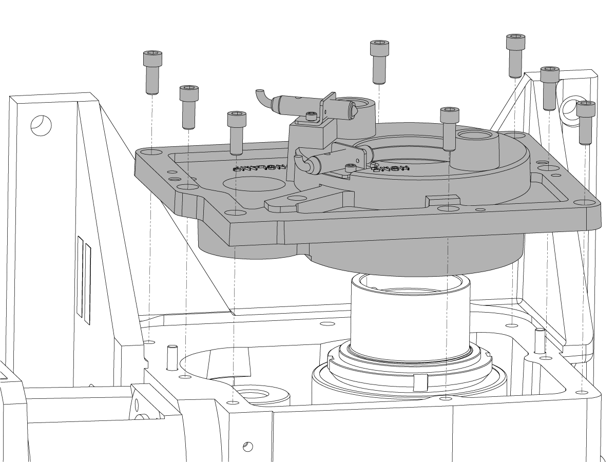

Reinstall the turret.
Reinstall the rear cover with new gasket.
Torque bolts down at 25 ft-lbs.
6
Slide the live tooling drive into the turret and torque bolts in a star pattern.
Install the indicator base on the live tool drive
Install the snap ring [2] on the torque tube.
Install the torque arm springs [1].
