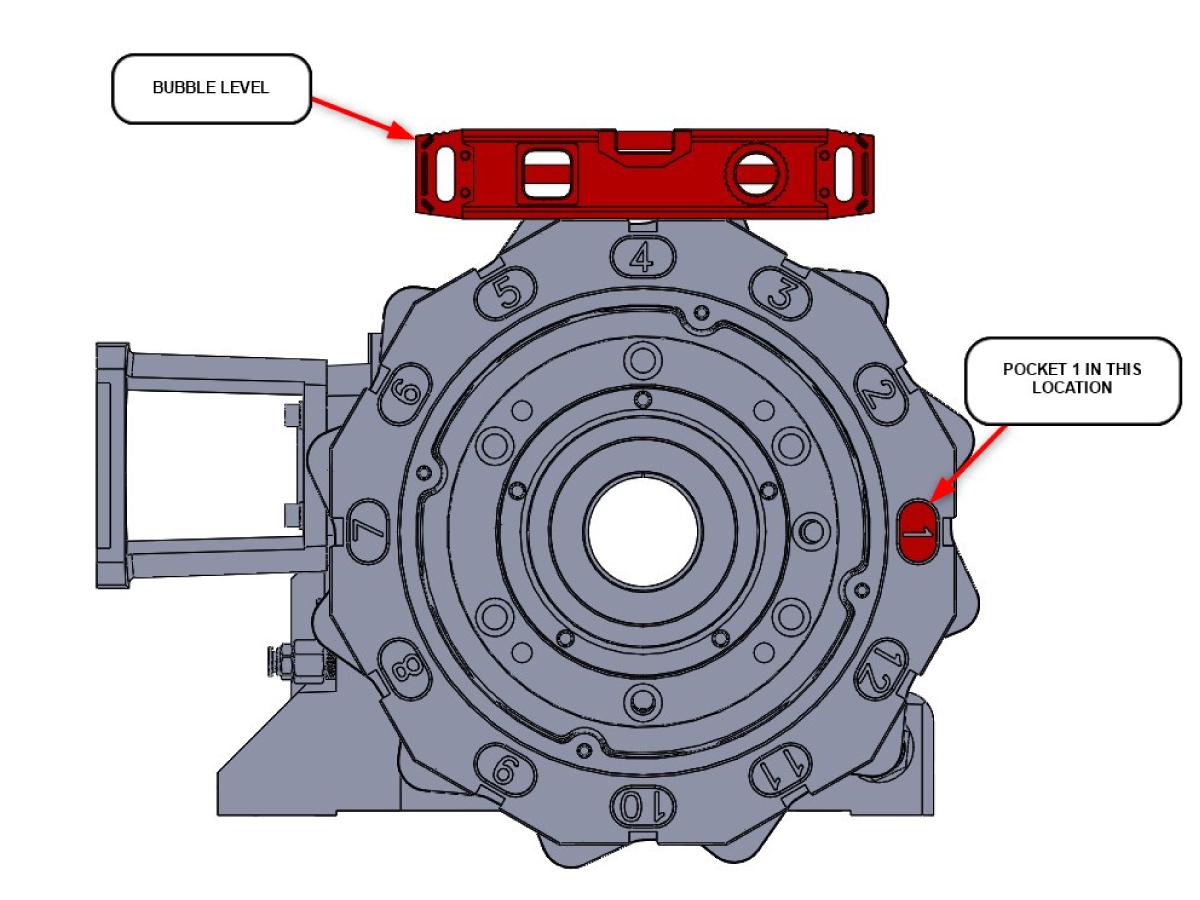

Index the turret to pocket 1.

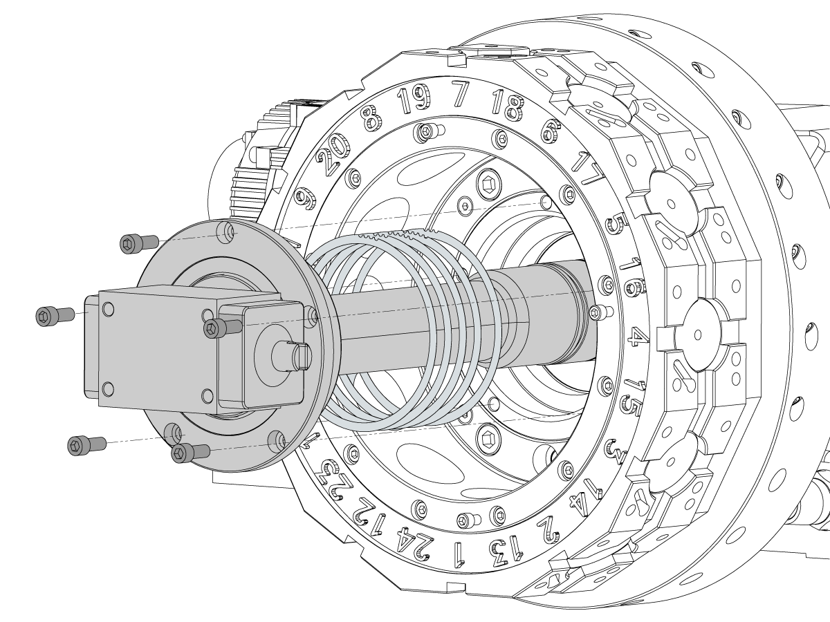

Remove the following items:
  1. Turret servo motor [1]
  2. Un-torque and remove the locknut [2] using T-0178
  3. Bearing [3]

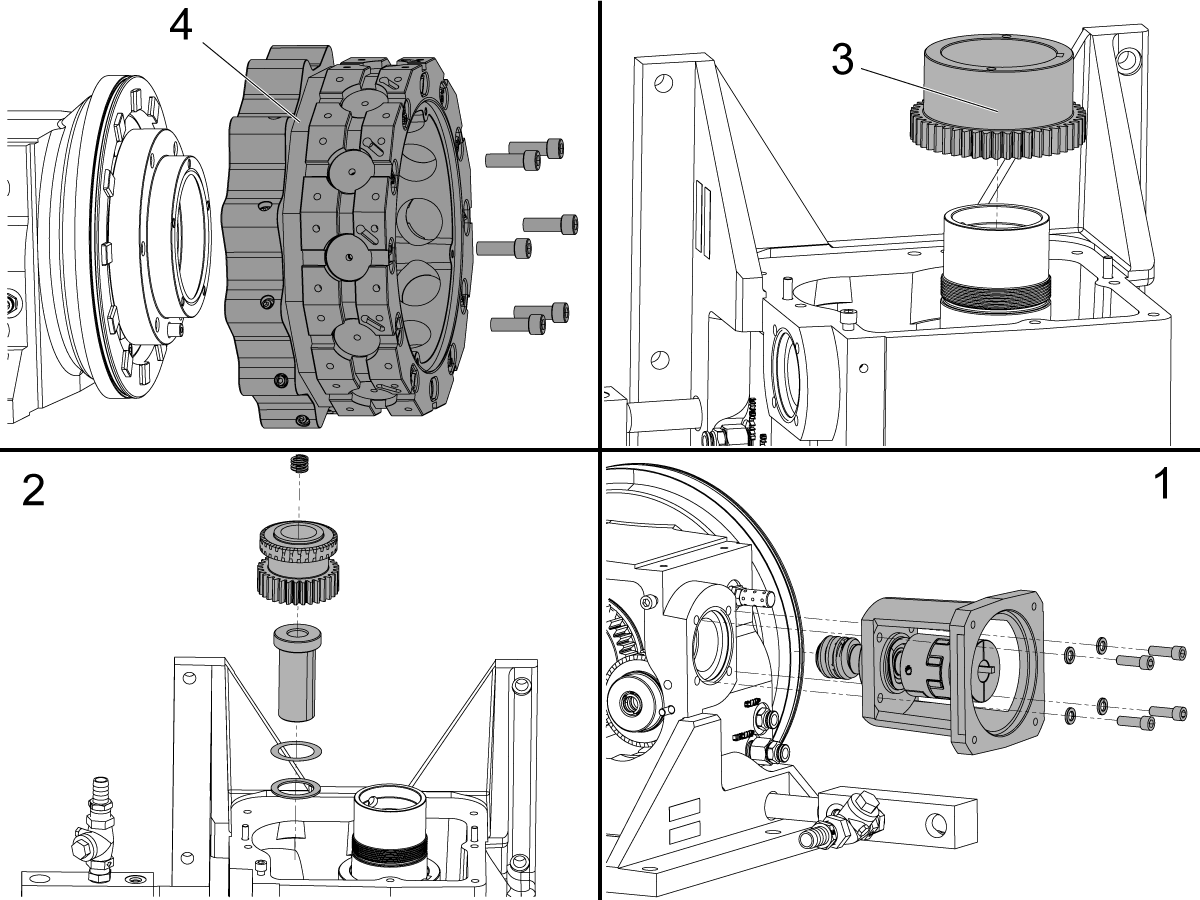

7
Remove the following items in order:
  1. Motor mount, coupler, and worm gear
  2. The cluster gear, three washers, and spring
  3. Spur gear
  4. Turret
Important : Refer to BMT45 - Indexer Turret - Replacement for more information regarding turret removal.

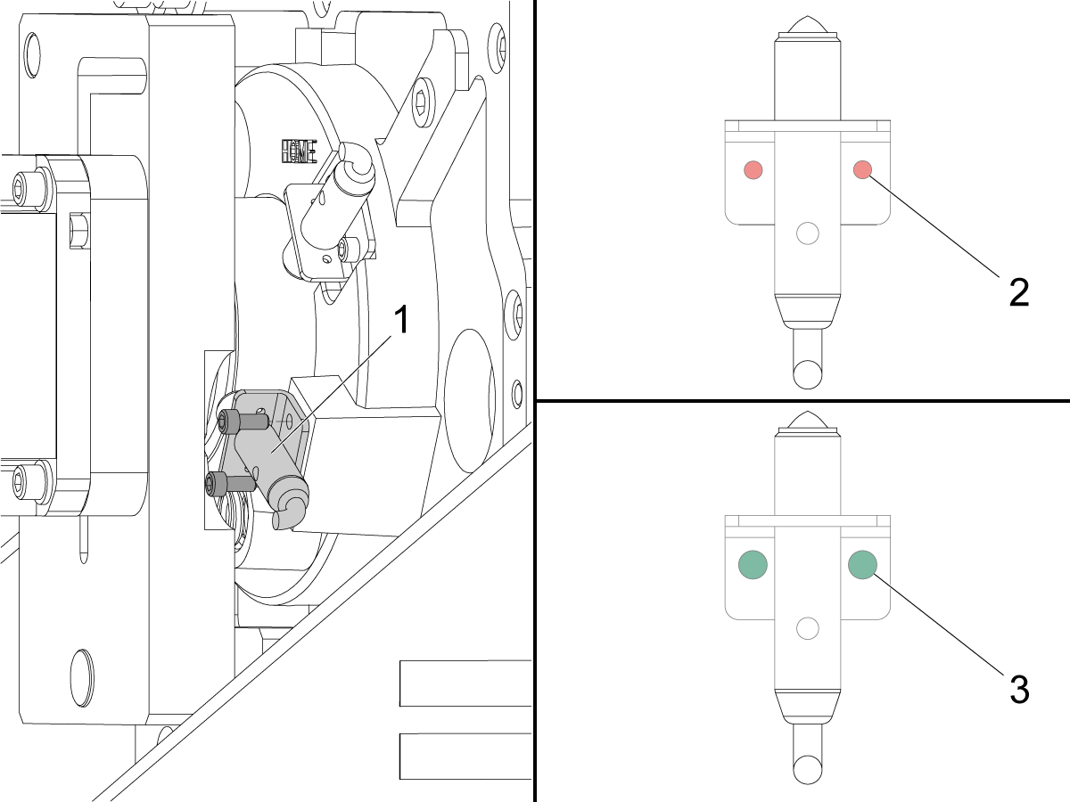

Clamp and unclamp the turret at pockets 1, 4, 7, and 10 to verify that there is no binding or interference between parts.
Clamp/Unclamp Proximity Sensor Adjustment
Use a 3/16" drill bit to increase the hole size on the proximity sensor.
