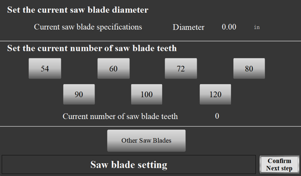

Set the blade parameters.
Enter the blade diameter and select the number of blade teeth.
Selecting [OTHER SAW BLADES] wiill prompt the user for the blade diameter and custom number of teeth.

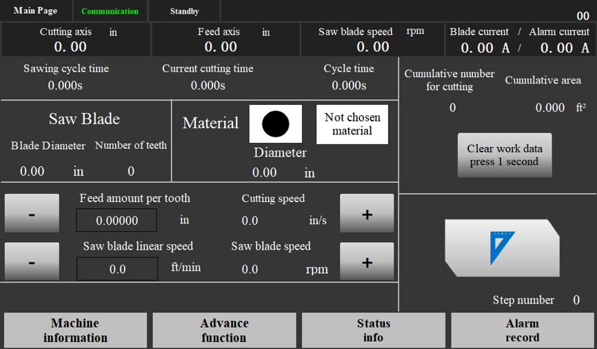

The Automatic Mode Main Page will provide the user a brief overview of the program parameters and machine monitoring.
Press the physical [CYCLE START] button to commence automatic sawing.
