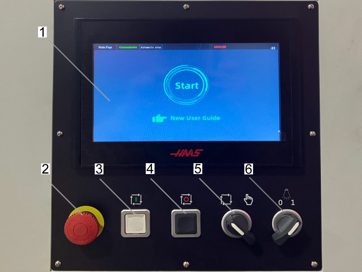

HCS-80 - Interface
Revision A - 06/2026
Number Function Description
1 HMI Touch screen.
2 Emergency Stop Press to engage Emergency Stop. Twist and pull to release Emergency Stop.
3 Cycle Start Press to start the sawing operation.
4 Cycle Stop Press to stop the sawing operation.
5 Sawing Mode Switch Toggle left to enable automatic mode. Toggle right to enable manual mode.
6 Light Switch Toggle 0 to turn off light. Toggle 1 to turn on light.
