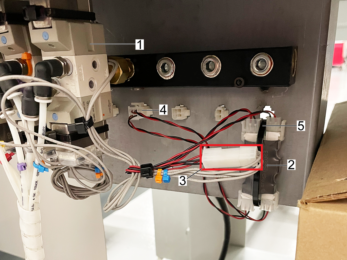

APL Solenoids
Disconnect the APL solenoid [1] and connect it to the double solenoid filter [2] connection [3] that was ordered.
Connect the solenoid filter where the APL solenoid was originally connected to [4].
Zip tie the double solenoid filter to the mounting bracket as shown [5].
