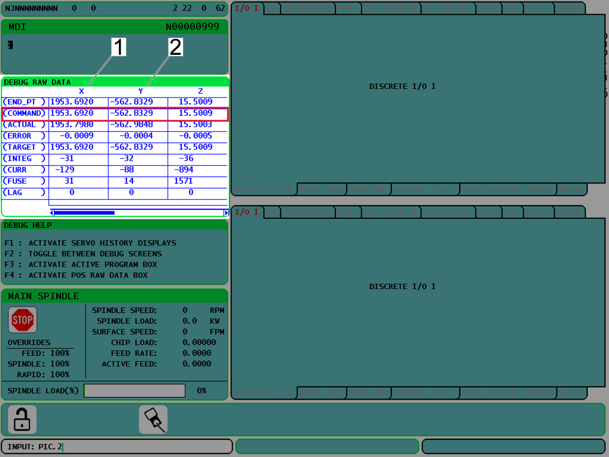

For Classic Haas Control: Go to the DEBUG RAW DATA page. Record the COMMAND values for the X and Y Axes.
Enter the recorded values to Parameter 210 X TOOL CHANGE OFFSET and Parameter 211 Y TOOL CHANGE OFFSET. Enter the values as negative numbers. Do not include the decimal point.
For example, set Parameter 210 to ‑19536920, and set Parameter 211 to ‑5628329.
Use the tool changer RECOVER mode to move the arm until the values of Arm at Origin and Arm at Stop are 1.
Push [ZERO RETURN], then [ALL]. Remove the split tool from the double-arm and spindle. Go out of Service mode.
