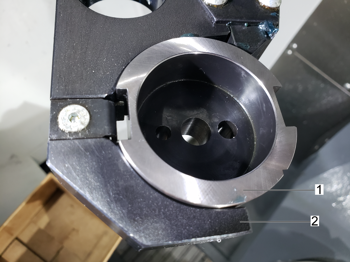

Double Arm Alignment Half
Install the respective Alignment half into the double arm.
Note: The bottom alignment half [1] should be installed to the double arm [2] so that the larger slot is installed into the double arm key as shown.

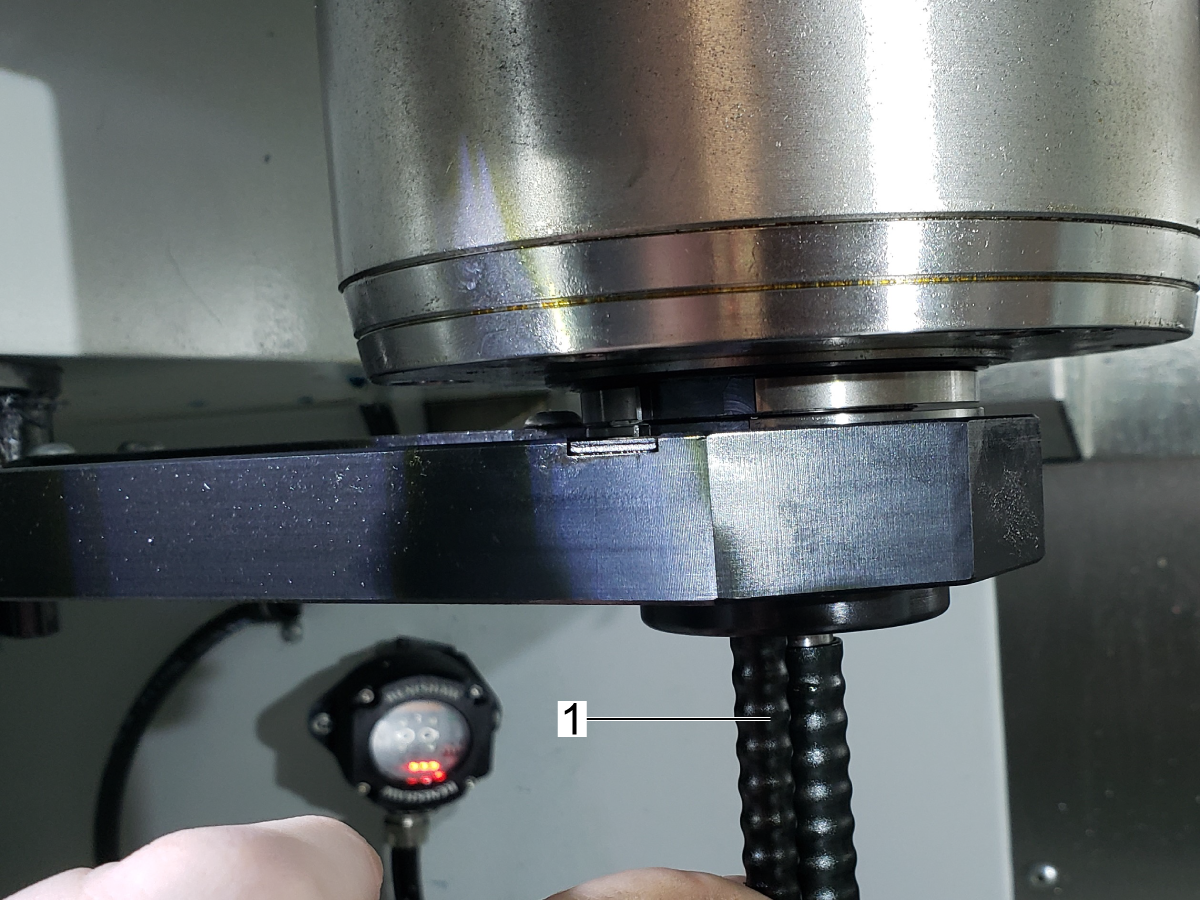

Spindle Alignment Half
Install the respective Alignment half into the spindle.
Make sure the spindle alignment half is correctly installed into the spindle such that it is fully seated with the taper.
Note: If it is not fully seated, then the tool-release icon will show up on the screen. If the tool-release icon is not showing up when the spindle alignment half is on in the wrong direction the TRP clamp switch will need to be adjusted, refer to the HSK-A63 - Spindle Drawbar - Push Out procedure to adjust the switch.
Skip this step if the Double Arm is already aligned.
Refer to SMTC - Double Arm - Alignment - VMC
Enter service mode.
Press [RECOVER] to enter recovery mode. Then press [M] to enter manual recovery.
Press [ORIGIN] to move the spindle to TC position, then jog the z-axis up so that the spindle alignment half will allow clearance for the double arm alignment half.
Press the down arrow to move the double arm until the double arm says [Clamp/Unclamp] in the Tool Changer Status Summary.
Jog the z-axis back down until the two alignment halves mate correctly [1].
Insert the Alignment pin [1] to ensure the alignment halves are properly aligned.
Note: The alignment pin does not need to be flush with the alignment half, but it does need to engage both alignment halves.
