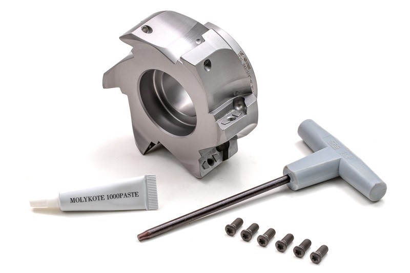

HPAL2, 4" Ø freesdoorn, 1-1/4" boorgat x 90° afloophoek, 6 groeven, positieve/positieve geometrie, koeling door de spil
Werkstuk #: 01-0782
HPAL 4 x 1-1/4”-6C SHL MILL
Prijs: 356.95 ( / eenheid)
321.97
This Haas High Positive Aluminum (HPAL2) medium-pitch shell mill is specially designed for heavy machining of aluminum and similar n on-ferrous materials, while maintaining a good surface finish. The concave grooves found on the back of its inserts provide for strong clamping at higher cutting speeds, and the buffed cutting surfaces ensure smoother chip evacuation and reduced built-up edge (BUE) when copy milling, face milling, helical milling, ramping, shoulder milling, and slotting. It has a 4.0 in \ 4" cutting diameter, and a 1.25" pilot bore, with a 90-degree cutting edge. The positive axial, positive radial-raked cutter body takes 6 polygon/special cutting inserts. The screw-clamp inserts have 2 cutting edges, and are available in grades for aluminum/non-ferrous materials. This cutter body is through-tool coolant (TSC) capable, when used in conjunction with a coolant-through arbor screw. Inserts and coolant-through arbor screw sold separately.
Meetsysteem Inch - ANSI
[ØDC] Snijdiameter 4,0 inch / 4"
Frees-serie HPAL2 - Haas HP Aluminium
  Type gereedschapspad     Steken, Kopieerfrezen, Schouderfrezen, Kopfrezen, Helling, Helicoïdaal frezen
[°] Afloophoek 90 DEG
[Z] Aantal snijtanden 6
[Ød] Diameter asgat 1,25 inch
[a] Spiebaanbreedte 0,5 inch
[Ap] Max. Snijdiepte 0,862 inch
[OAL] Totale lengte 2,0 inch
[IC] Ingeschreven cirkeldiameter 0,502 inch/12,76 mm
[L10] Snijkantlengte 0,862 inch/21,9 mm
Maximale omw/min 4500
Koppel van de schroef van wisselplaat 1.020 Ncm
Koppelingsstijl B
Koelmiddel door gereedschap Nr.
Gewicht 0,9 lbs \ 0,4 kg
Land van herkomst China
