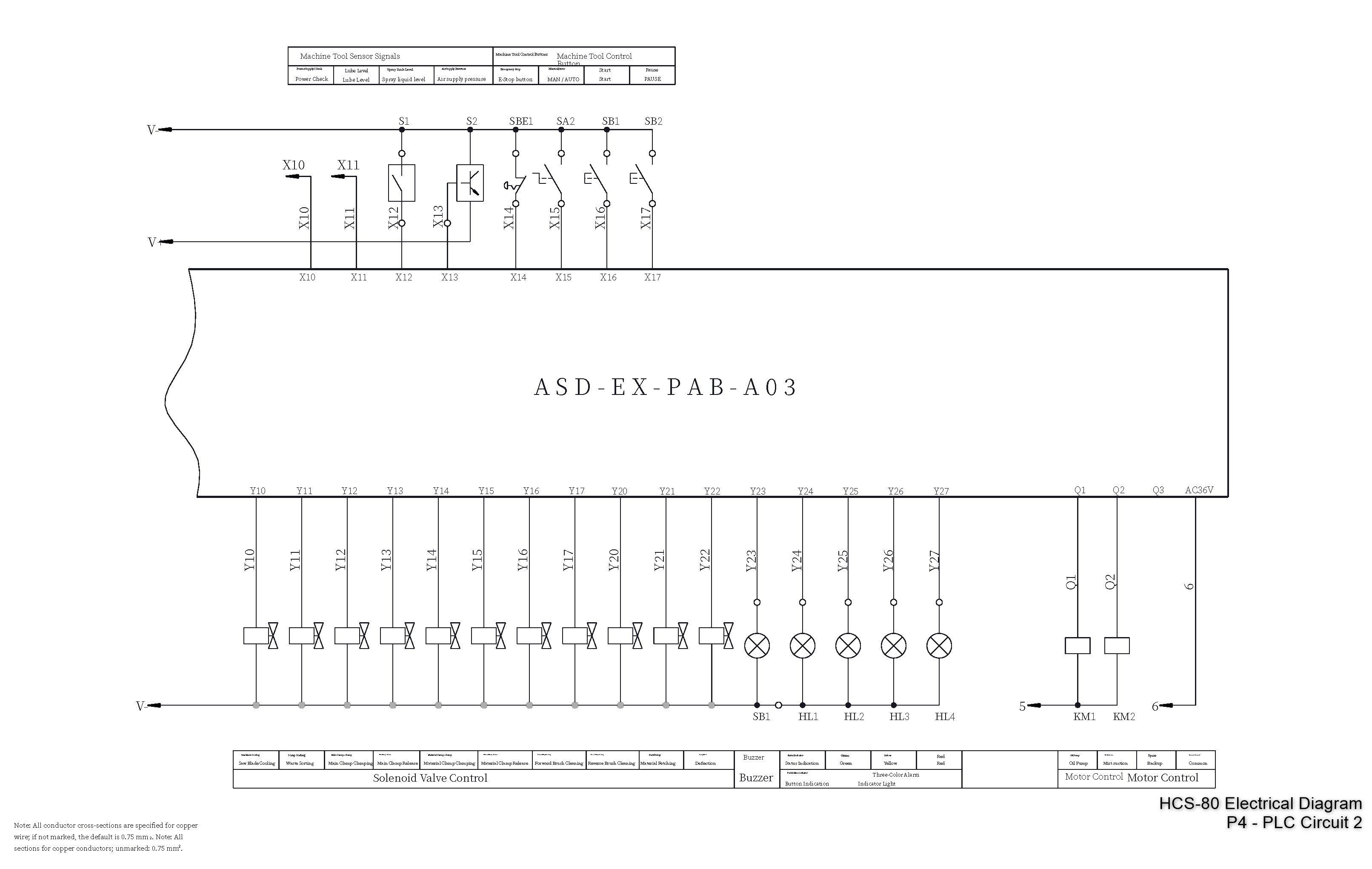

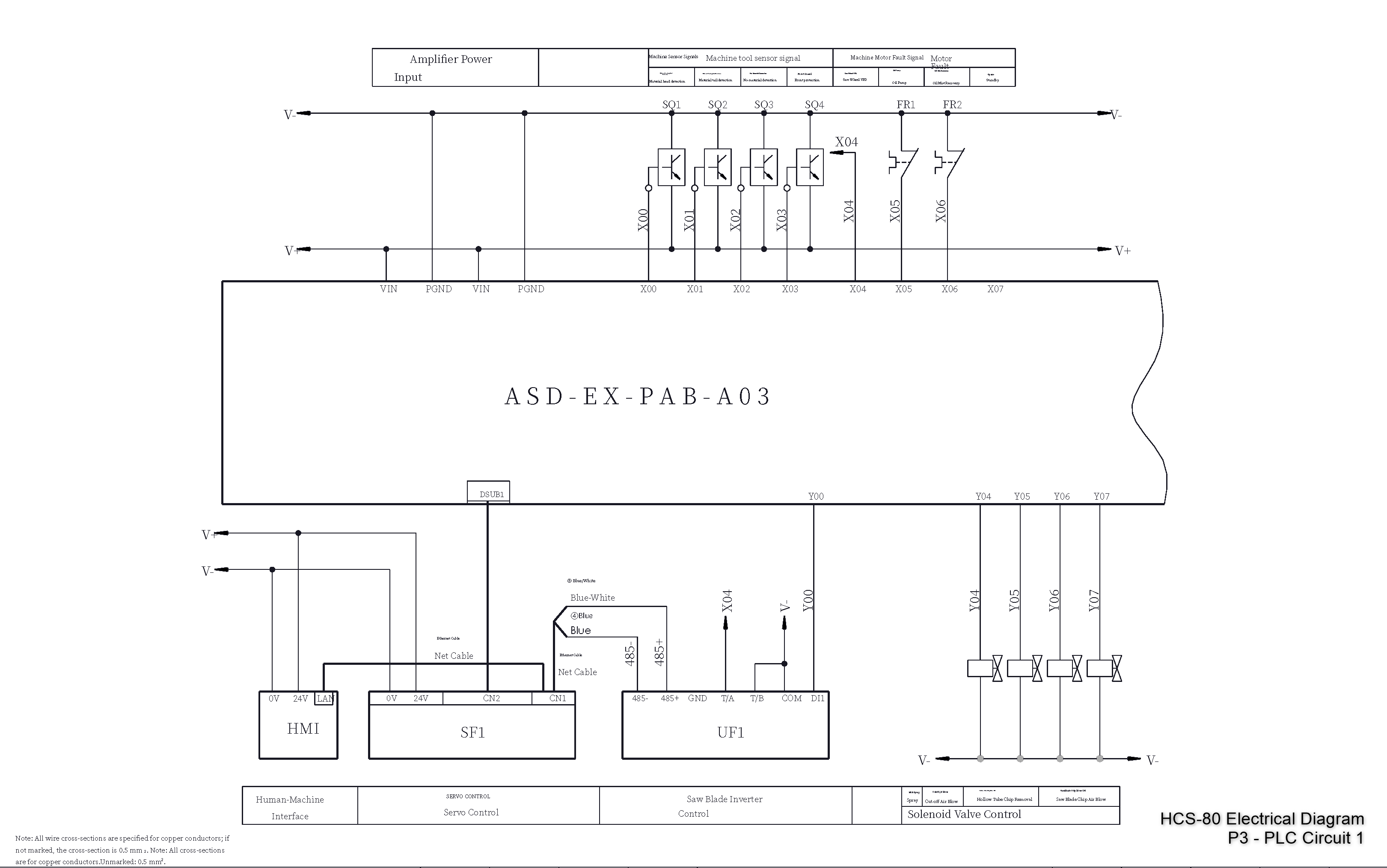

HCS-80 - Electrical System
Revision A - 06/2026
Under Construction
Electrical Diagrams
