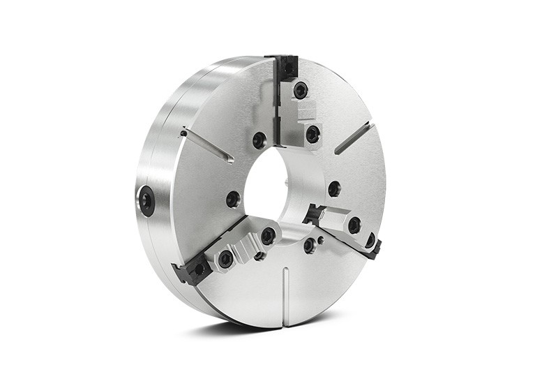

Mandrin autocentreur à 3 mors 20" (500 mm), nez de broche A2-11
Référence: 05-0583
A2-11 3-JAW SCROLL CHUCK, ST-45
Prix : 10499.95 ( / unité)
Prix Winner's Circle:
(Enregistrer )
LIVRAISON
  1. Généralités

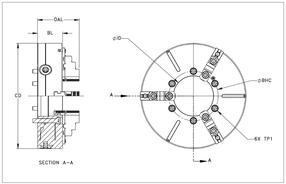

Caractéristiques techniques
Machine Models ST-45
Spindle Nose A2-11
Jaw Style Two-Piece
Number of Jaws 3
Material Steel
[ØBHC] BHC Diameter 9.252 in \ 235.0 mm
[ØCD] Chuck Diameter 19.685 in \ 500.0 mm
[ØID] Inner Diameter 7.48 in \ 190.0 mm
[BL] Body Length 4.685 in \ 119.0 mm
[OAL] Overall Length 7.795 in \ 198.0 mm
[TP1] Thread 3/4"-10
Maximum RPM 1300
Maximum Clamping Force 72000 N
Max O.D. Clamping 0.8 - 19.7 in
Max I.D. Clamping 4.7 - 19.1 in
Maximum Workpiece Weight 3000.0 lbs \ 1361.0 kg
Maximum Unsupported Workpiece  286.6 lbs \ 130.0 kg
Torque of Wrench 360 Nm
Weight 332.2 lbs \ 150.7 kg
Country of Origin USA
