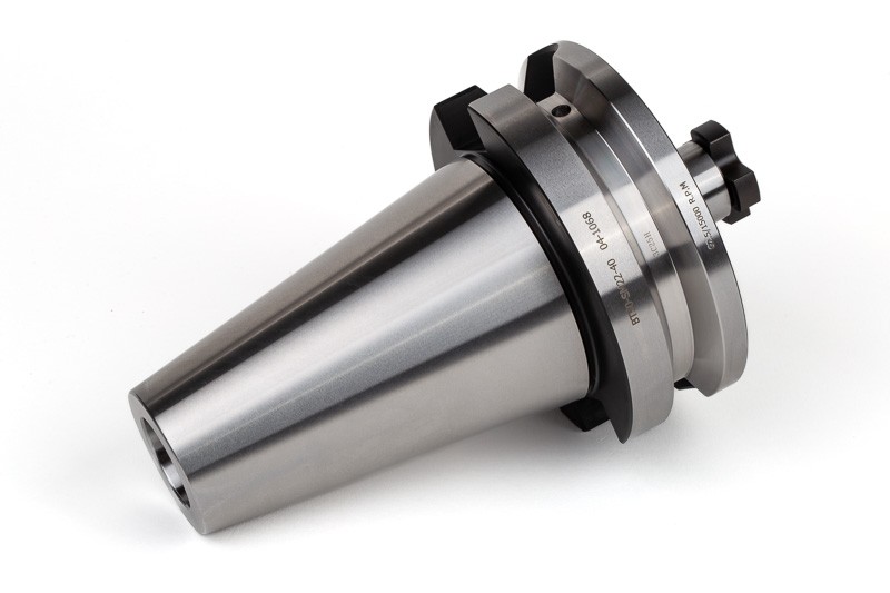

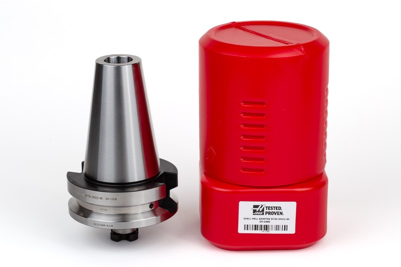

Support de fraise à plaquette BT50, diamètre pilote de 22 mm x longueur de jauge de 40 mm, TSC
Référence: 04-1068
BT50-SM22-40

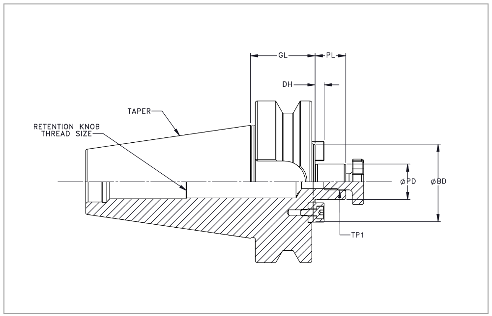

Caractéristiques techniques
Taper BT50
[ØPD] Pilot Diameter 22.0 mm
[ØBD] Body Diameter 48.0 mm
[GL] Gage Length 40.0 mm
[BL] Body Length 2.0 mm
[PL] Pilot Length 19.0 mm
[DH] Drive Lug Height 5.6 mm
[a] Keyway Width 10.0 mm
[TP1] Thread M10×1.5
Concentricity 0.005 mm
Balanced to RPM 15000
Retention Knob Thread Size M24×3.0
Through Tool Coolant Yes
Weight 8.4 lbs \ 3.8 kg
