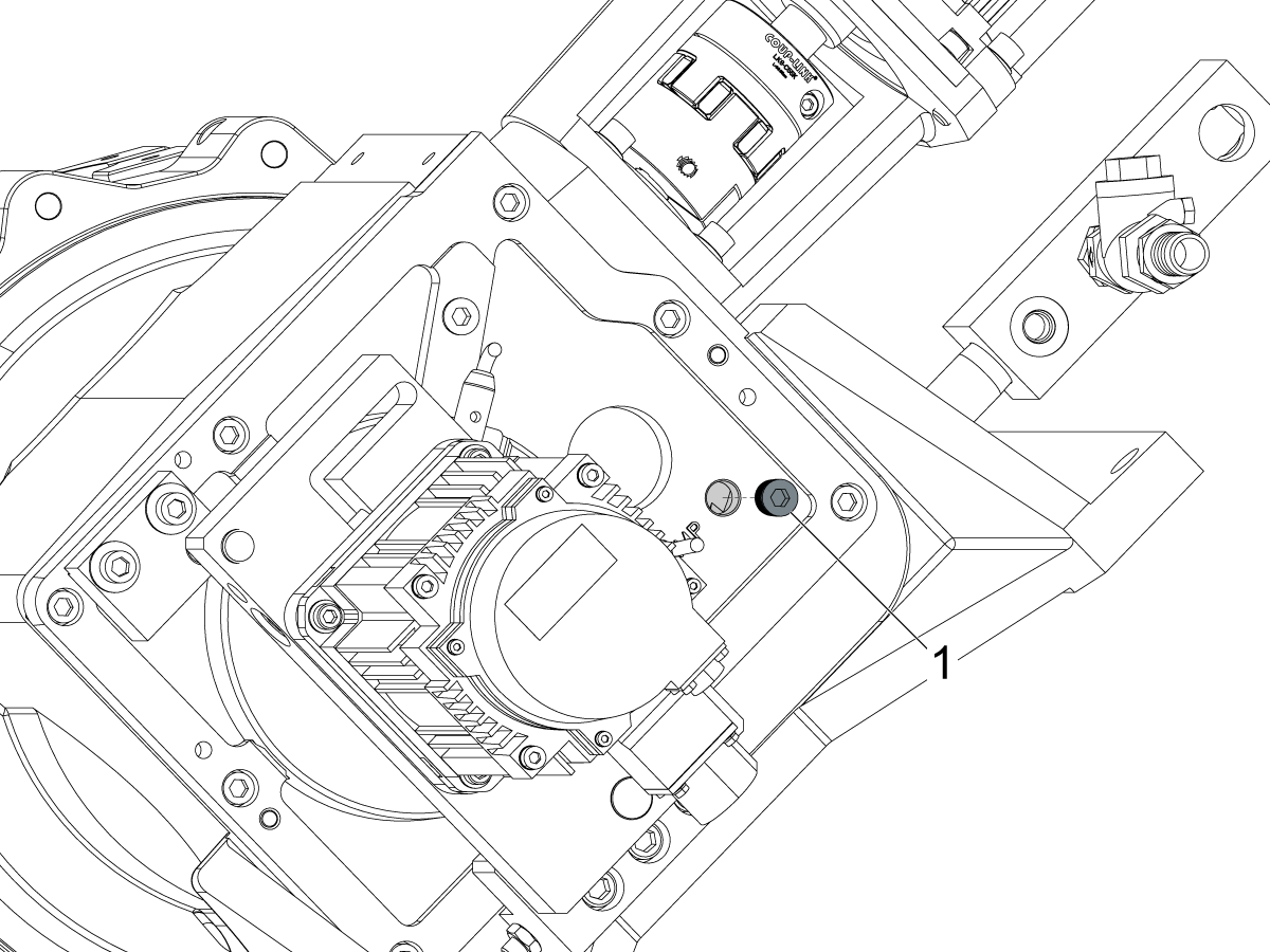

BMT45 Gearbox - Oil Refill
Remove the fill plug [1].
Note : If the gearbox does not have this fill port proceed to remove one of the mufflers and use the muffler port as a fill point ensuring that only 1 quart of oil is used.
Fill the gearbox with 1 quart of 93-2365 until flows out of the fill plug [1].
