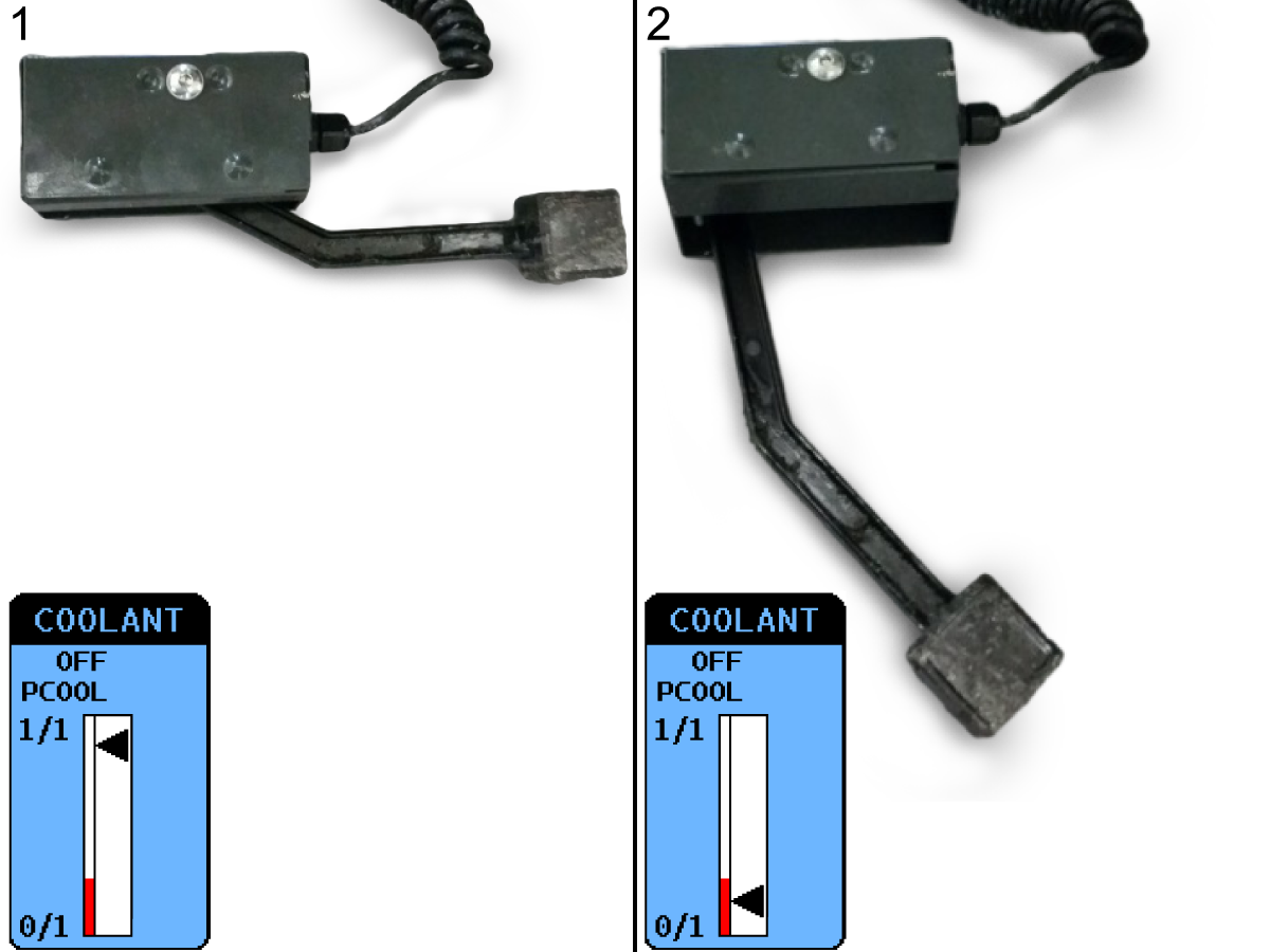

The image shows the following components of the Coolant Float Sensor:
  1. Float [1]
  2. Potentiometer [2]
  3. Bracket [3]
  4. Power Cord [4]
  5. Potentiometer Cover (not shown for clarity)

In the first image, you can see the location of the coolant level sensor on the coolant tank.
If your coolant level sensor does not display the correct level on the screen, look in the coolant tank to make sure a chip build-up does not block the float from moving freely. Also, inspect the float for any leaks to make sure no coolant has wept in.
Corrective Action:
Make sure the coolant level sensor operates correctly:
  • Press [MEMORY]. The upper-right corner of the screen will show the coolant level.
  • Remove the coolant float sensor from the tank and manually move the float to max and min conditions.  The coolant level indicator on the screen should move at a slow pace. It takes approximately (1) minute to move from empty [2] to full [1] on the screen, but it starts to move immediately. Note the percentages that the coolant level indicator reports when the float is at min and max conditions.
  • If the coolant level sensor does not operate correctly, unplug the coolant level sensor from the machine.
Measure the voltage across the black [1] and blue [2] wires on P43 on the I/O board when the float is up and down. The voltage should be approximately 3.8V when the float is up and 2.6V when it is down.
Measure the resistance at pins [2] and [4] on M12 connector when the float is up and down. The resistance should be approximately 371 Ohms when the float is up and 286 Ohms when it is down.
NOTE: Do not remove the coating around the wire, rather take the reading at the M12.
If another machine is present, test float on different machine. If the coolant level sensor continues to read incorrectly, and you have completed the troubleshooting instructions, replace the sensor.
 IMPORTANT: When returning the sensor, make sure to include an error report.
 IMPORTANT: When returning the sensor, please include the following information:
  • Machine state during malfunction (idle or cutting)
  • A video showing coolant level in the tank and on the pendant screen
  • Error Report
  • Resistance across black and white wires (see above)
