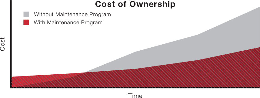

We’re confident in the quality and reliability of Haas machines. But even the best-made equipment needs to be properly maintained. In the past, the ideology was, “If it’s not broken, don’t fix it.” A better way to approach machine maintenance is, “If it’s not broken, let’s keep it that way.” Completing timely maintenance on the machine tool over time will minimize catastrophic breakdowns, and reduce the total cost of ownership. Machines will work at full efficiency, creating profitable uptime, while reducing downtime. Problems are recognized earlier, and the chances of complete machine breakdown are reduced.
