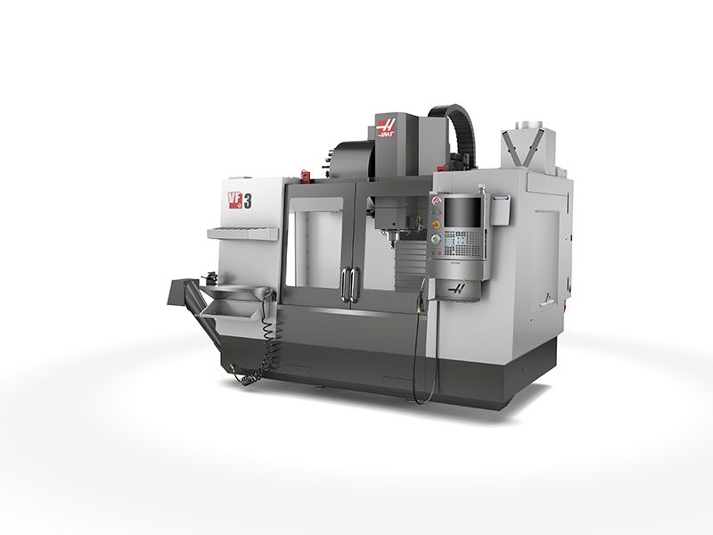

CNC Vertical Mill with 40" x 20" x 25" travels
Every VF Series vertical machining center provides outstanding features at an excellent price, and features a wide range of available options to customize your machine to your exact needs. The VF-3 through VF-5 models feature larger work envelopes than the smaller VF-1 and VF-2 models.

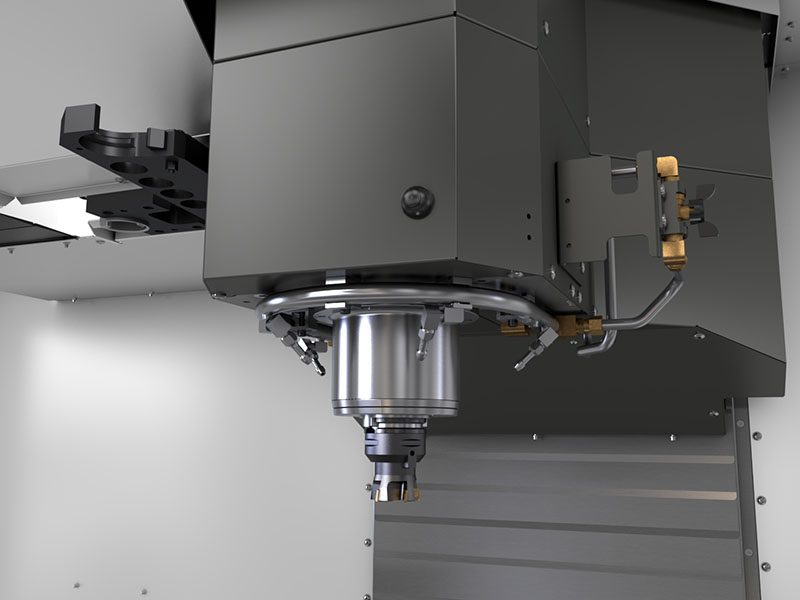

    Spindle S.A.E METRIC
    Max Rating 30.0 hp 22.4 kW
    Max Speed 8100 rpm 8100 rpm
    Max Torque 90.0 ft-lbf @ 2000 rpm 122.0 Nm @ 2000 rpm
    Max Torque w/opt Gearbox 250 ft-lbf @ 450 rpm 339 Nm @ 450 rpm
    Drive System Inline Direct-Drive Inline Direct-Drive
    Taper CT40 | BT40 | HSK-A63 CT40 | BT40 | HSK-A63
    Bearing Lubrication Air / Oil Injection Air / Oil Injection
    Cooling Liquid Cooled Liquid Cooled

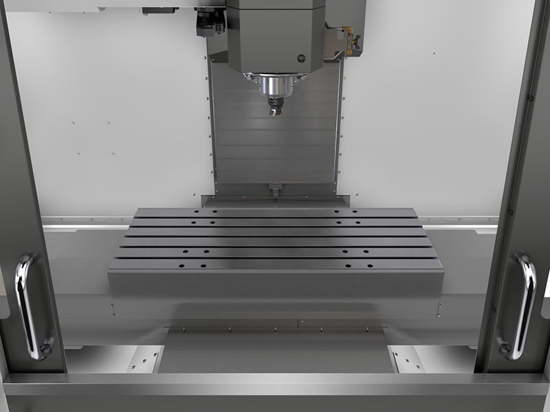

    Table S.A.E METRIC
    Length 48.0 in 1219 mm
    Width 18.0 in 457 mm
    T-Slot Width 0.626 in to 0.630 in 15.90 mm to 16.00 mm
    T-Slot Center Distance 3.15 in 80 mm
    Number of Std T-Slots 5 5
    Max Weight on Table (evenly distributed) 3500 lb 1588 kg

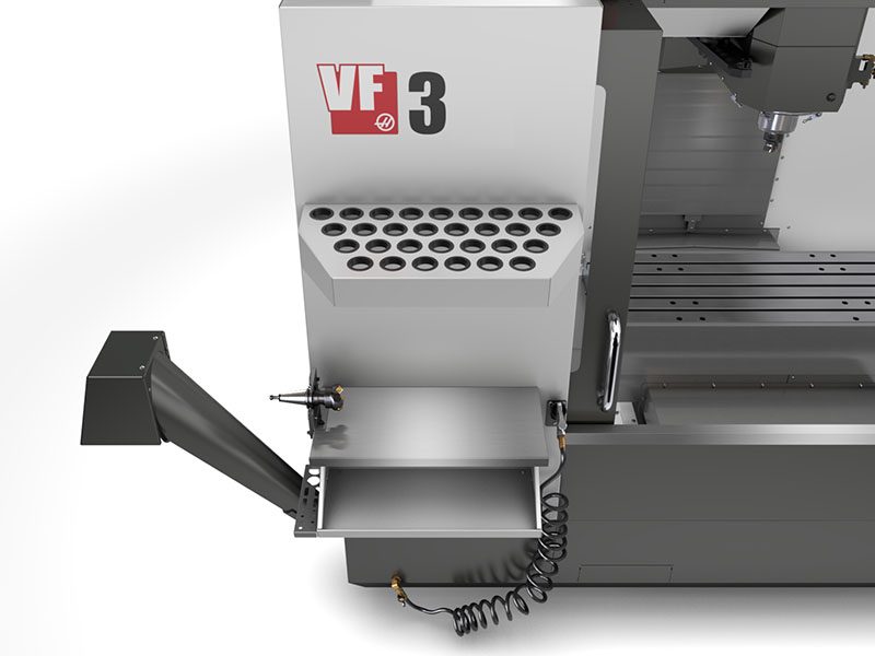

    Tool Changer S.A.E METRIC
    Type Carousel Carousel
    Capacity 20 20
    Max Tool Diameter (full)** 3.5 in 89 mm
    Max Tool Weight 12.0 lb 5.4 kg
    Tool-to-Tool (avg) 4.20 s 4.20 s
    Chip-to-Chip (avg) 4.50 s 4.50 s

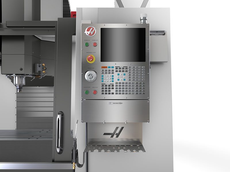

    • Control Widescreen Monitor
    • Ethernet Interface
    • WiFi Connection for the Haas Control
